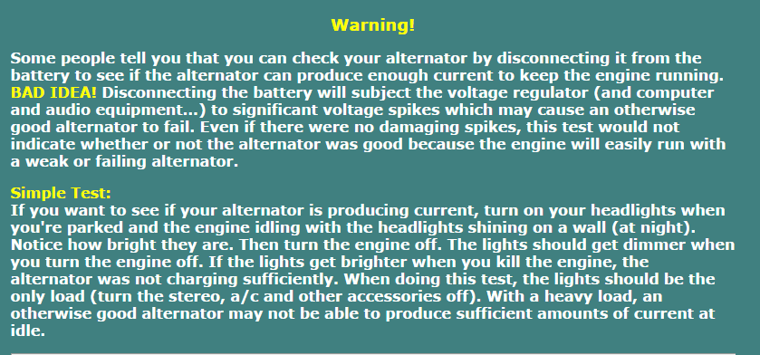

Charging System Basics

doing this on a 1950 car can and will fry the alt.
so in saying that..................
DONT DO IT.
and can damage...
dist.
coil
module
and...
ecm. / prom chip.
