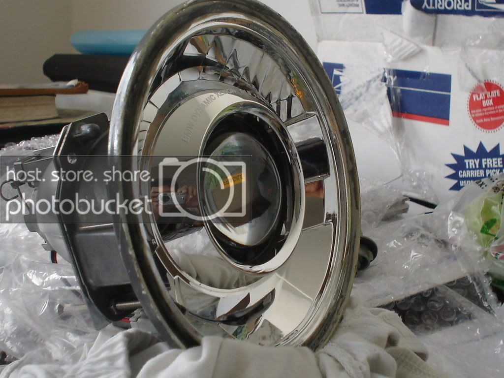

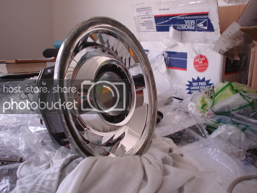

I did a retrofit to my SUV..
Car: 1986 Mitsubishi Montero
Projectors: TL/ZKW ($700)
Xenon: Hella d2s 4100K ($280)
Retrofit:

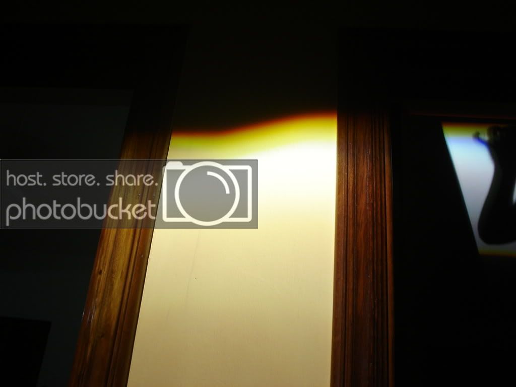

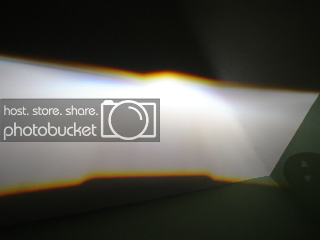

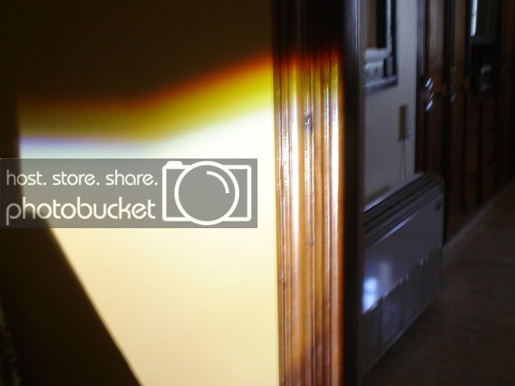

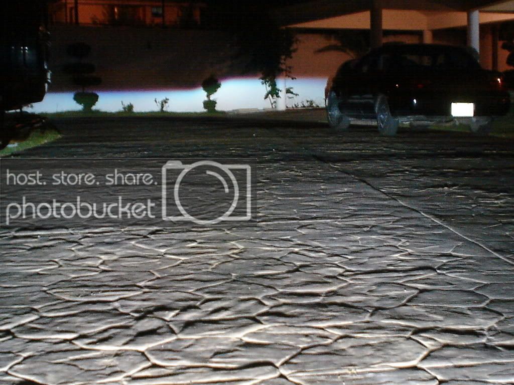

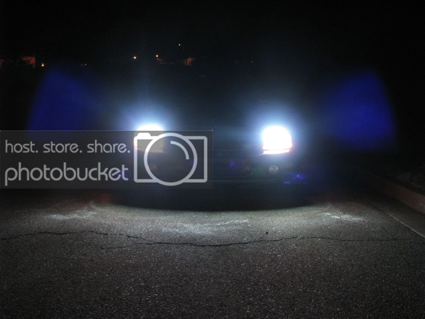

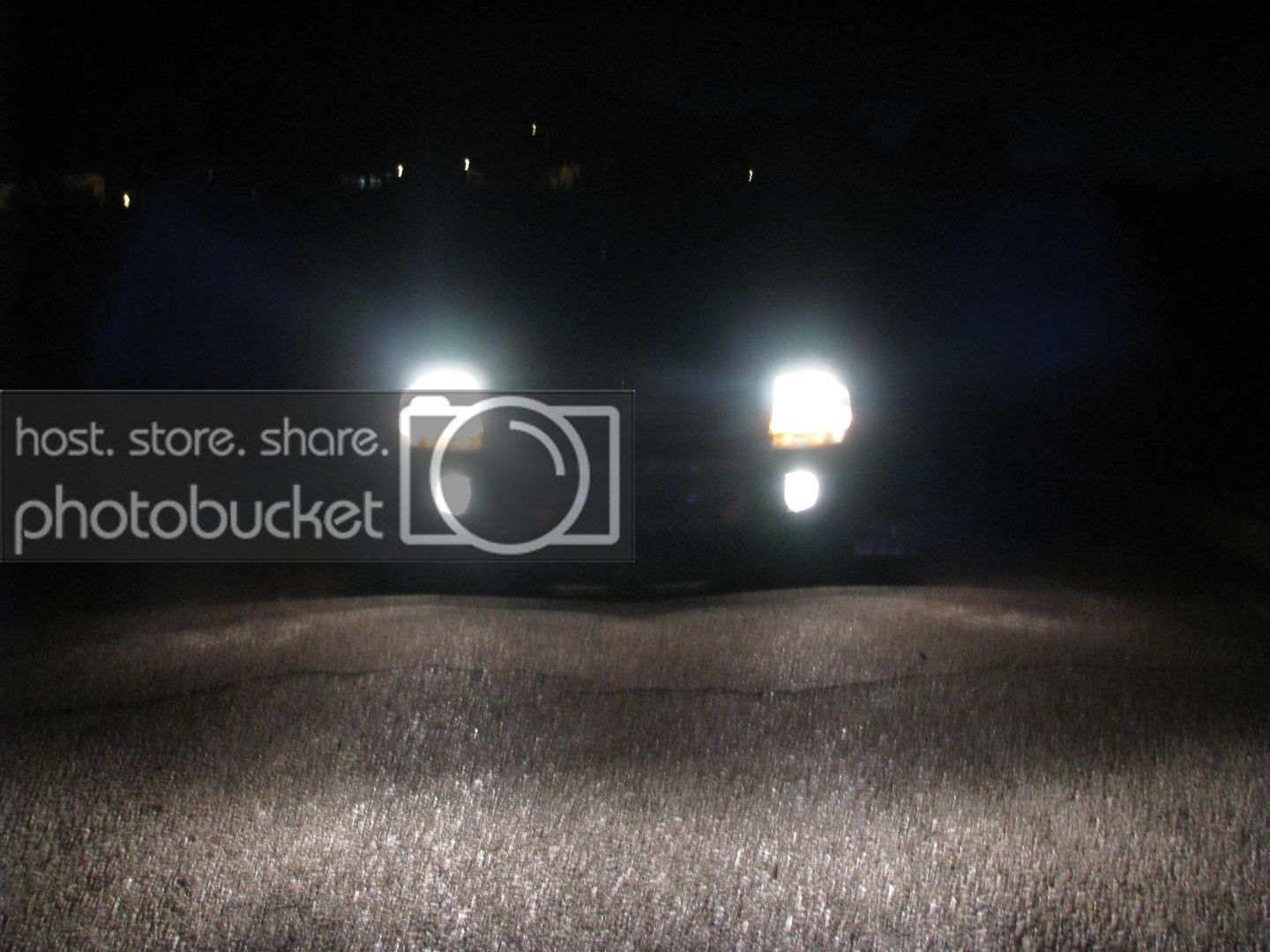

Testing Inside Home //content.invisioncic.com/y282845/emoticons/biggrin.gif.d71a5d36fcbab170f2364c9f2e3946cb.gif :

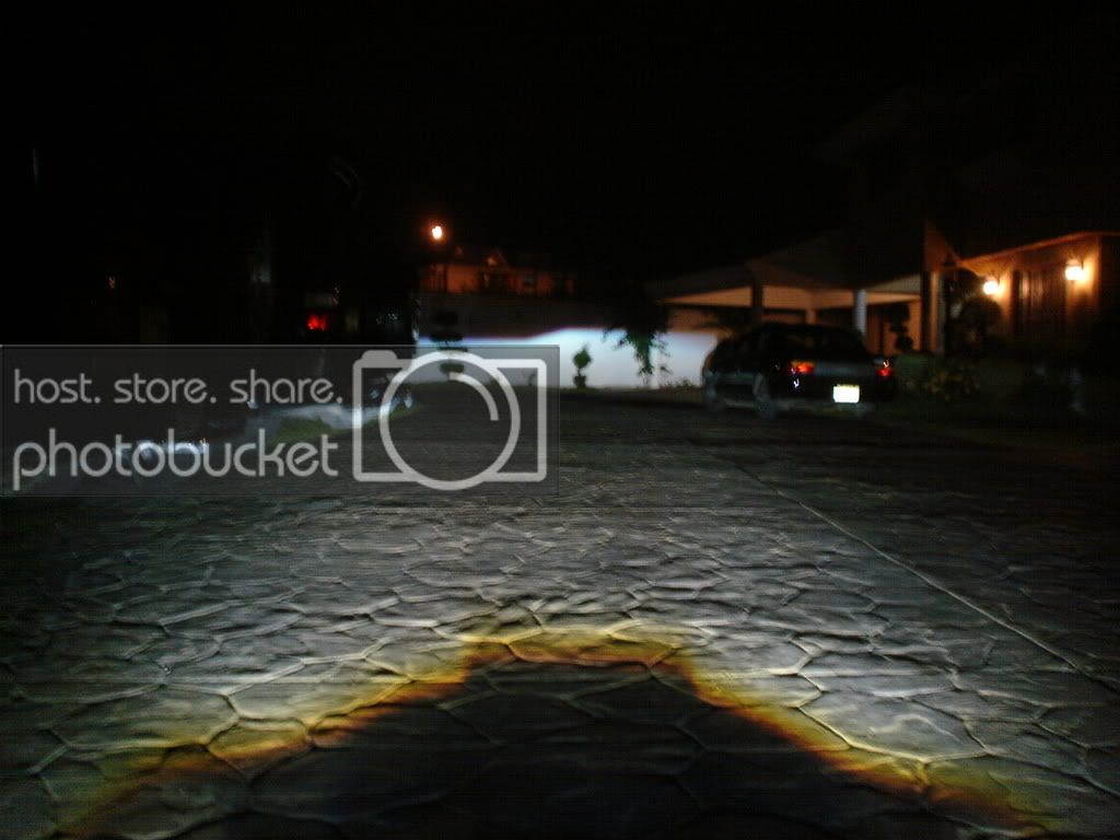

Testing Outside:
