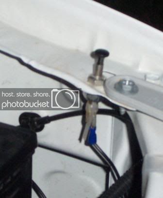

Yeah, it's easy your grey wire is for hood or trunk sence. Most cars are going to have a postive hood and trunk switch. You can go buy a hood pin or you can use a relay to reverise the polarity. You will need to to have a seprate output wire inorder for this to work. You don't have to hook it up if you dont want to. If installed and someone opens you trunk or hood it will set the alarm off.

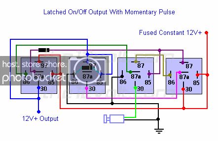

Now for the dark blue wire it is your aux output wire so you can set you train horns off. Are you looking to make the hors go off constantly or just burp it?
If you are wanting to make the train horn constant when you push the aux button on you remotte then this is how it will have to be wired.
What this will do is when you hit the aux button on the remote it will send a momentary signal to the relay back and make it a constant output. Once you hit the aux button again it will tun it off.

Sorry I got my colors backwards also, aux two works the same way as aux one does. it is a momentary output. If you are wanting to make the horns plast longer you will have to do the momentary to constant output realy bank, you wont have to worry about it staying on . Once you hold down the aux buttom it sends a momentary output to the realy back turning to constant output. If you are still holding the aux button about 2-3 seconds later it will send another momentary signal tuning the relayy bank off, so either way you can controll how long the burst is for.
