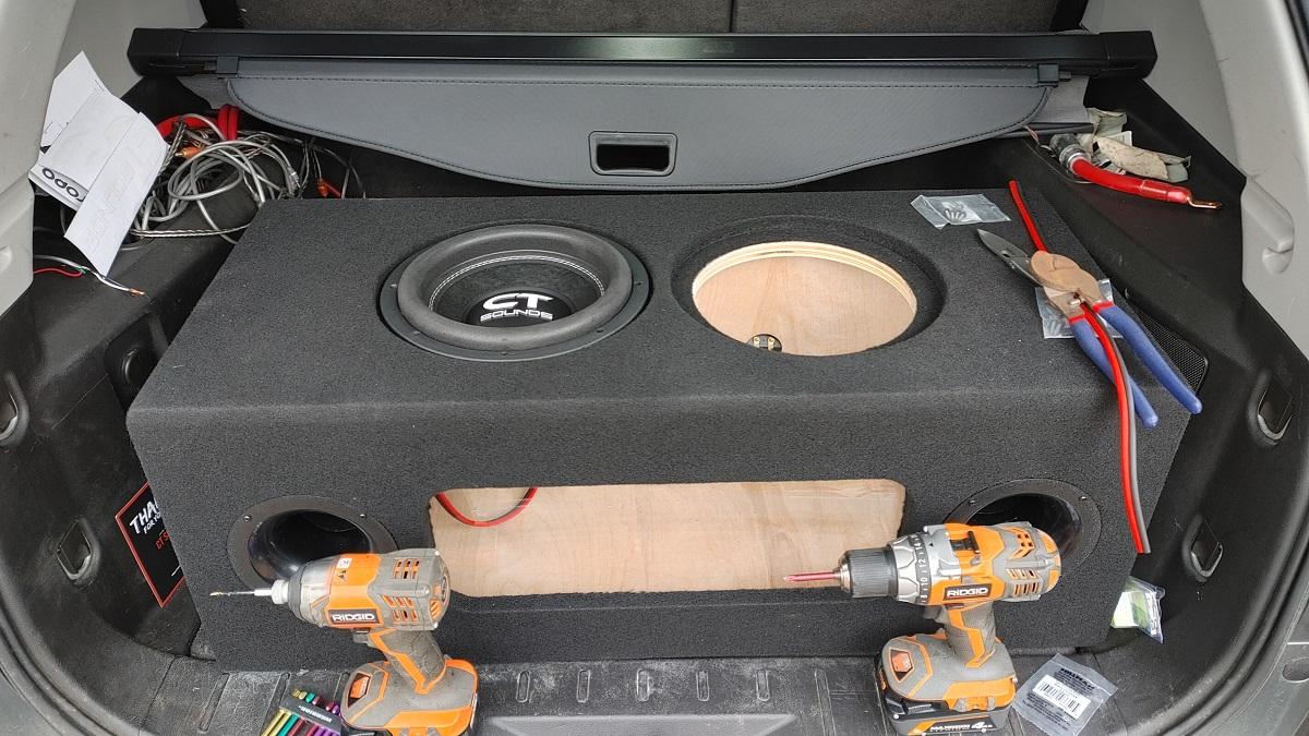

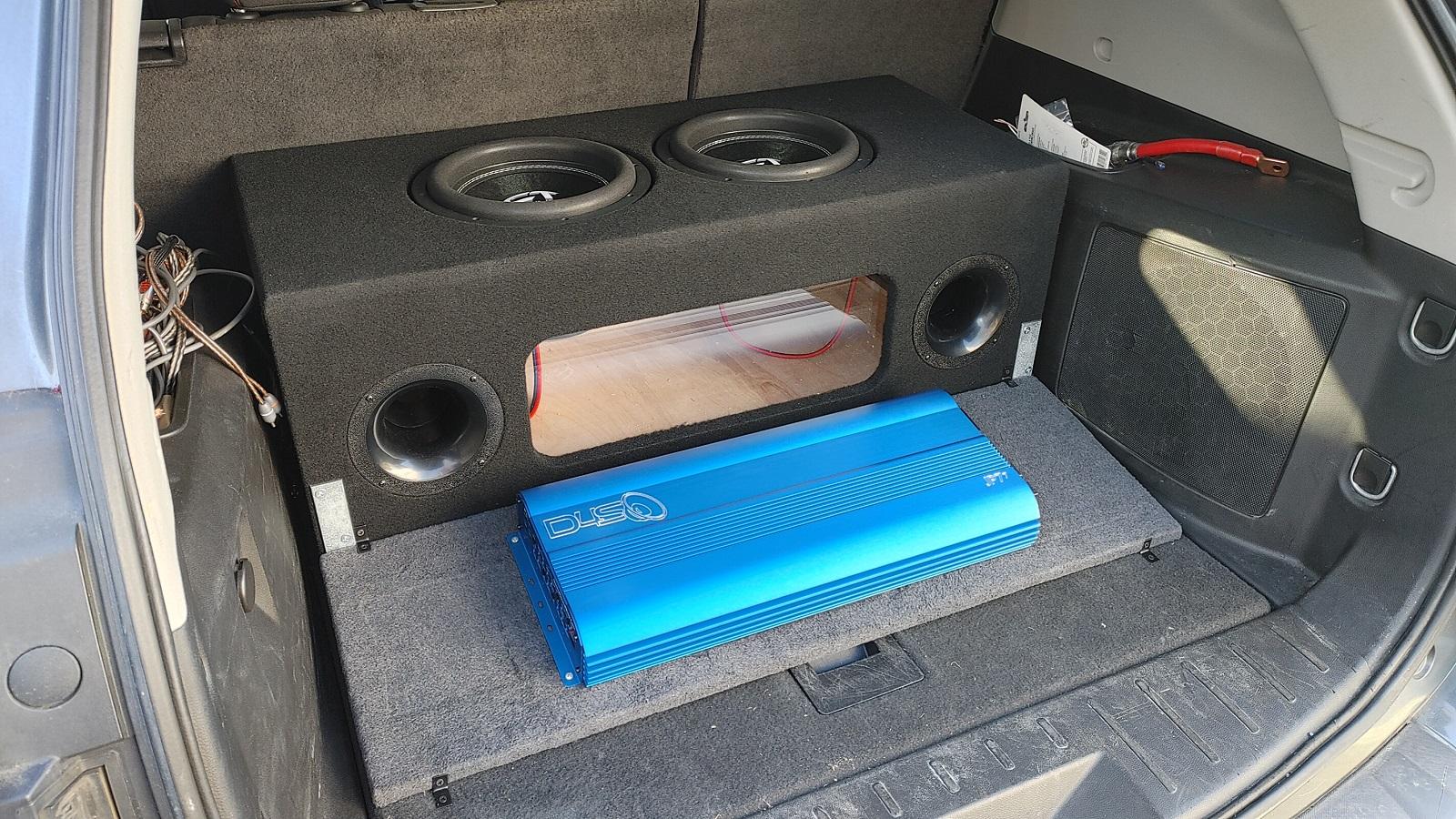

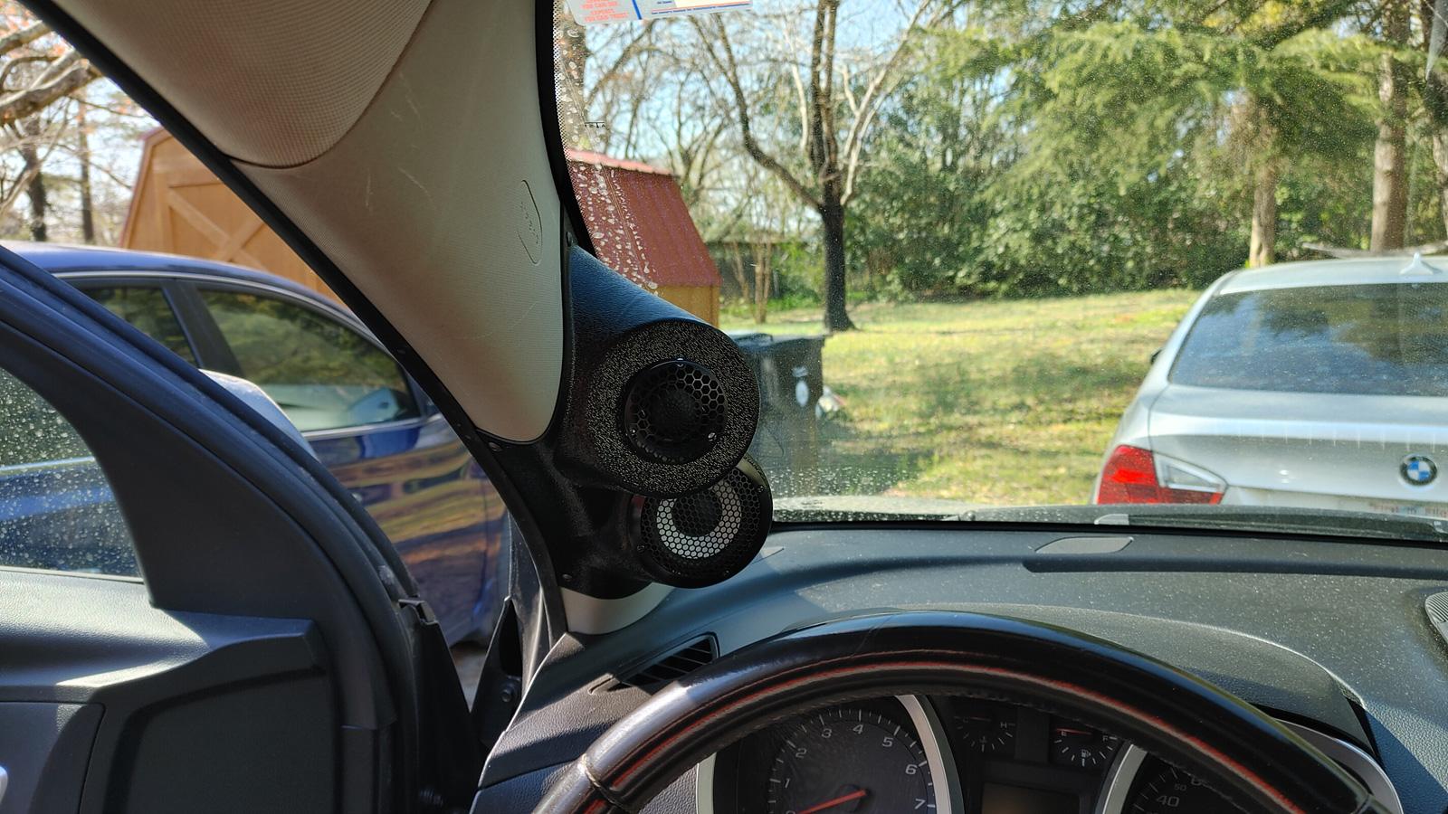

So I bolted the box down. I elevated port side of the enclosure about 3 inches so it is level and used those brackets to hold the enclosure up and a screwin I went. It ain't movin. The amp board is at an angle so I can hide cables and wires. I am going to bracket that to the floor as well in about an hour. The amp is centered and mounted. I am not sure where I want the DSP. Perhaps vertical on the C-Pillar. That will have the BT antenna facing the front of the car unobstructed.
