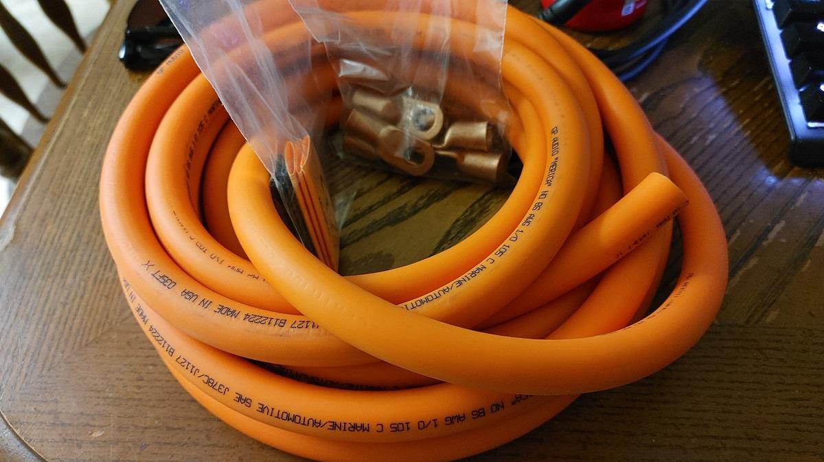

I am settling in a bit. I just ordered 20ft of orange OFC cable for the Equinox. Marine rated, double jacketed. GP car audio. While I was there I ordered a six pack of 1/0 lugs with orange heat shrink also GP car audio. $140 for a single cable run and copper lugs. Gotta start this install somewhere. This will be the main run from the front to the back under the car from the battery to the JP630 lithium bank then split to the amplifiers. Twill be fused at the battery under the hood and just before the JP630 then before each amp appropriately. Inside the cab will be traditional red and black power cables.
