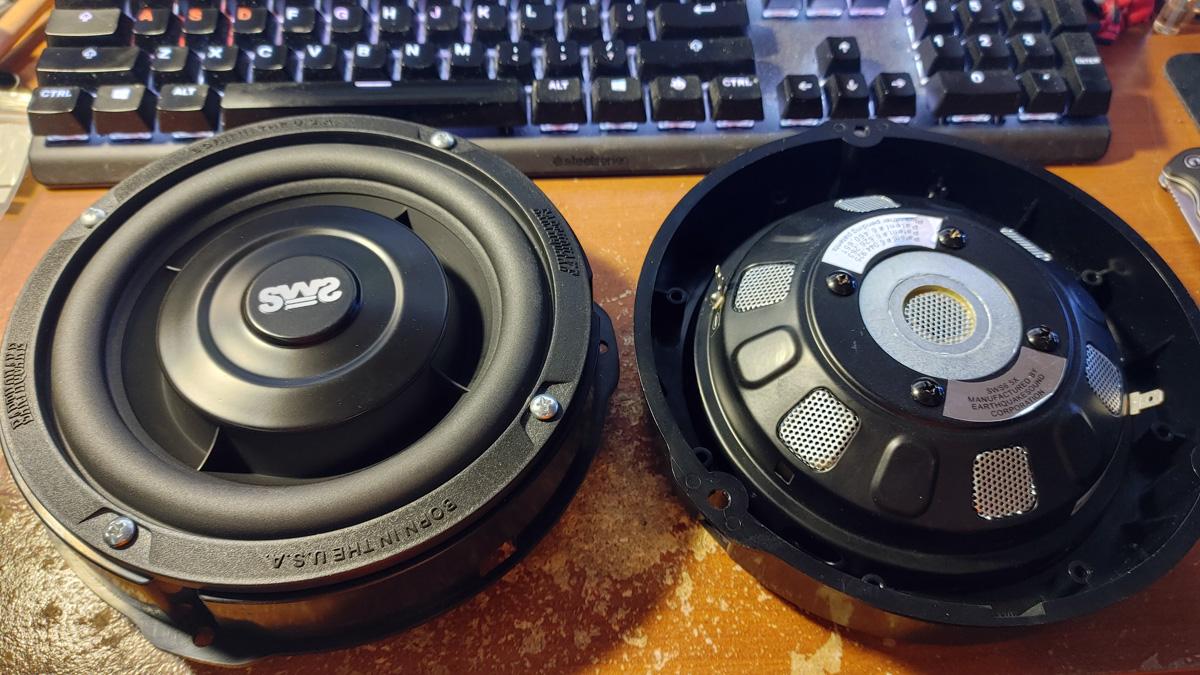

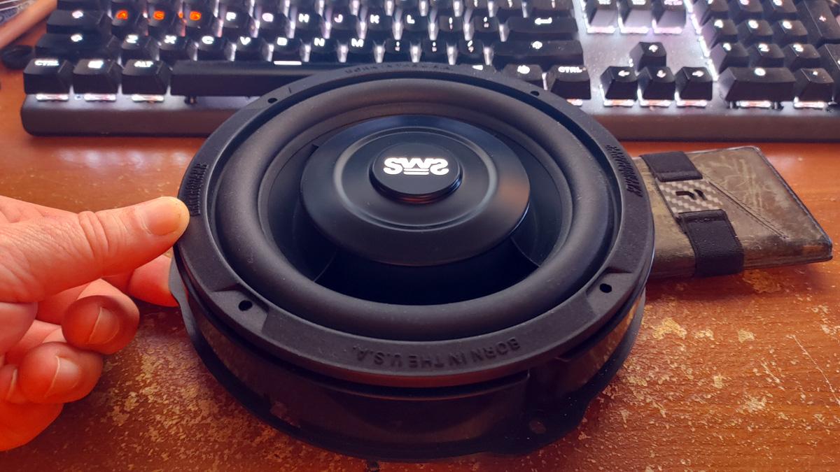

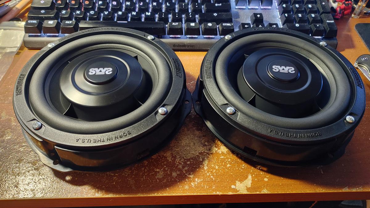

Just spent the last half hour trimming my Metra front door speaker brackets to fit the Earthquake shallow 6'5" subs/mid-bass drivers. Got them to slide in tight and flush in the rings. Next I will get the foam tape to make a gasket for the speaker to mount to on the rings. I think these will do fine for mid-bass in the Equinox. Oh, and mounting screws. Weirdly the speakers did not come with screws.

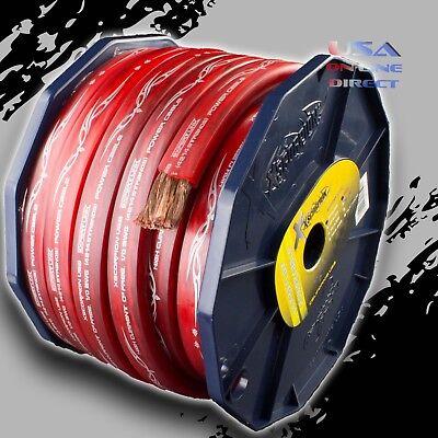

I am currently hunting down the best option for the power cable from the front of the Equinox to the cargo area. Can't decide on brand or size. It will be Tinned OFC because I am running it under the vehicle. I want to use cable intended for car audio use and or marine audio use. I don't want to use welding cable. I can use 1/0awg because the length won't be crazy long. I am estimating 15-18ft max. Power is going to be getting up there I guess. The JP13, RF Punch 500x2 and Punch 400x4. I have the JP630 supercapacitor bank. I will upgrade the alternator and do the big 3-4. What do you think... run some 2/0 tinned ofc front to back? I would like to run an Orange cable. Similar to how hybrid cars high power cables are orange. Of course red and black on the interior of the car. What brand should I go with???
