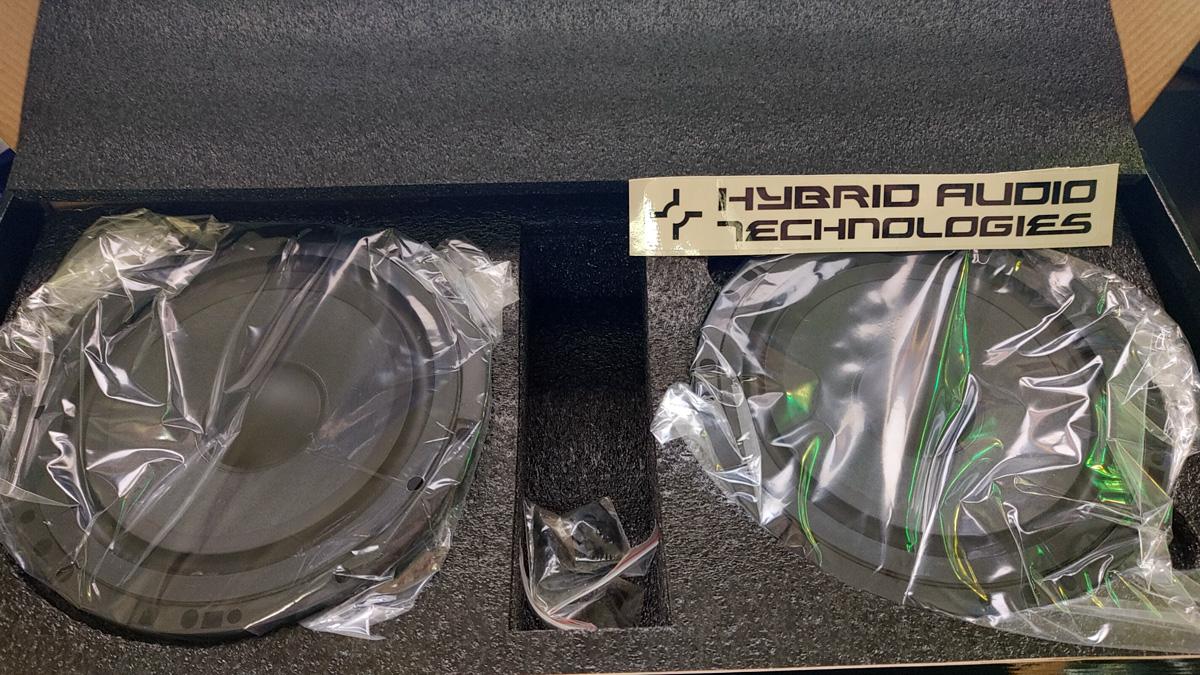

The Shallow Hybrid Audio speakers are HERE!!

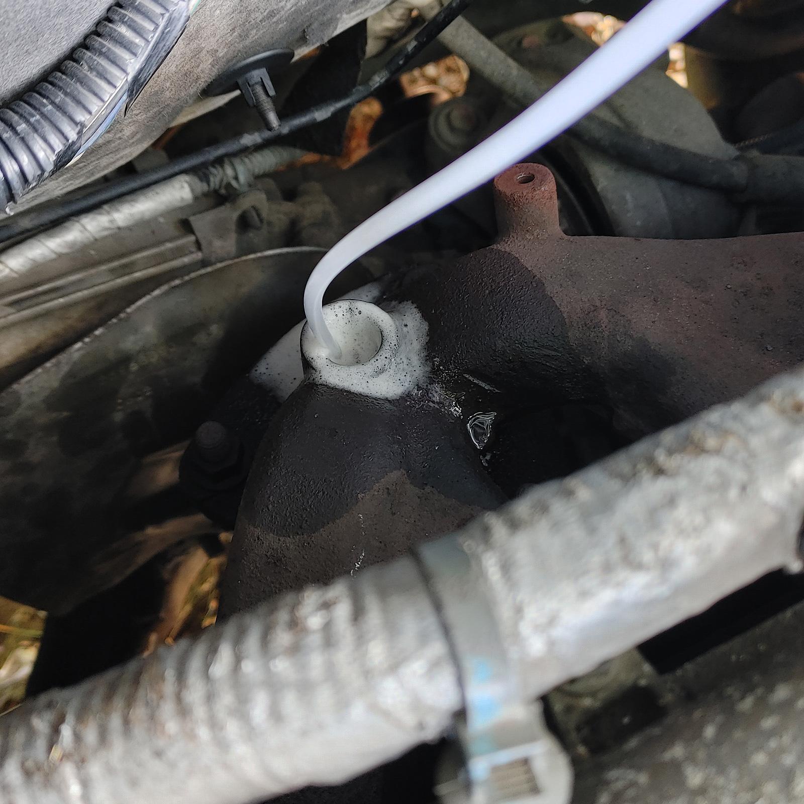

UGGGHHHHH!!!! I bought a new upstream O2 sensor for the 2.4L... It's time for a new one. While I am in there I am going to soak the CAT with a foaming DPF/CAT cleaner. Tore into it today and wouldn't you know it, the O2 sensor will not budge. SO, on my next day off I am heading to the storage unit where my tools are, busting out my cordless 1/2" impact and I am going to get that prick out. I used heat and a breaker bar. The sensor is oriented vertically so it is not hard to get to and it is directly mounted into the top of the cat. The downstream was cake. Smooth out, smooth in.
What a damn struggle!! I used my 1/2" impact gun... didn't help. I bought deep impact sockets. Apparently that just means they are long sockets but on the inside halfway up the wall narrow so they were of NO USE. I removed the heat shield to gain full access to the O2 sensor. Even with the impact, the sockets just spun and spun. I was frustrated to no end. So just to enrage myself more I put the offset sockets on it with a 3" extension and the 3/8 ratchet and gave her a lil push. It friggin moved. So I soaked the piss out of it with more PB and worked the sensor back and forth a few times. One more squirt and out she came.
I discovered the last owner had an incorrect O2 sensor put in. They used a Bosh 15128 indicated by the light gray sleeve on the wires and the holes only in the tip. I used the OE Denso 234-4242. This has perforations around the entire tip cylinder. Once the sensor was out I sprayed the DPF/CAT cleaning foam into the hole on top of the catalytic converter core. I used the entire can and let it sit for the recommended 25min.
Once time was up I cleaned up the hole, used some petroleum jelly to lube the threads and in went the sensor. Reassembled the car and drove it for 1 hour. 40min was recommended. Took about 10 minutes to fully clear everything out and I can feel a slight difference in the pedal for the better and the engine is smoother. Could be the cleaner, could be the correct OE oxygen sensor, could be a combo of both but I am pleased for sure.
