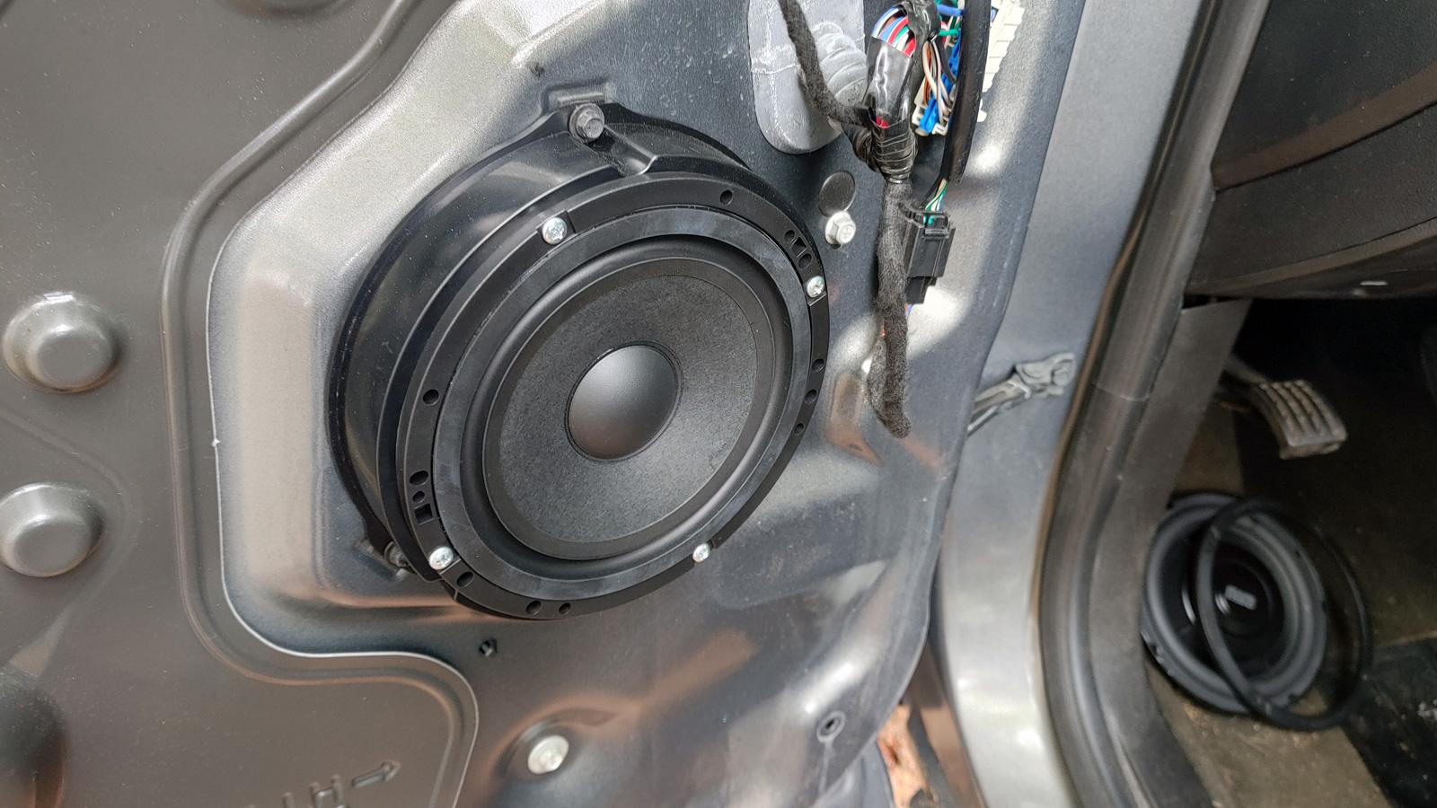

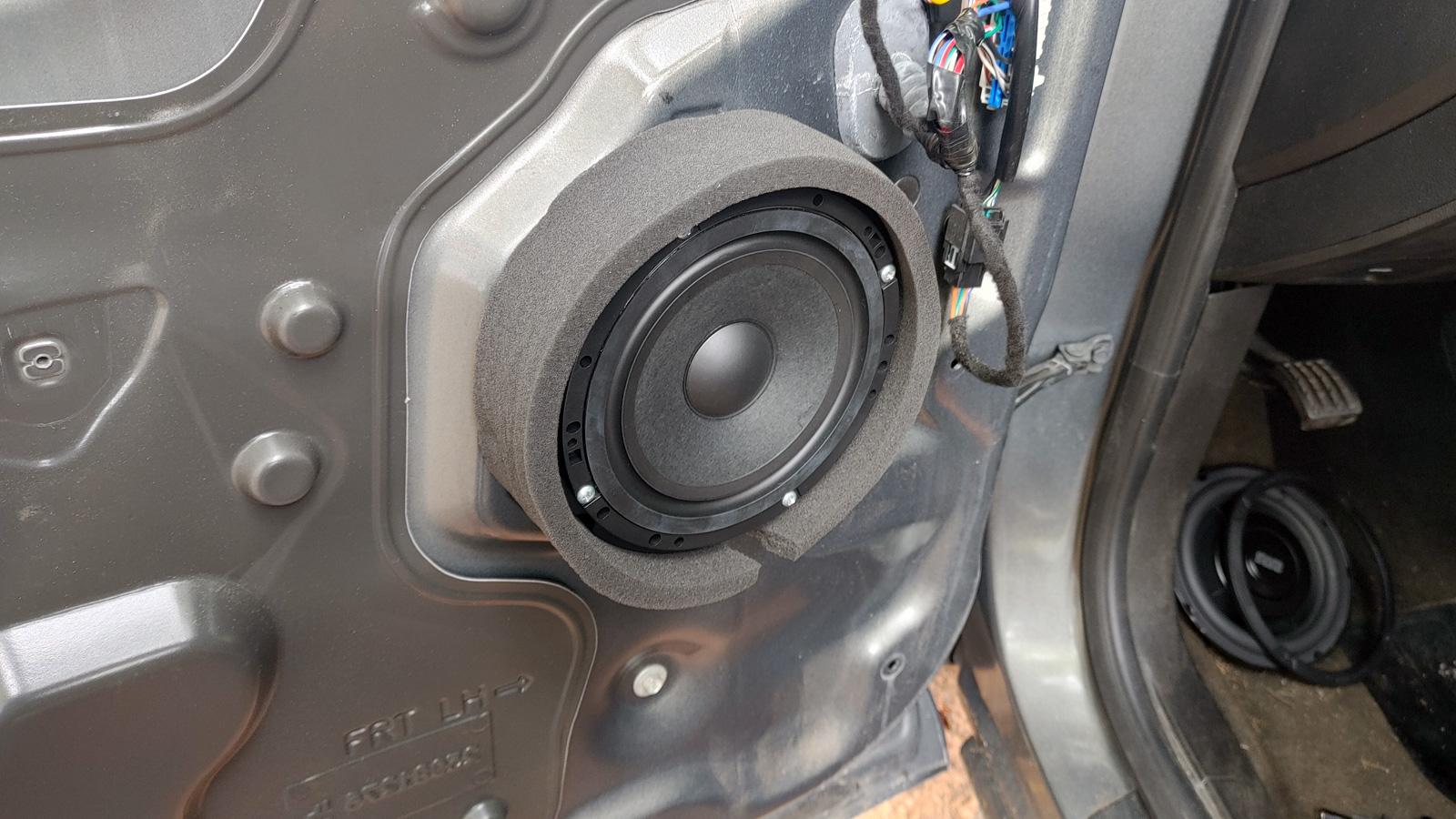

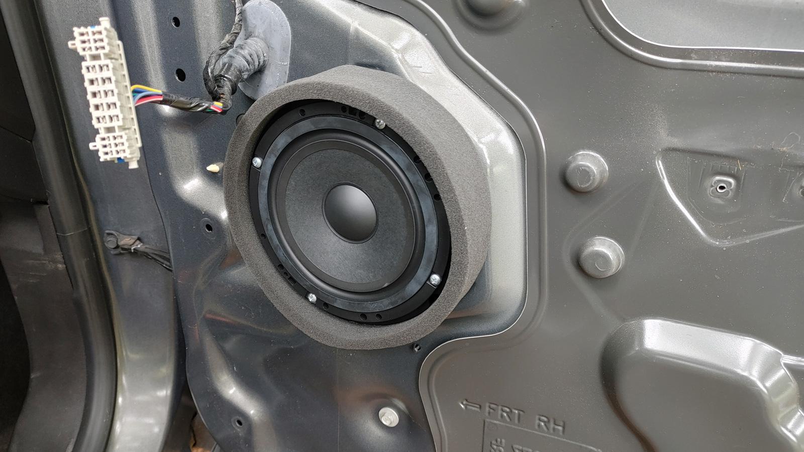

It's cool day and I am tired of the Earthquakes buzzing against the door panels. Out with the EQ's in with the Hybrid Audio

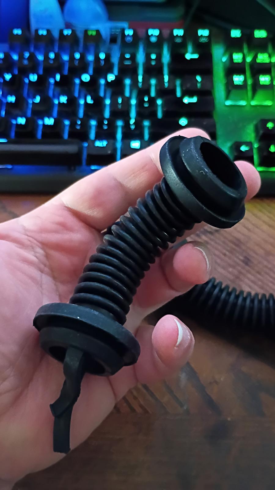

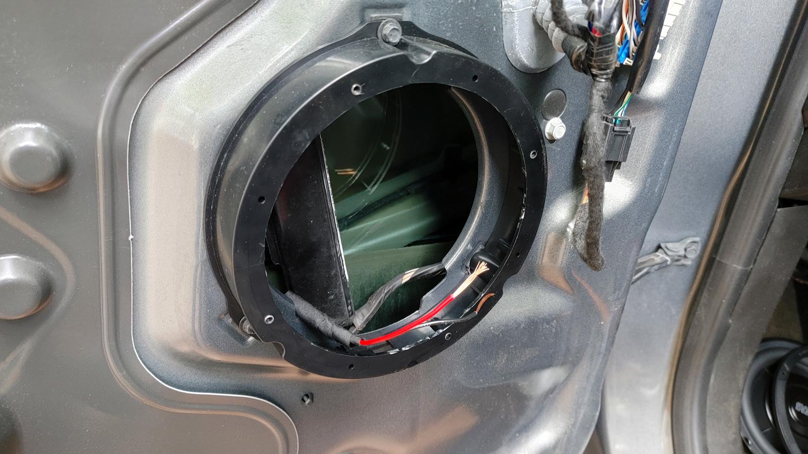

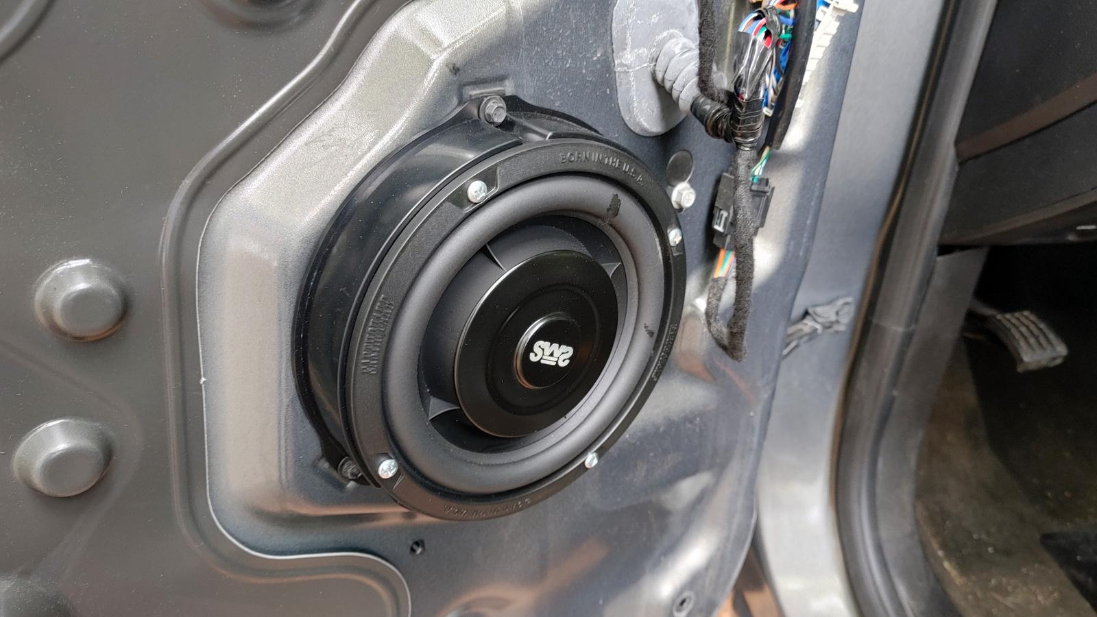

I didn't even know this was a thing the public could buy. Being that I am going to have to drill my doors and door sills to run the wire from the amp to the door speakers these will look factory AF!!!
These are really handy. They've been around since I started installing, back in 1997. They were highly necessary when working on old cars that don't have wires in the doors. I mostly used the ones designed for a Civic or Ranger.

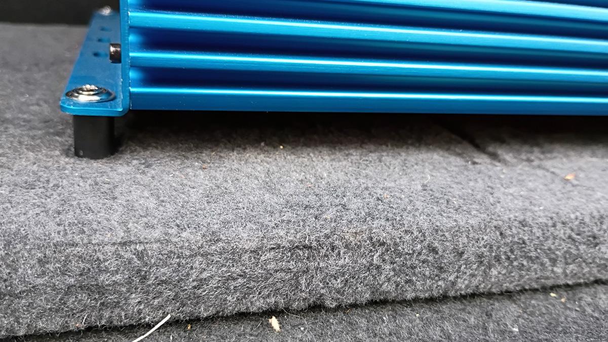

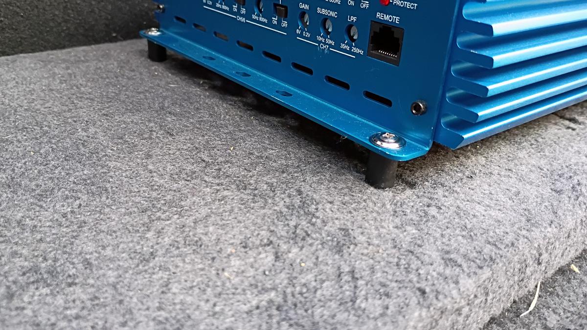

D4S's videos about amplifiers over heating when installed and what caused the issues made me order some plastic risers a while back and purchase 4 special screws. Well, it's not much but I had time before work today to install the amp risers and new screws. Now there is plenty of space for the bottom mounted fans on the amp to draw in air.
I pulled out one of my rolls of speaker wire and cut it in half. I think I have misplaced some speaker wire because I know I ordered enough for three runs on each side of the Equinox. T - M - MB. Right now I have the wire for the Mid-Bass. I also seem to have misplaced the black carpet for the upper board that will hold the cap bank, fused distribution block... and the DSP. I am forcing myself to finish this damn install. I need some bass. People keep asking me what my license plate means. When I tell them they say OOOHHHH LET ME HEAR IT!! 😬
