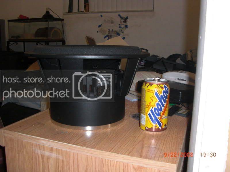

A picture of the P3 vs Yoohoo can. This might not be big for some of you, but I'm used to really crap systems. So, I was pretty stoked to be able to get the opportunity to work with with a magnet that size. o_o It's just a shame it won't be put up to it's full potential.

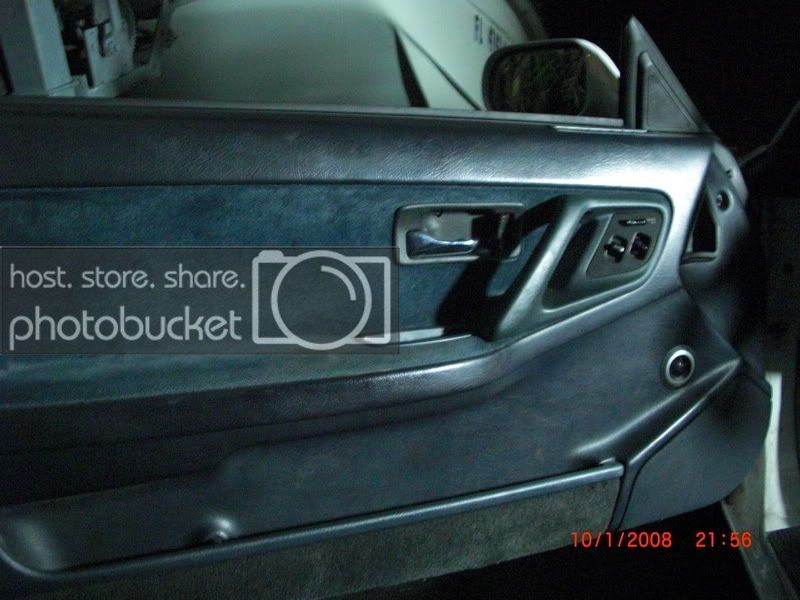

Doors with tweets installed. I think it looks great:

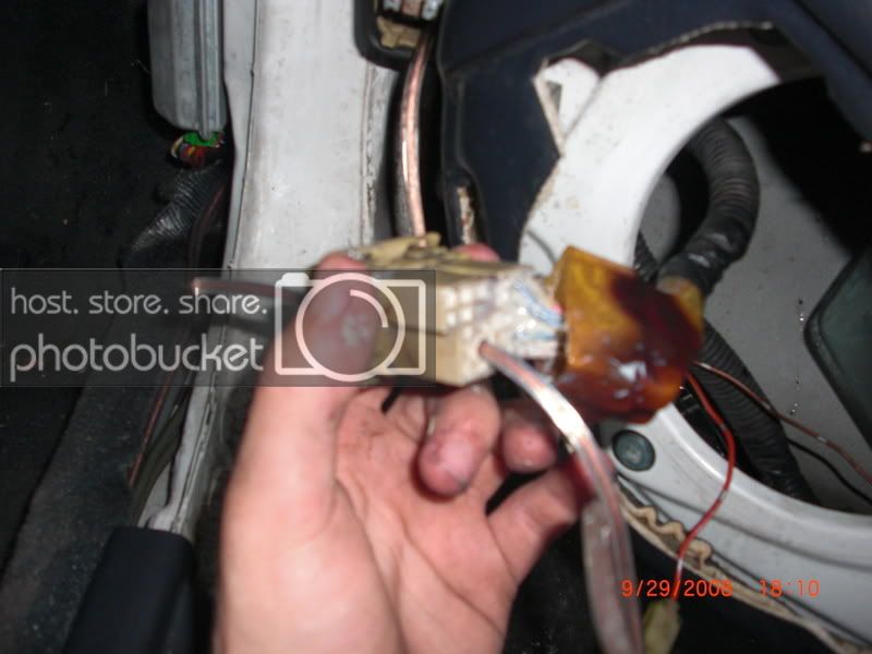

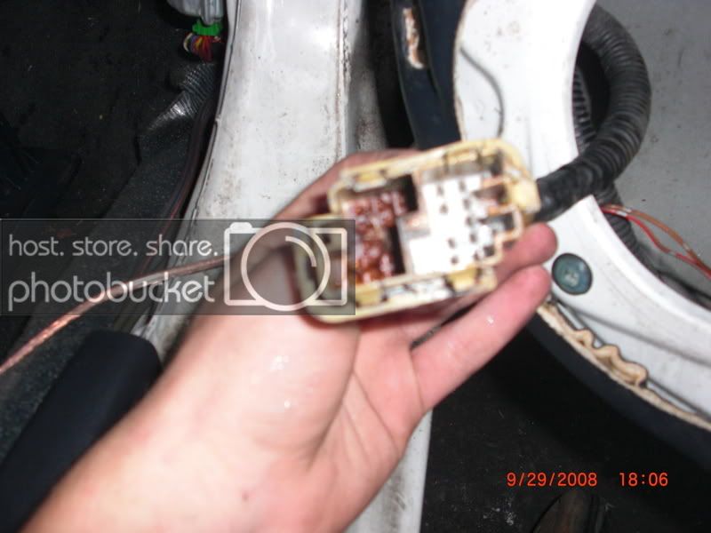

I ran into a problem when trying to wire the speakers. Unlike most cars, the Integra has a Molex-style plug where the wires run through instead of just a through grommet. Don't ask me why. I don't know. But, to fix it, just need a screw driver, a rag, and a drill.
Here's what it should look like in case anyone has to work on an Integra soon:
The molex plug has two sections, basically. The top section doesn't have any wires running through it. Pick the appropriate drill size, and drill through. I was trying to find a walk through online, but no one had decent information. On one site, someone said to be careful. But, I saw no need to.
NOTE: You can also just use a screw driver and hammer it through the top since it's pointless...
Or you can do it the "proper way" and get some female/male connectors for each side of the plug... again, I saw this pointless. No use doing that much work on my ex's POS car.

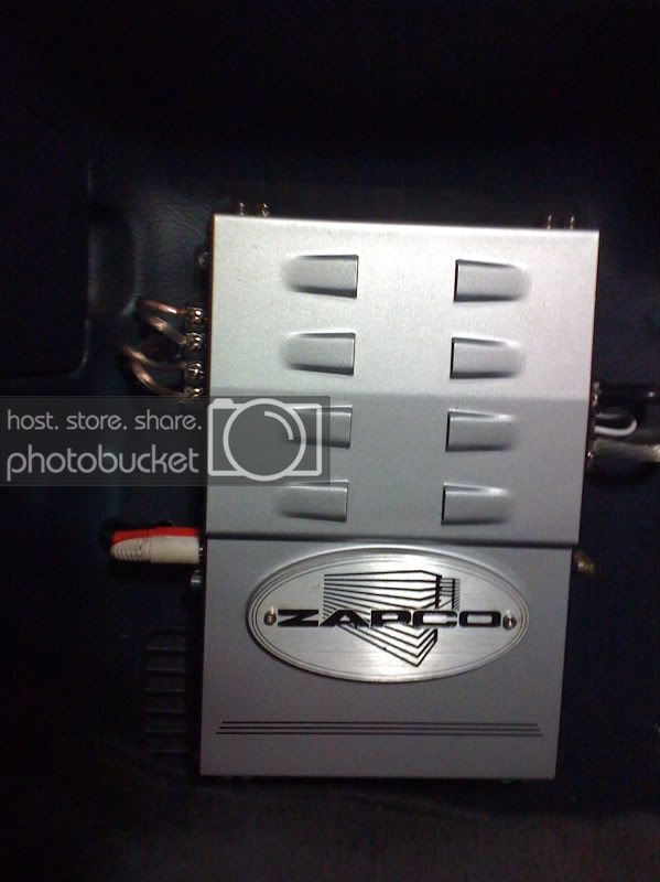

Here's the Zapco iForce i-250 mounted up all nice and snug in the driver's side recess in the trunk. I'll snap a new shot in the light. I think it looks clean.

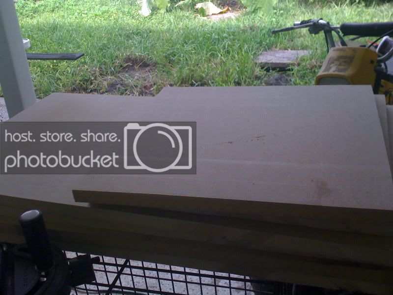

This is the only pieces of wood I actually took pictures of:
In retrospect, I don't know what side that is...

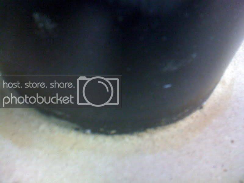

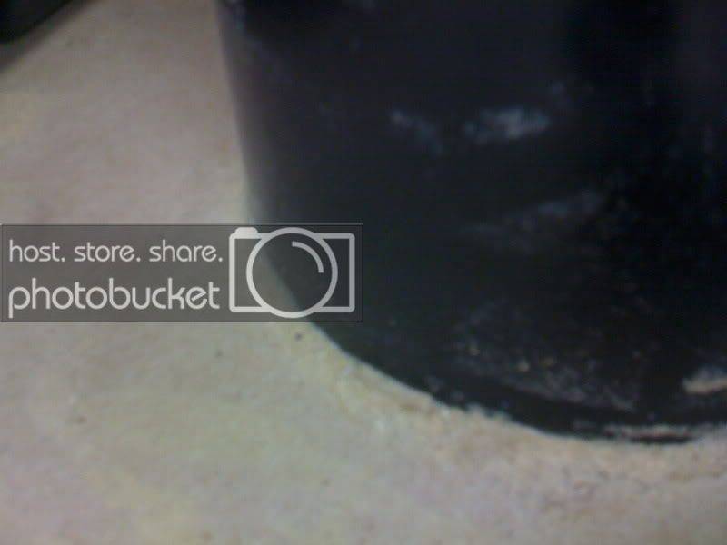

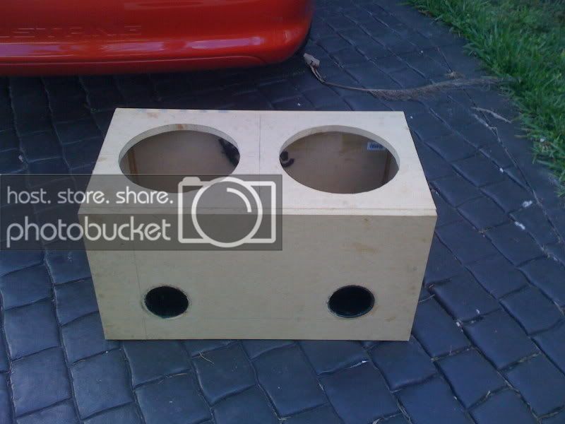

Now, I don't have a picture of the front / top, but I had to use an air-saw. Arguably the red-headed step-child of air and saw tools. It's much like a jig-saw, and in theory is better than a jigsaw... except the blade ends way too early, and it doesn't really have anything you can push against to ensure a straight cut. So, the blade bends a lot, causing all weird angles in the cuts. With that being said, the holes for the subs and the holes for the PVC were all messed up angles. I decided to use some home-made wood filler. (AKA, wood dust and wood glue. I'm not sure how well this stuff actually works, but it makes it look nice. I added a nice bead of silicone ontop.
The outcome:
It came out good, I think.

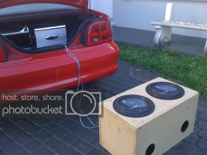

But here's some pics outside:

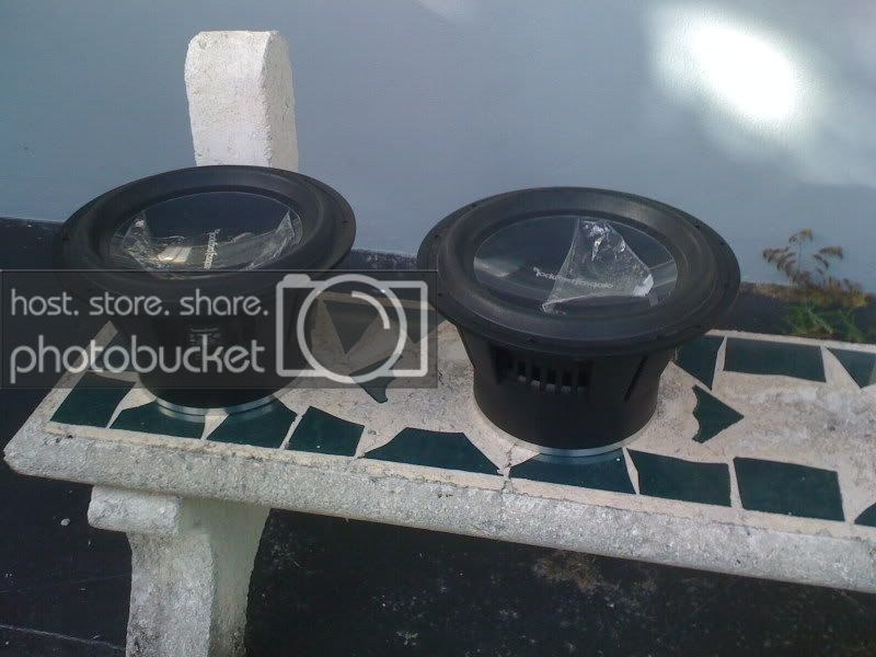

Subs sitting on a bench outside. The back part fell during a hurricane and it's just too heavy to move. I plan on taking a sledgehammer to it one day. Vids will be posted:
Box:
Ghetto-rigged:
Final conclusion:
These P3's hit hard with only 600 watts. However, I didn't turn up the volume too much, nor did I even screw them in yet. But, as it were, they had a slow response. This could be the design/construction of the box (it was half assed, honestly), or the subs themselves. However, they are pretty loud outside of a car. I'll post more info when I test it in her car.

Yea, all the Hondas and Acuras have the plugs. Would have been easier to just splice into the stock wire up in the dash. When I did the components in my Civic, I had to drop the doors and drill holes.

And I just didn't feel like splicing, soldering, etc. I decided to go the brute way and just pry the damn thing off and drill through it.
I wasn't able to do that in the Civic.. The door didn't open enough to get the plug out. Dropping the door was the only option.

But, the Integra's doors were tough to open enough. Hence why I used a really long screw driver. Once it popped out, drilling was easy.
