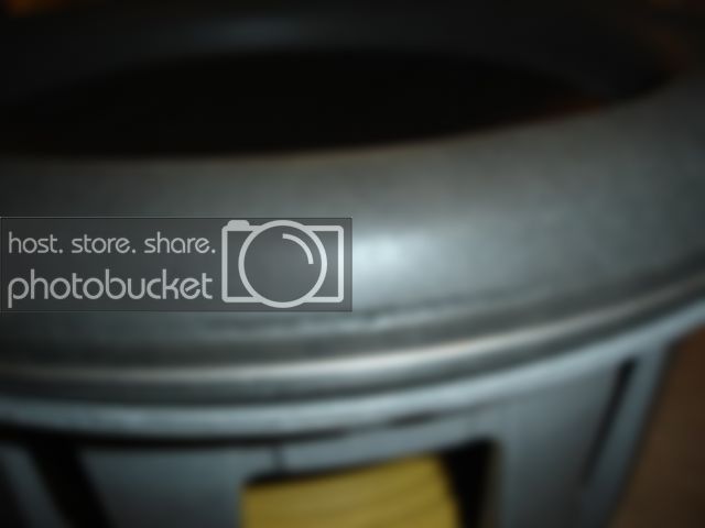

There is a 1.5" or so tear in the surround as mentioned in the auction, but I think it's fixable:

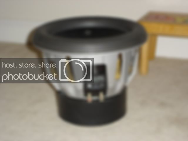

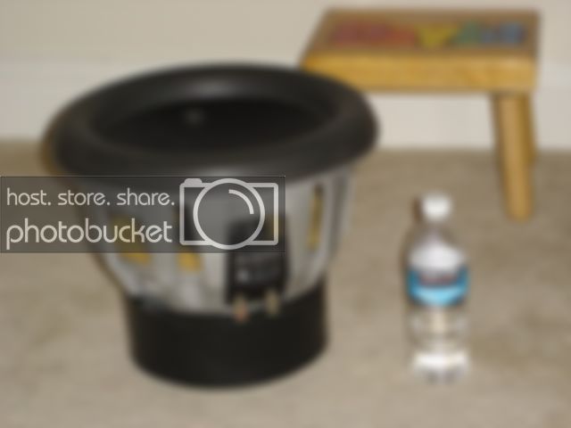

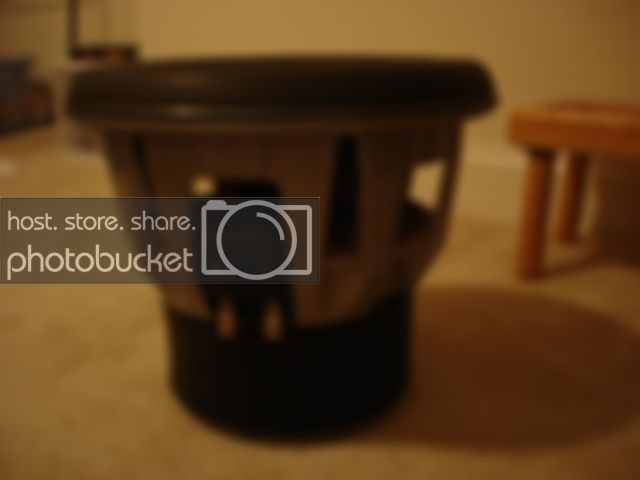

A couple more shots:

just grab a 9V battery or a 12v cordless drill batter and touch the connections... if the coils are good the sub will move in or out. Also, who cares about the tear... it will have absolutely no effect on the spl our sq of the sub whatsoever. Just run across the tear with a light coat of ca glue or silicone to keep it from tearing further. Awesome buy!

If you use a CA glue, make sure that it won't eat the surround. I've experimented with CA glue (that I use for balsa planes) on foams, and you don't want to make it worse.

The foam on the 13W7 is much tougher than most foam surrounds (can barely tear it by hand) and the surround is attached to the cone of the W7 with CA, so I'm sure he will be fine. The only thing I would worry about is the fact that the tear is right where the ring goes, so if possible I would try to repair it from the back side //content.invisioncic.com/y282845/emoticons/wink.gif.608e3ea05f1a9f98611af0861652f8fb.gif
