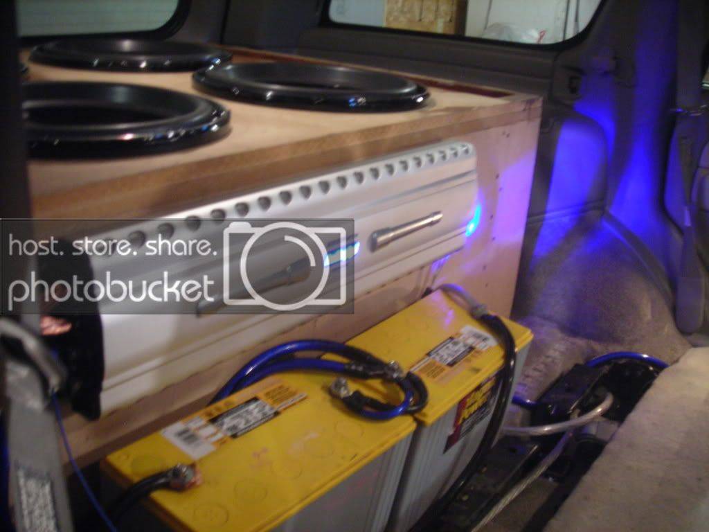

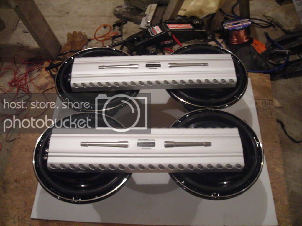

Yeah the GD6001 will do around 3kw at .5ohms all day long and its rated at 2000x1 at 1ohm, I ran two of them, and then Two of the AP30001s and they hand the kx/zx2500.1 there *** for alot cheaper, and in my mind very sexy amps!!
Couple pics from the my Tahoe!!

The SEXY

Did you ever have any problems with those going into protect and what fixed it?
No never anyproblems with either line of amps, and the GD6001s we strapped at .5ohms for fun .25ohms each amp, and they played music in my tahoe dippin in the low 12 volt range for around 30 sec R/T Pimp was there for that one it was at his house..lol.. the audiopipe amps are a d*mn tank you cant beat them for the price, the GD6001s at .5ohm daily got a lil warm, but that was on a 3 hour drive to sound comps playing none stopped hard playing and still did 150+db tuned to 28hz so not bad, never had a problem with either line, im actually not sure what to do i really like the AP30001ds but i got a deal with MTX so gunna do that, but these amps are monsters and for the price you 100% wont beat them!
