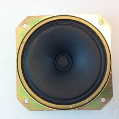

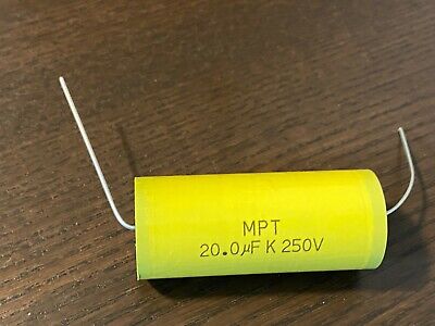

Here you go. All you need is a speaker and a tweeter capacitor.

Here is a relatively inexpensive tweeter/cap/oscilloscope combo should anyone want to give it a try
