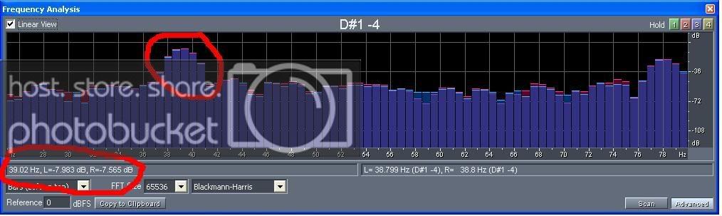

ive been using -6db test tones for forever with rap and reggae as my main music of choice. ive seen a few rap songs that never went above -8db and in that general range. you will be fine. jmacs tutorial was more so designed for safety than performance.
heres an example.lets take one of ca.com's more famous tracks. young jeezy - hypnotize.
see the top red circle? thats basically showing the peak bass frequency in the song. it is around the 39hz mark. now take a look @ the lower red circle. as you can see it says 39hz but now take a look at what the level of the recording is. it is more than -7db's (almost -8db). and thats the PEAK for the bass line
