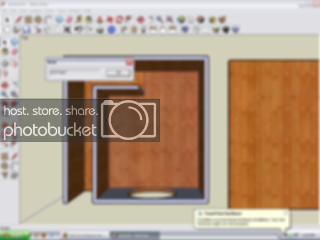

Let me start over, since I realize all these free enclosure calculators are WAY off.
I will be running a 15" Fi Q on a 1200wrms in my trunk car, with sub facing UP and Port Backwards. I want 4.0 cubic feet after port and sub disp, tuned to 32hz w/ 65sq" of port.
I want the box to be 30" long and 14" high, my max width is 30" though.
Here is what I came up with so far, but I cannot figure out the second port length for the correct tuning.
External Dims: 24"w x 30"d x 14"h
Internal Dims (using .75" wood) : 22.5w x 28.5d x 12.5h
Internal Volume includ. port disp = 4.638
Port 1 = 5.25" w x 12.5" h x 24" d
Port 1 disp = 0.9 cu ft
Port 2 = 5.25" w x 12.5" x ?
And that is where I got stuck.
I need the depth and height to be the same, but the width can be changed around.
If you could help, that would be awesome!
Thanks man!
And no, obviously you can't find the port length using sketchup. But once you find the port length 99% of the rest of it sketchup can handle. Cut out sheet, actual port length on the 3d model, area of the box etc..
Actually the box i made you should work out perfect, it's less than 30inches wide, and has your requested tuning/port area.
It's actually 3.81cf net after port and sub displacement. I forgot to add in the sub displacement to the box. As you can see here, the internal volume minus the port is exactly 4.01cf.
