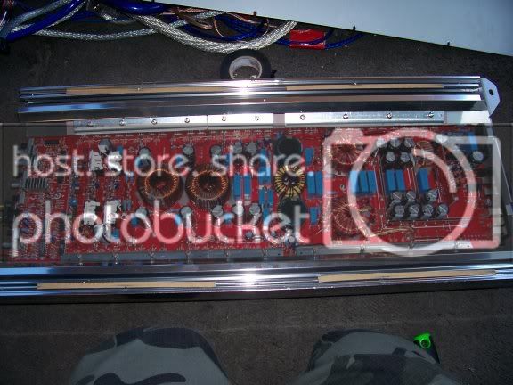

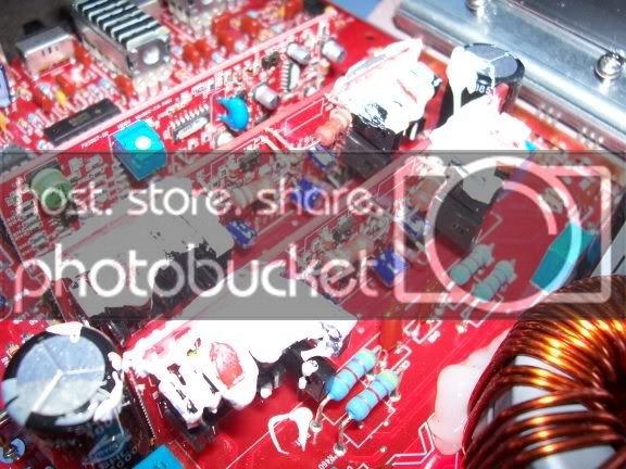

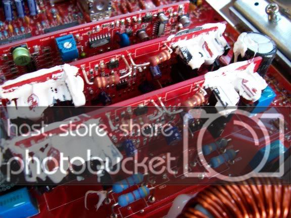

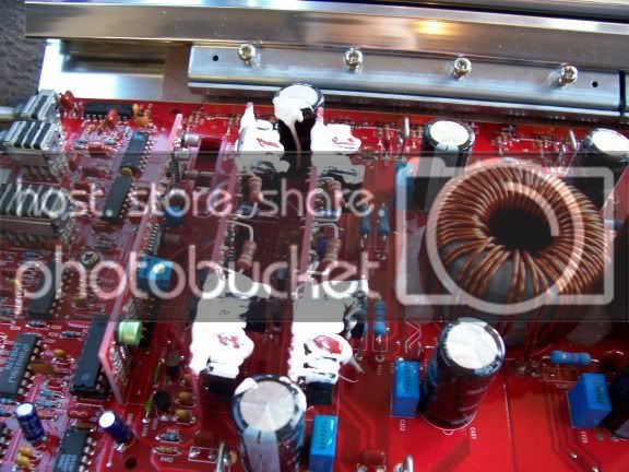

Oh, and here's some pics of the amp, I swear it's completely fine...
I was told the white shit on the circuit boards is normal and it keeps corrosion down. Nothing has popped or exploded it all seems to be fine. so wtf?
