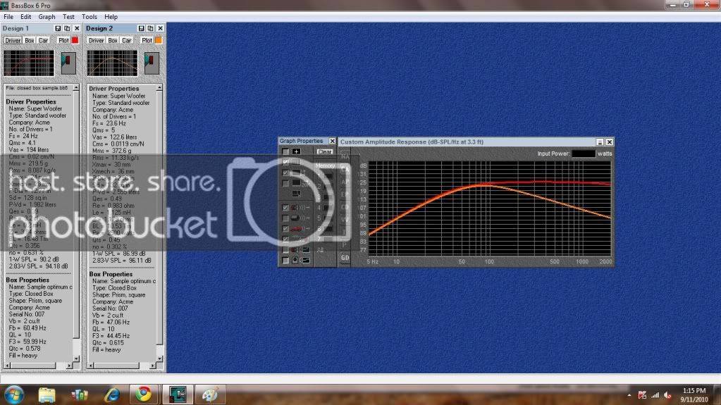

after modeling up there going to be nearly identical with the AE having about .5 output advantage below 45 but the lms can and will handle more power and has more displacment..

I appreciate you going through the trouble of modeling the subs and posting it here. I have a couple of questions.
1.) What size box did you model the subs in on your program?
2.) You said a smaller box would put more emphasis on the upper bass range, that means a higher qtc. So how high of a qtc can a person use before it noticeably affect the woofer's transient response?
1) the first plot is identical to the second i accidentally posted the same one twice,lol..
their both in 2 cubes sealed..

the transient response for both woofers IE its ability to stop when its supposed to stop in its simplest form are going to be pretty similar.. the QTC for the TC is abit closer to critically damped.. this is with max fill and a QL of 10(ie leakage).. ill model them up with a QL of 0(IE no leakage) so you can see the variance..

their both in 2 cubes sealed..the QTC for the TC is abit closer to critically damped.
WINisd and an online qtc calculator showed that the AV would have the lower QTC for any given enclosure volume.
