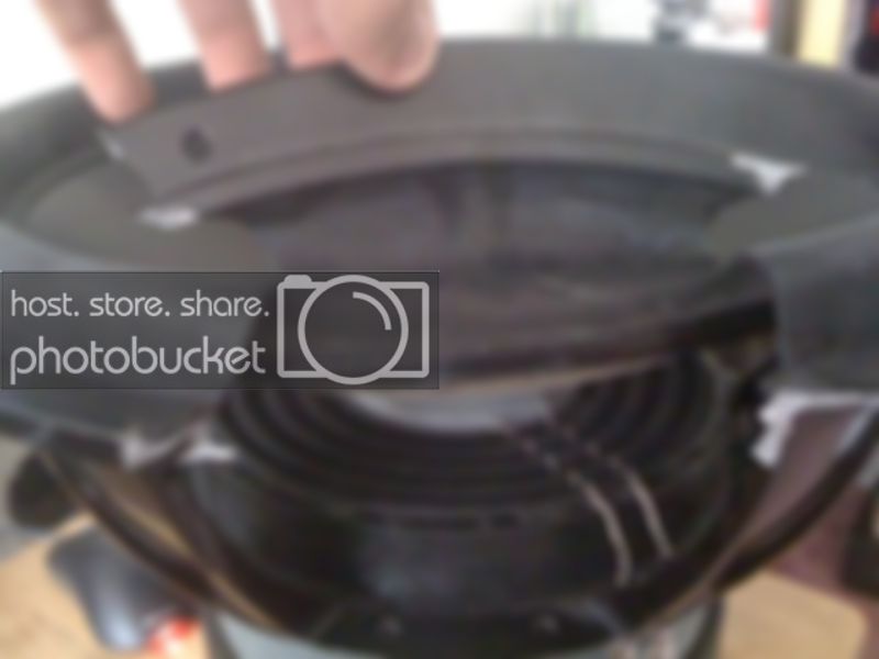

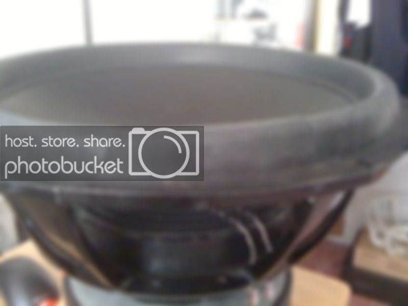

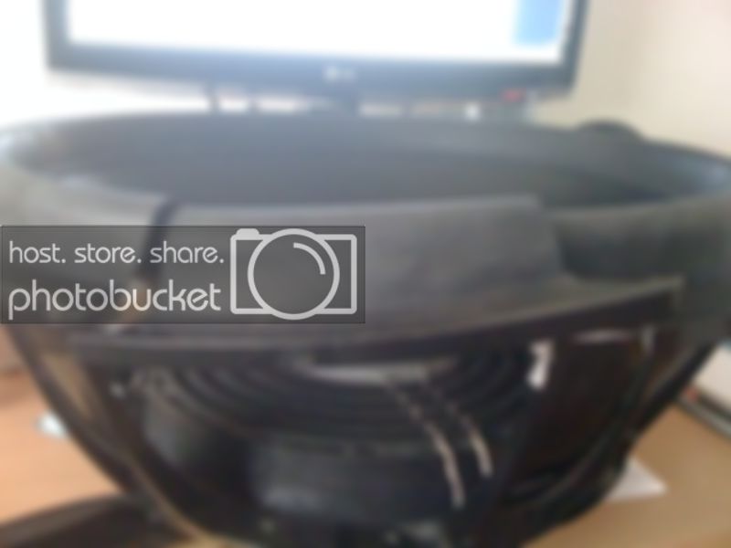

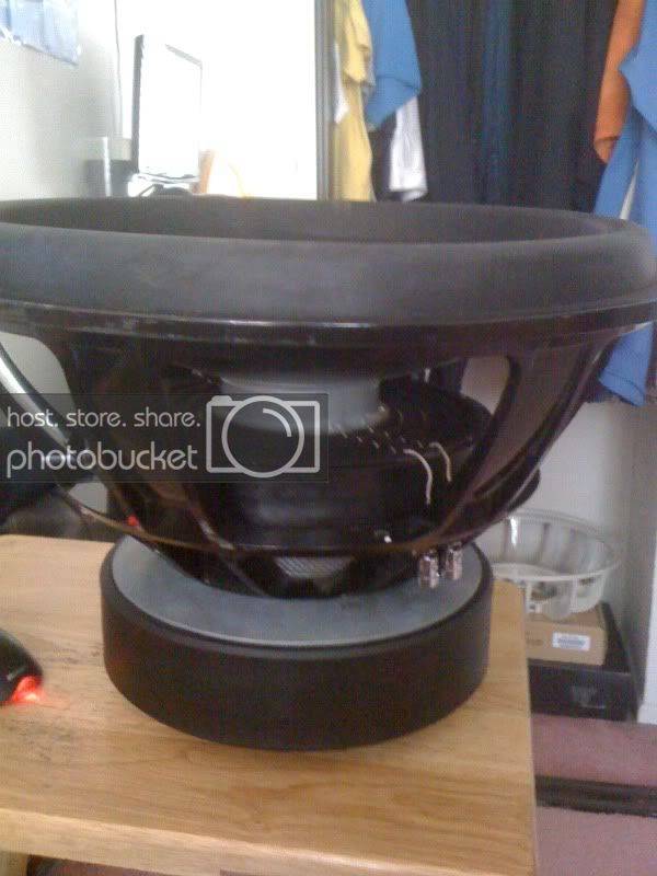

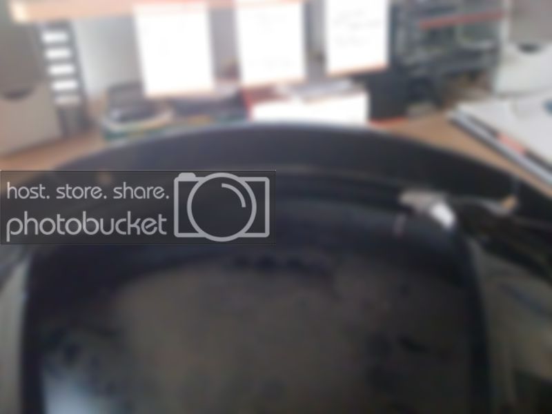

I received this today, and was planning on just using the spider/coil assembly and qca ring, but it looks like i can save the basket and use the assembly as a whole.

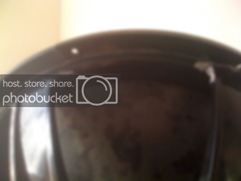

the basket is cracked in between the spokes, and it looks repairable
how would i go about fixing this? JB Weld?
Take a dremel with a wire brush, take off the paint in the surrounding areas by the cracks. Clean the actual surface of the break and bevel it a bit to get good penetration on the weld and just take it to a metal shop. They can tig weld that in there real nice and it'll be stronger than it was before. Hit it with some gloss black spray paint and get a recone. I know it's probably not the solution you wanted to hear, but it's the only way to PROPERLY repair that. It's not a large chunk or supported by any of the spokes, so slopping some JB Weld on there is far from a proper fix.

Thanks bro
TIG'ing it will fix it, but if you want to keep everything in tact, that will not happen. You'd probably need to recone it. Not sure if you wanted to go that route, because it looks like everything is in decent shape. Well, minus the slices in the surround. :lol: It's possible to keep the coil and spiders and just change the cone. Hit up David of TeamPSI. I'm sure he could help you out.
