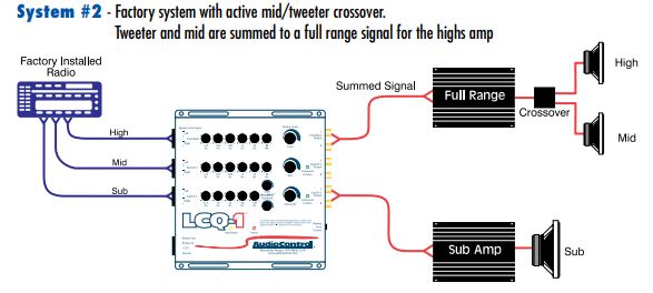

One main difference between the 2008 and 2015 audio is how the factory amp is configured. In 08 it was a 5 channel amp using passive crossovers for the door, and I was able to wire the LCQ-1 with fade capabilities (I have children in the back often) so I could reduce the rears when I was alone. In 2015 the amp is active so I need to wire the LOC differently. I will still have remote bass control but won’t be able to fade - not the end of the world.

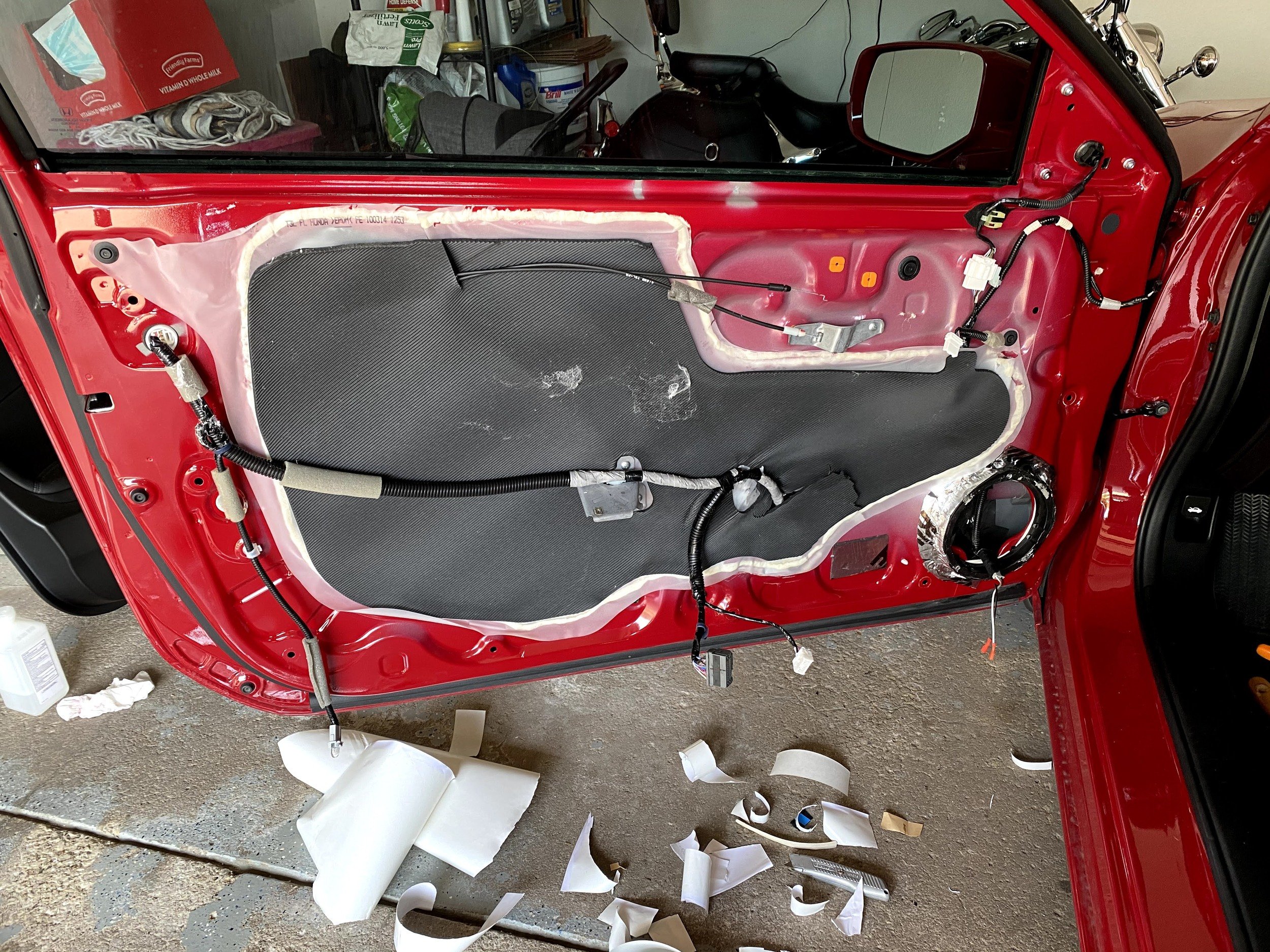

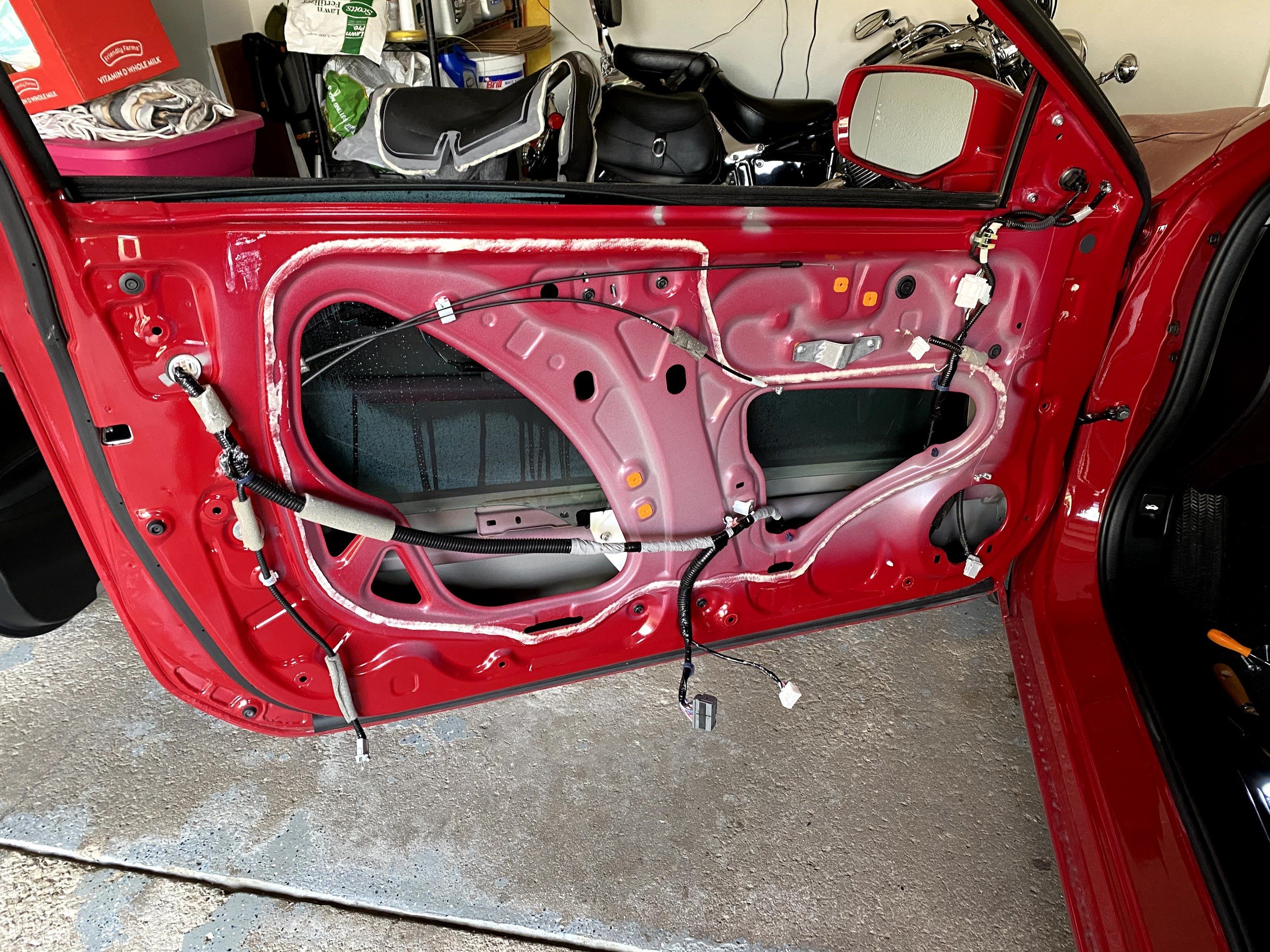

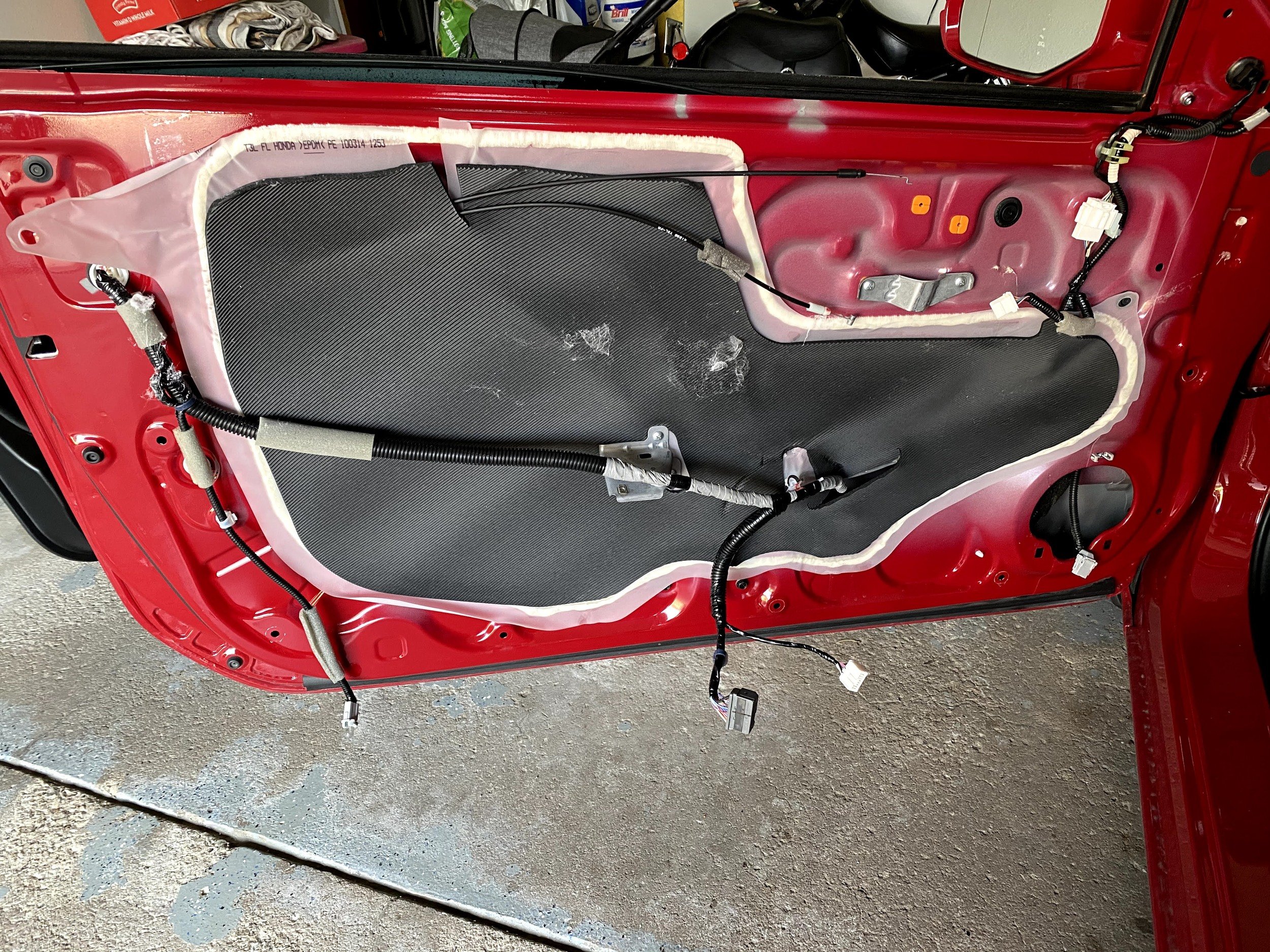

Here’s a pic of the door with the panel removed:
23794
Here’s the factory CCF and moisture barrier removed:
23795

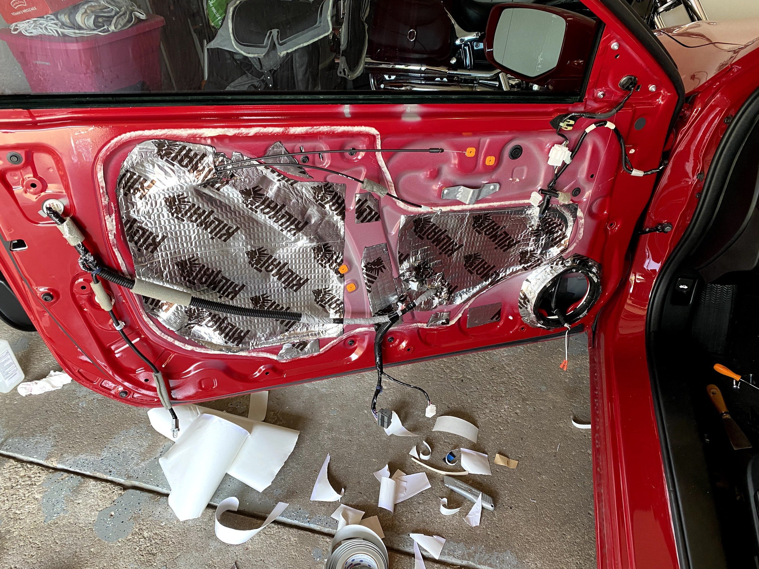

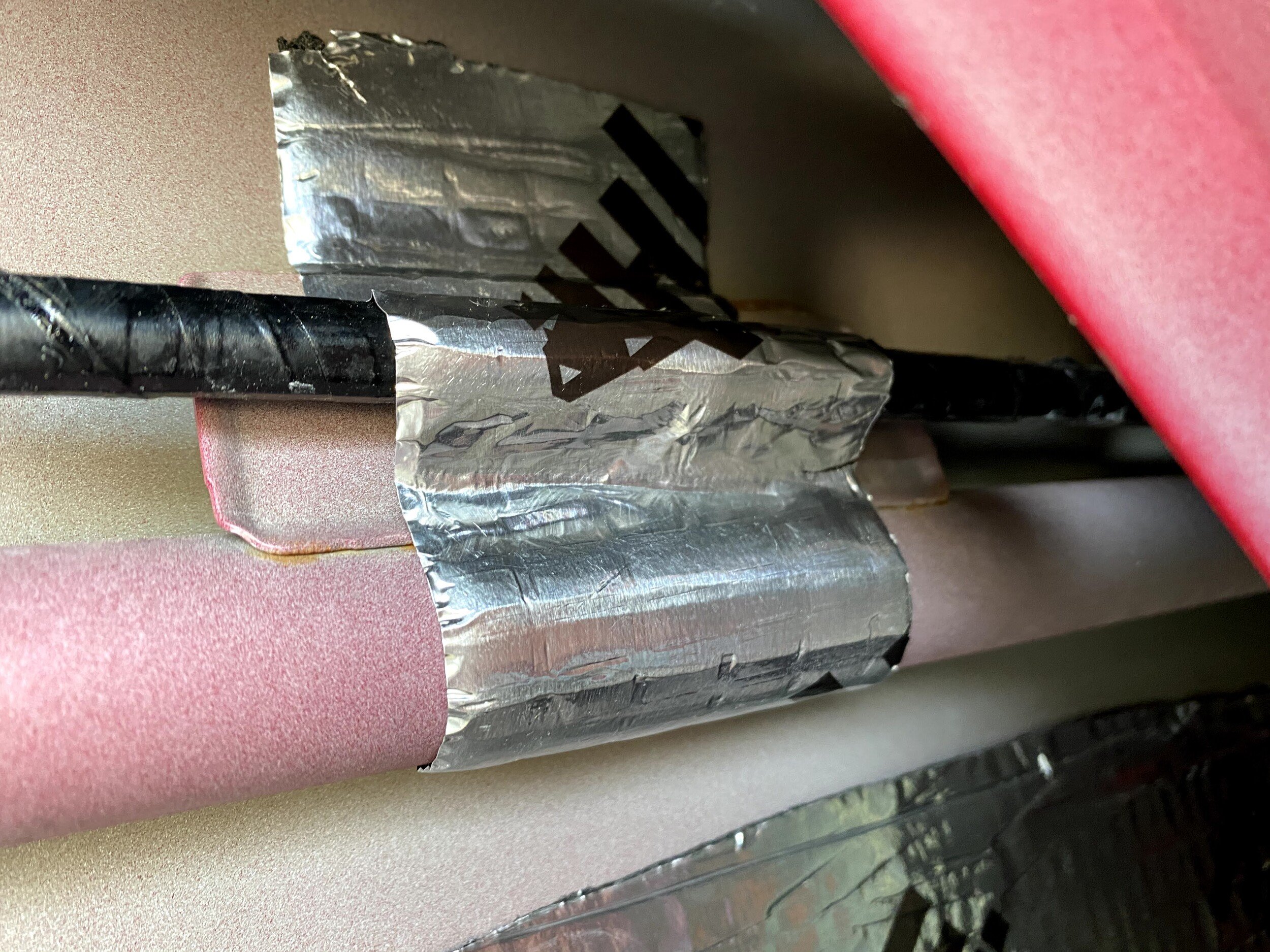

Added Kilmat to the outer door skin and used on any wiring harness I thought might rattle:
23796
23797

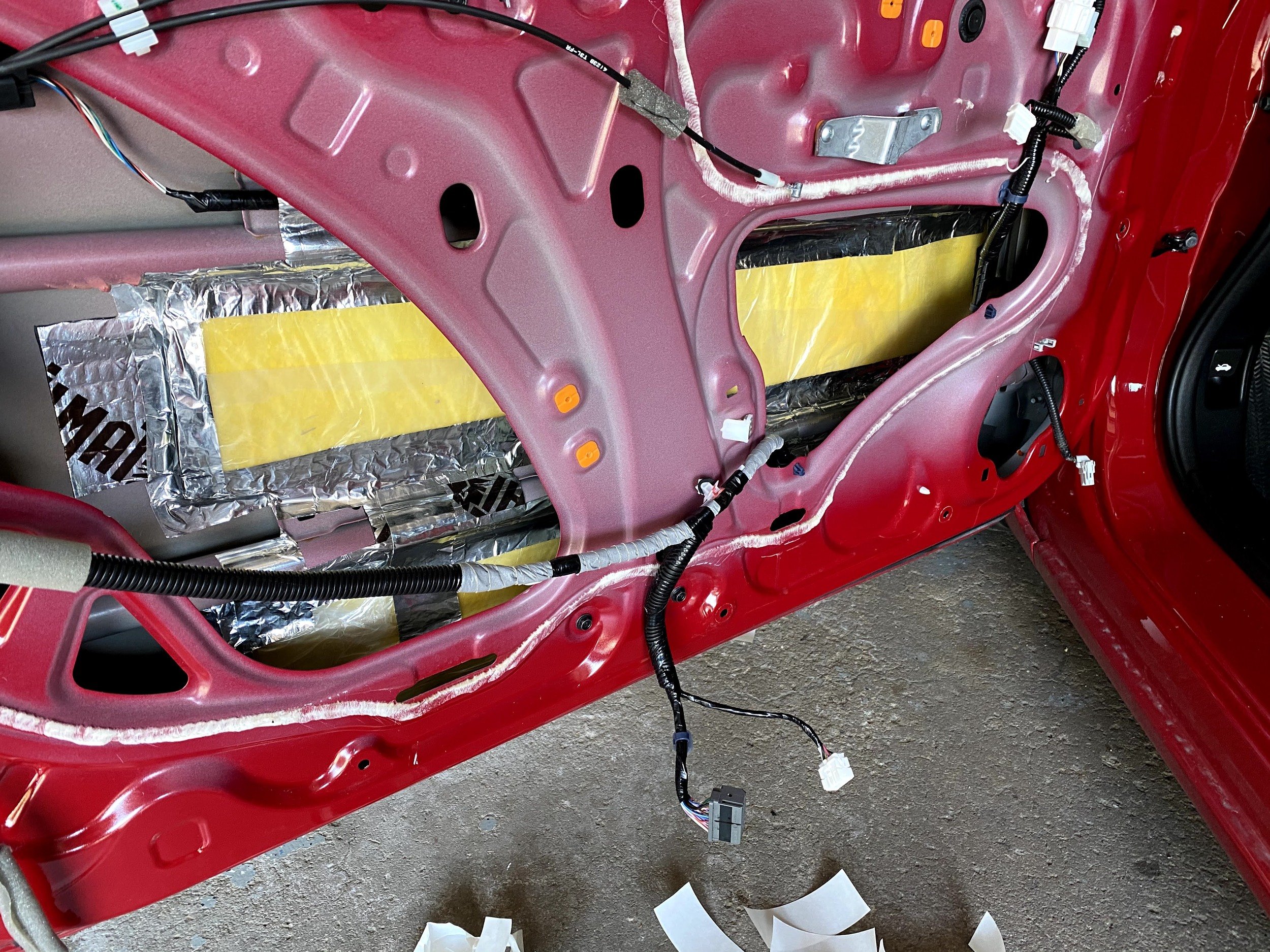

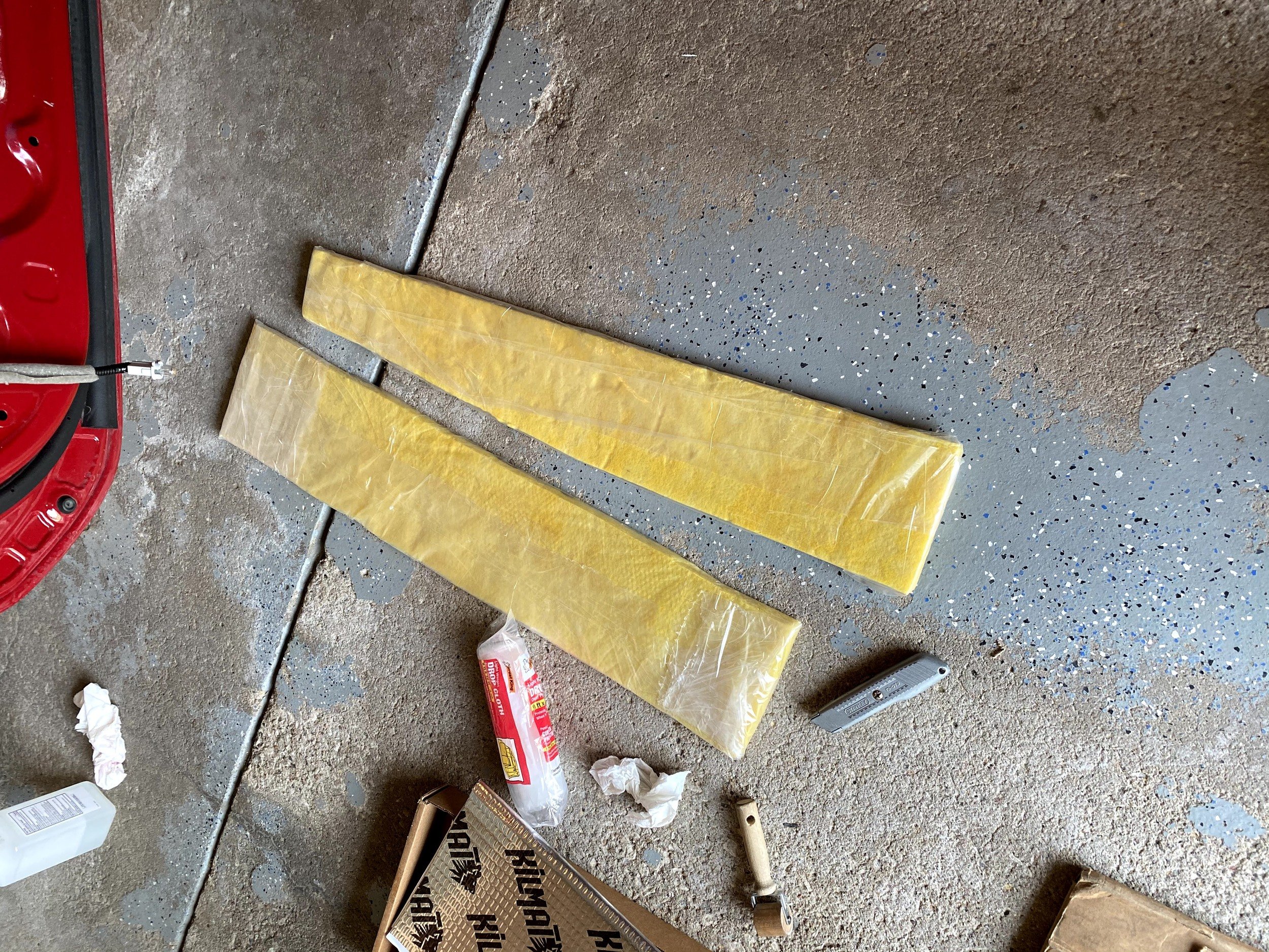

This is the third car I’ve added fiberglass insulation to and the results are always amazing with enhanced bass response and noticeable reduction in outside noise (road, vehicle, etc.). The concept is turning a metal enclosure into more of a speaker enclosure. The why’s/how’s are from a user @keep_hope_alive with a thread on caraudio.com and a YouTube video discussing the treatment.
Fiberglass prepped:
23798

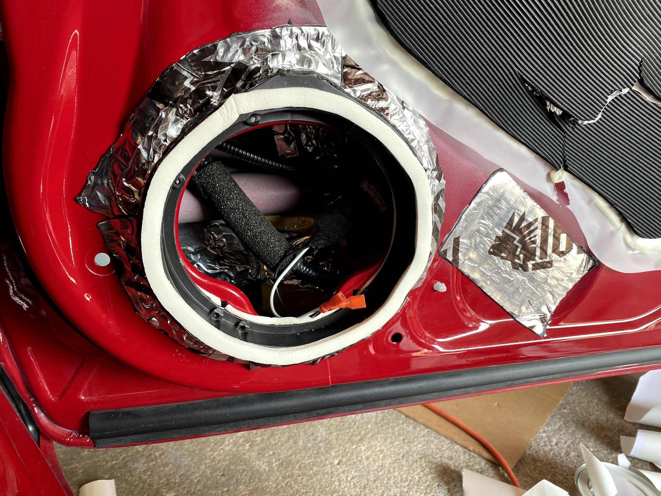

Fiberglass installed:
23799

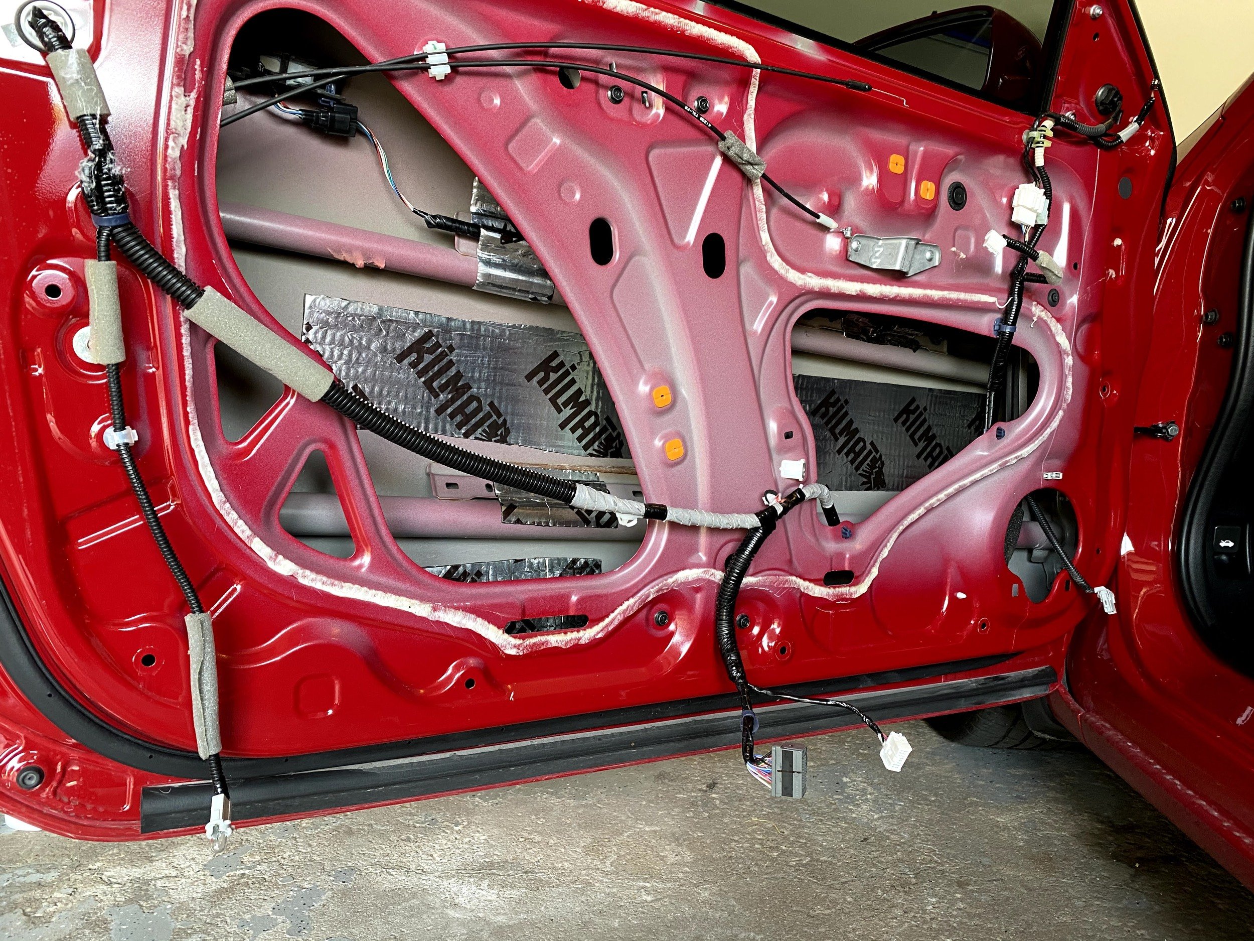

I used Kilmat to close the openings in the the door:
23800

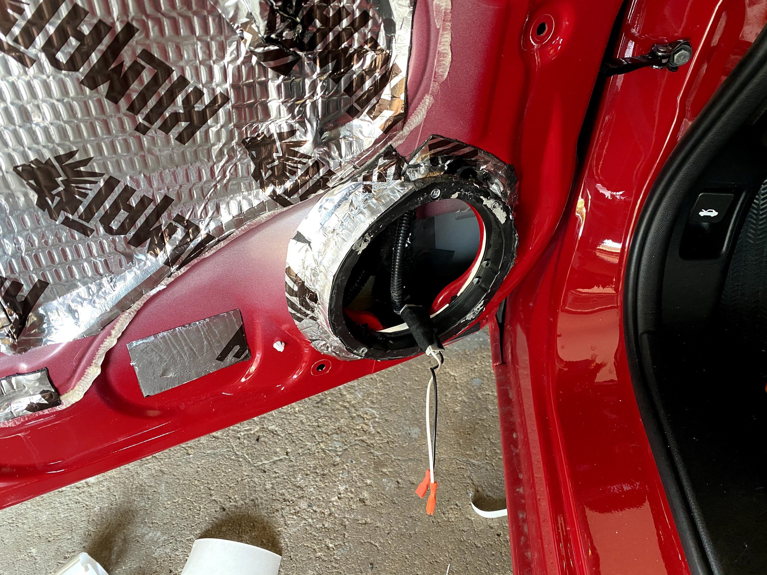

Installed adapters I received from Crutchfield for my previous Accord:
23801
Used CCF (weatherstripping) under the adapter and between the adapter and speaker:
23802
Used Kilmat on the adapter:
23803

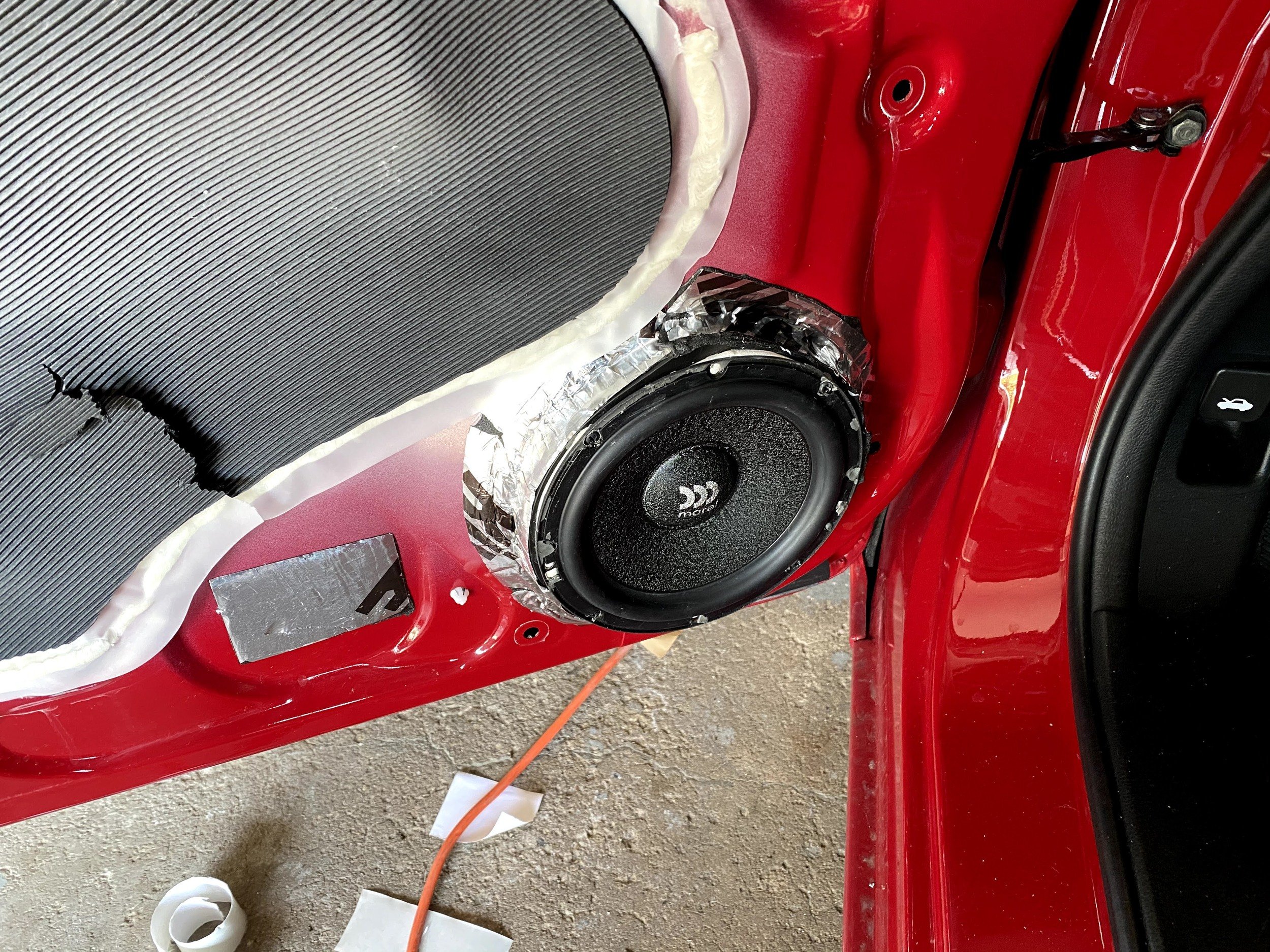

Finished door - I did reinstall the Honda door treatment as they’re using CCF:
23804

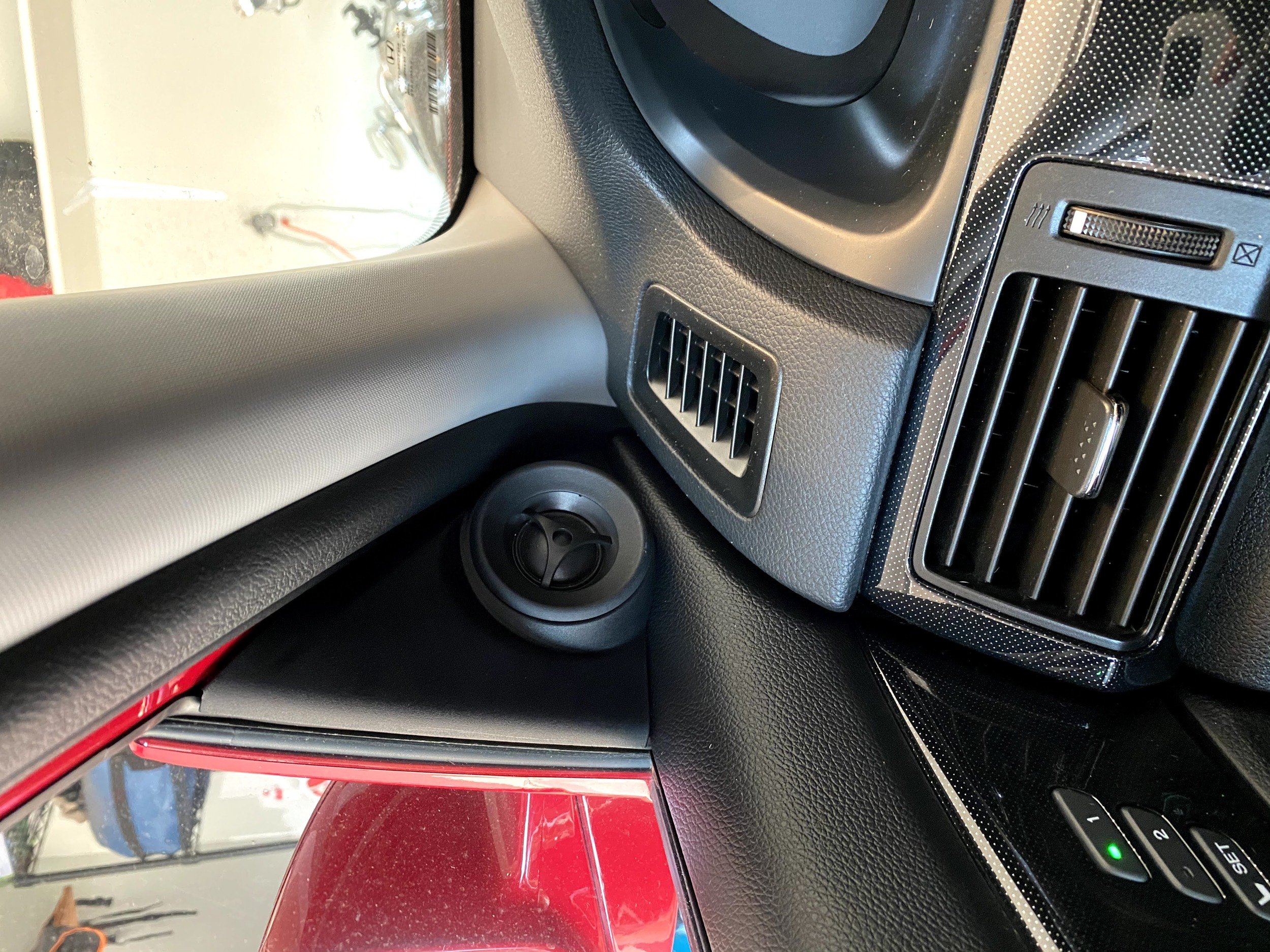

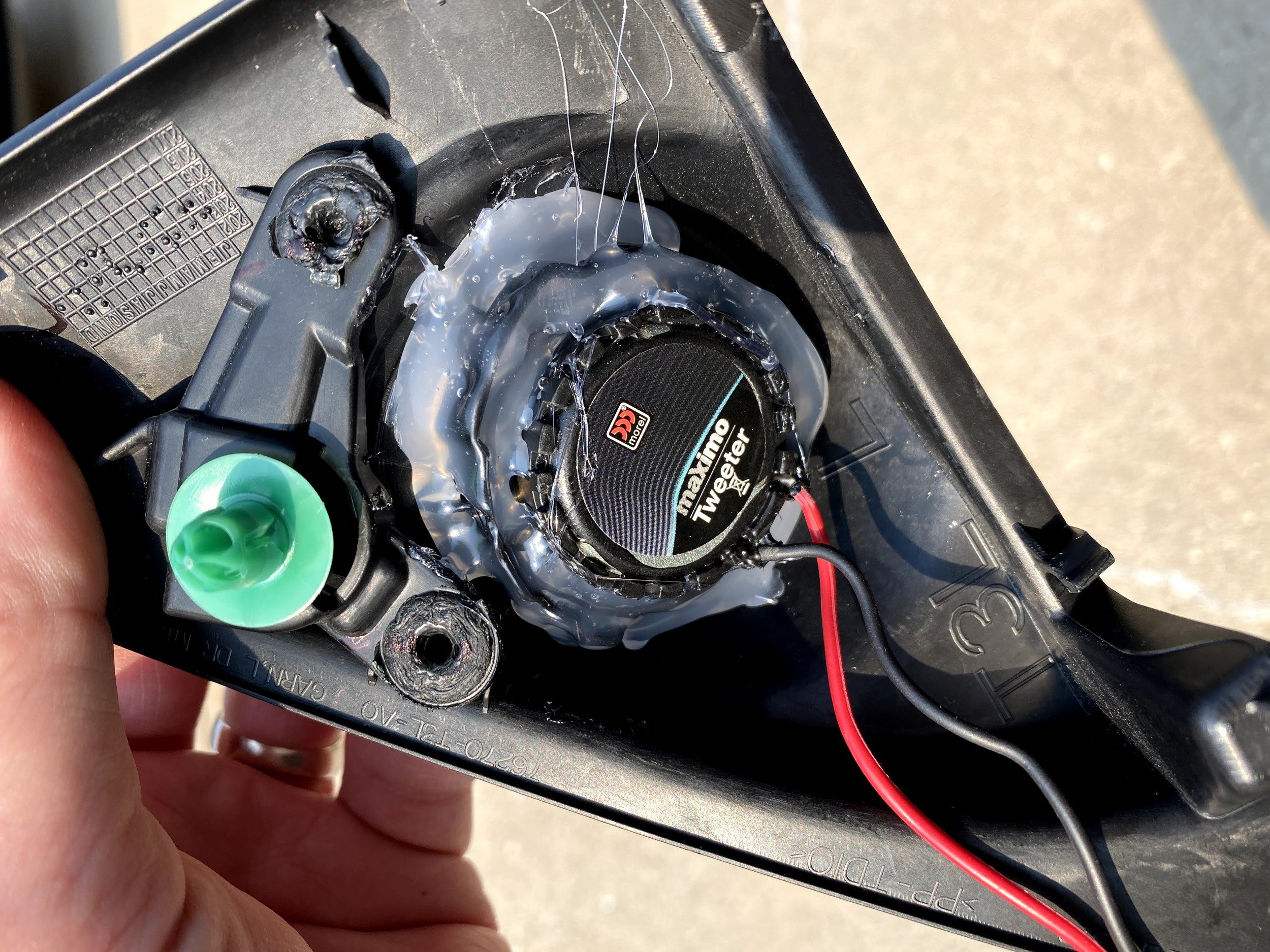

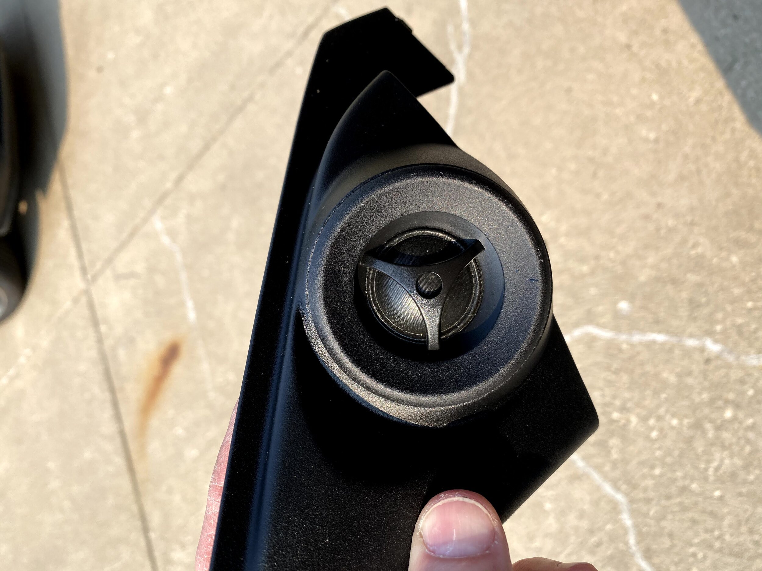

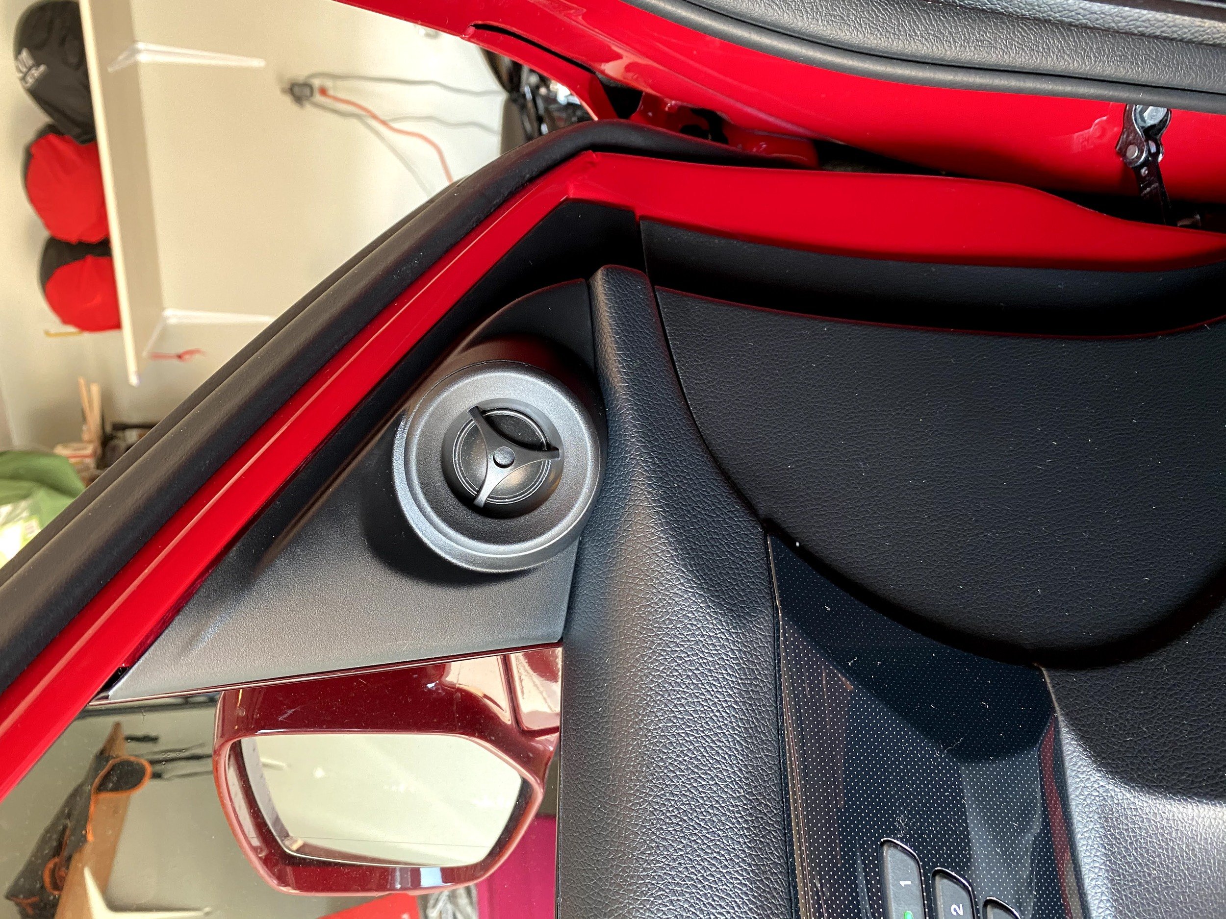

I removed the factory tweeters and was able to press the Morel tweeters into place then secure with hot glue:
23805
23806
Tweeter installed - wasn’t able to use grills but I don’t feel they’re necessary:
23807
23808
