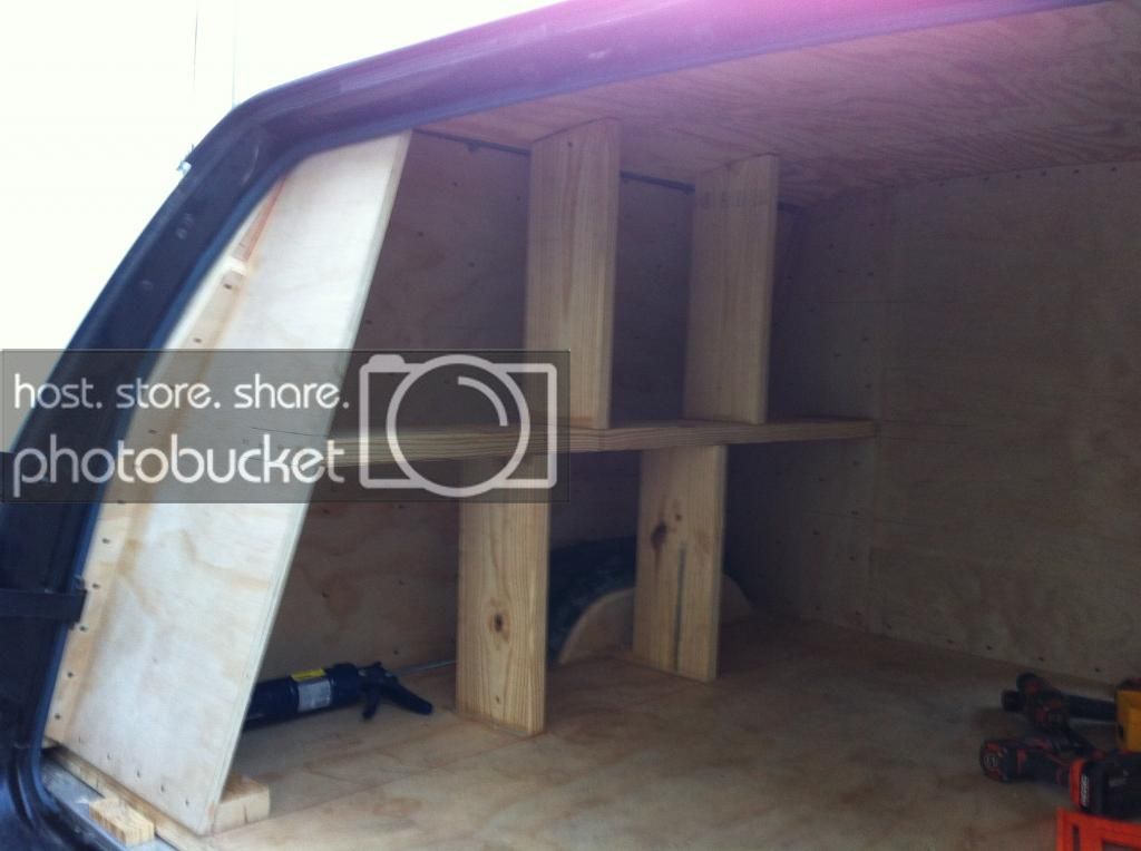

my build uses 2x8 structure behind 3 layers of 3/4 ply
build strong so you dont have to band aid with crappy pole bracings or thread rod
brian...that looks solid. But, i dont think Ive seen a side wall like that. Def different.
its a 4th order. 17 cubes net sealed with subs mounted regular 18.5 cubes net sealed if i mount inverted - 55 cubes ported c pillar square burb.

it would be a great experiment to test the sa 18 sub as is - get your scores - then spray foam the heck out of your wall / seal it off completely - make final trim pannels to fill all the gap - caulk it - let it all setup dry a day or 3 then re meter and see what improvments were made.
my guess
peak resonant hz goes up by 2 hz as well as score up by 1.5 db - but some low bandwidth may shrink up
