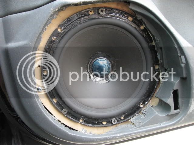

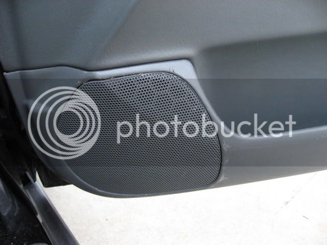

i have the same car and good luck getting 6.5" speakers in the front to fit in properly with the grill to fit on right. the speaker is mounted on the door panel itself and not the door which i think is a really crappy thing. i literally jigsaw'd the part behind the grill and mounted MDF rings to my door to make 6.5's fit right.
Why is the depth for the speaker to great? (like it sticks out too much?)What would you suggest doing?
well, when you try to install it you will see what im talkin about. they had some kind of OEM pod i there for the speaker. i think the OEM speaker is 6" so when i tried to put 6.5" in there i had to literally shove it in there and the speaker grill wouldnt close.
What i did was jigsaw taht whole spot off and mount an MDF ring on my door.
too bad that little hole in the door limits what kind of mids you can get too.. i bought aa poly mids and the terminals wouldnt clear.
Did you just drill it into the door I guess? I know what your talking about that factory big bowl shaped thing that the speaker sits in. What do you think of the speakers overall. Also I think im gonna go with the Alpine MRP-F550 for the speaker amp cause its 20 watts more to each channel and only like $30.00 more on onlinecarstereo.com

i drilled a new hole and used t-nuts to hold the baffle on.
