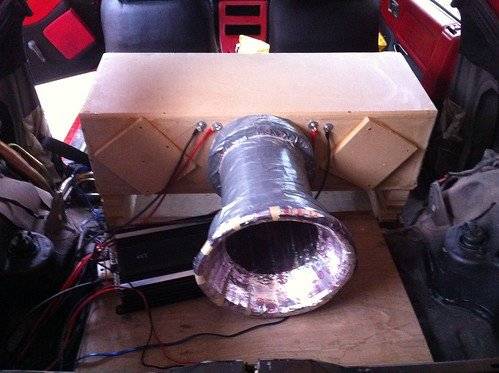

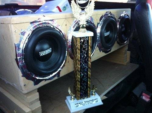

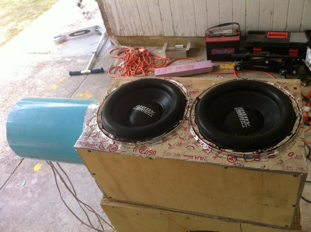

I've played with a few SA8 boxes myself. I've had better results with boxes on the bigger side. Actually, my loudest box was a pair in 2 cubes. I've tried them in as small as .25 net for a pair. Lol (fail btw).
It's cool that you've tried several boxes with them and that you shared that info. All too often people are just saying what they see everyone else saying.
Of course, most of my experience is from a pure SPL standpoint, although I have had them in a few daily boxes.
Worst box. Lmao.
Best setup.
