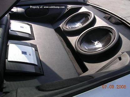

Here's the box.
According to the site, it's 1.1cf each.
