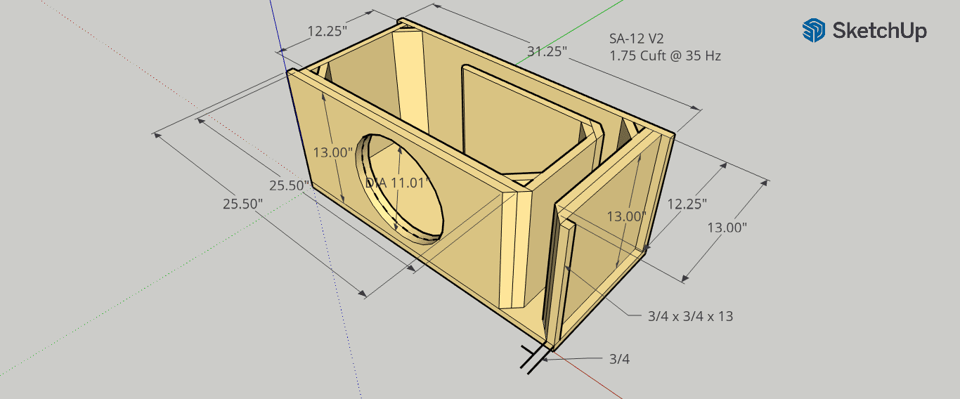

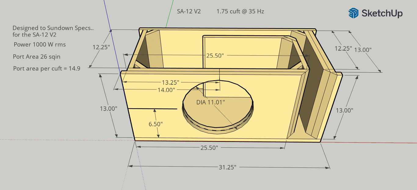

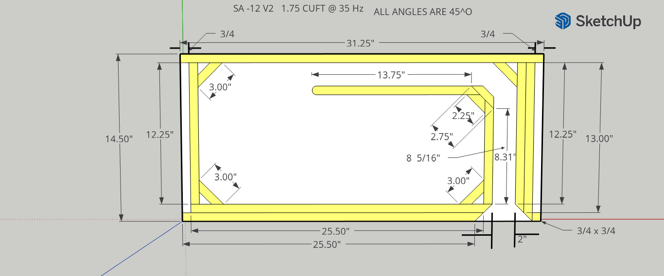

Here it is, you are welcome !

Should have no problem fitting two 12s ported in that trunk. Could always run an Aero port to save space. I fit two in my 2010 Focus trunk using a 6" aero port with 13.8 cubic foot trunk. The Elantra trunk is slightly larger at 14.4.
