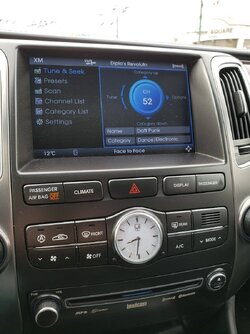

Yes, I'd like to keep the head unit stock as it isn't possible to insert a single or double din in the dash.
I tapped into the factory sub to supply the hi low converter, is it possible that that signal was already tuned way low for the factory sub and then further lowered by my amps xover. Not sure why it's such low bass, I'll go mess with the amp xover now.
