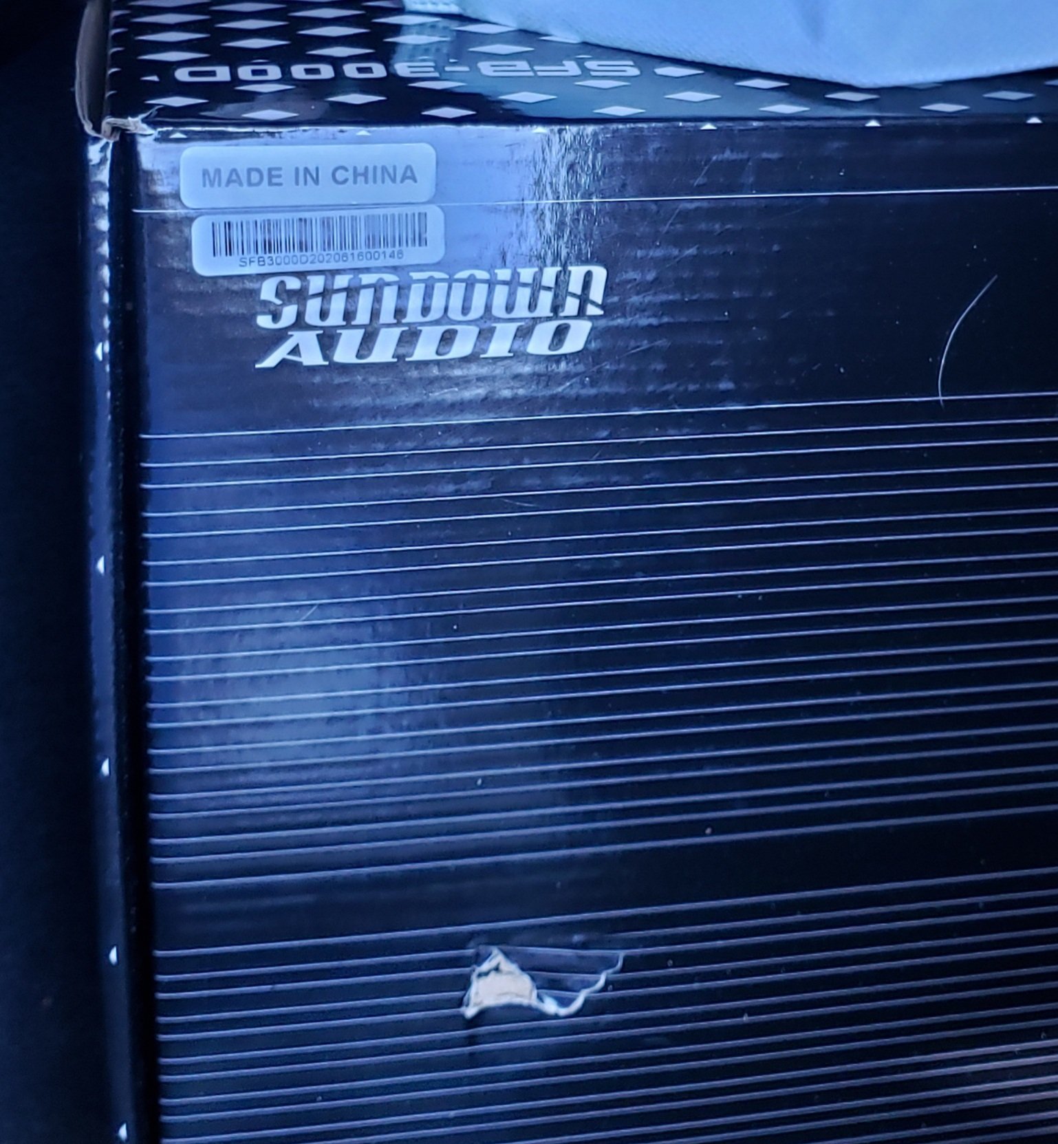

Chinese amps, right?
So what? We've been over all this before or have you forgotten? I would take their Chinese Full Bridge over just about anyone else full bridge including Taramps.
I understand. I just bought a Sundown SFB3K. I was just curious if you were going to ridicule people for buying Chinese amps like you do the people who buy Chinese subs.
