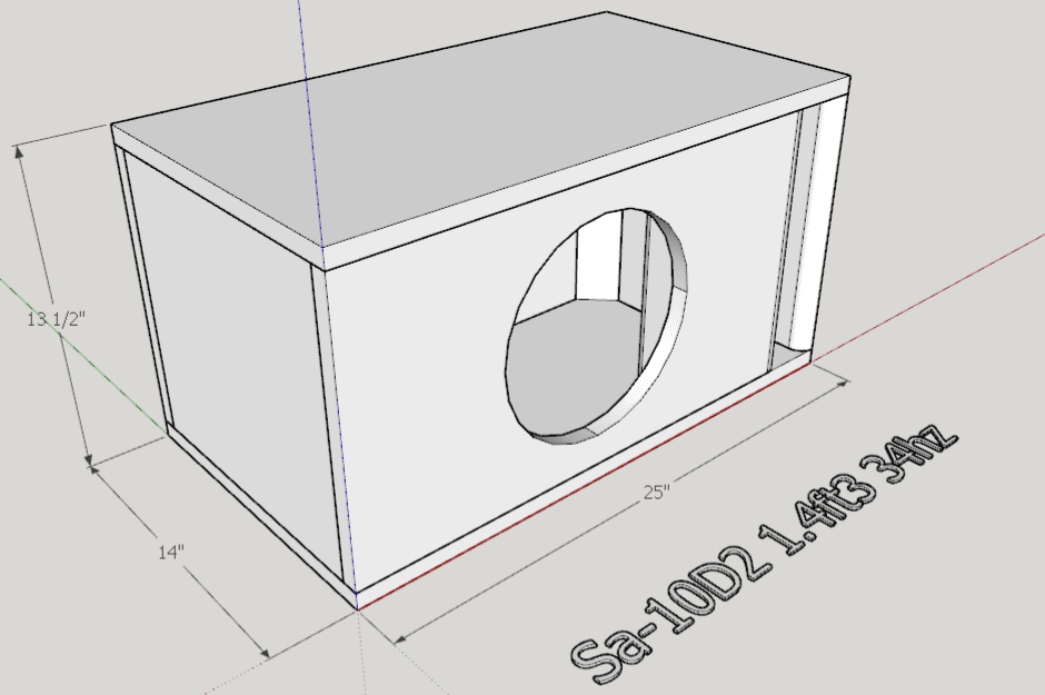

That's NOT a ton of space listed...(2.1ft3 gross before displacements)... IDK... I suppose that using a round and maybe settling for a smaller volume with whichever 12" driver you choose would be an option. But too many compromises will inevitably affect the end result. If that much space is really all you're willing to give up, I'd probably do a single 10" sub as the volume will be closer to optimum and will have better (probably) response.
This is an example only... not a recommendation. This is a slot ported Sa-10 enclosure that's 1.4ft3 around 15in2^ft3 just for space comparison purposes.

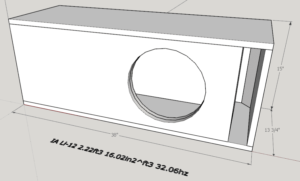

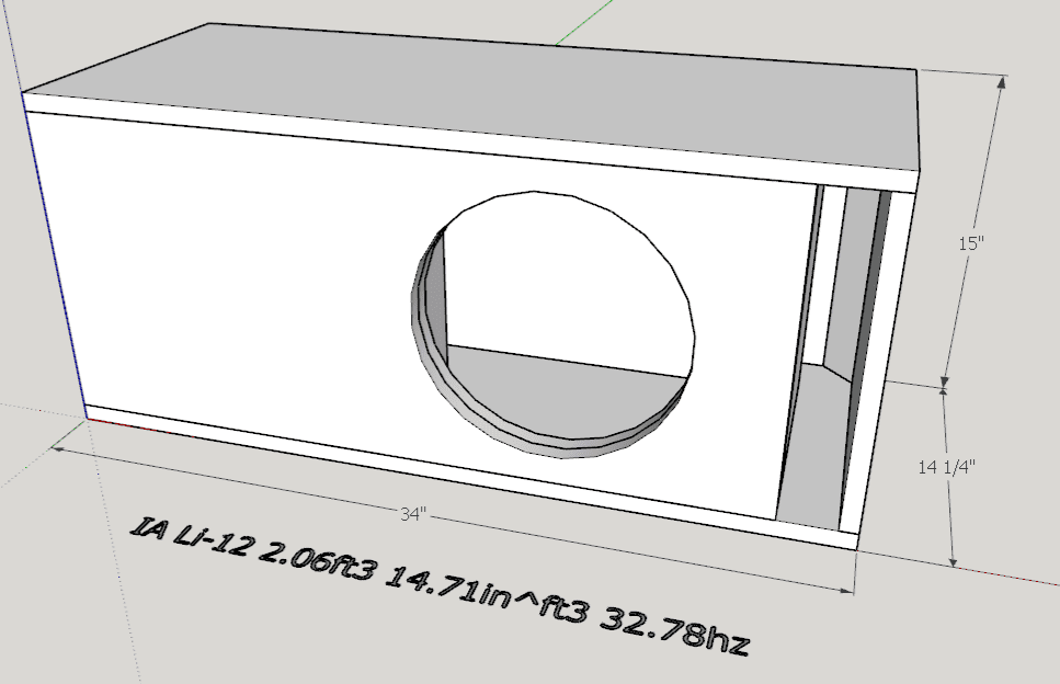

Now this one was fun to design... and would do REALLY well on an even larger amp. But fine on a JL1000 I think. It's actually around 3.25ft3 gross to get 2.06ft3 net... that's one sub I wish I had to play with. I feel it's never good to compromise on volume too much, but that's IMHO. It's not really a small box, but one fairly capable single 12 that's for sure.
I like that second enclosure, sure would sound good in my car... lol
The space I listed above is just the size of my current box, as I liked how much free room it left in the trunk. I'm always willing to go bigger. Is it alright if I private message you when I get exactly how much space I would be willing to play with?
If you want a double baffled slot ported enclosure thats gonna be fairly low tuned and for your power... I'd try for around 3ft3 gross... that's spitballing and only an estimate.
