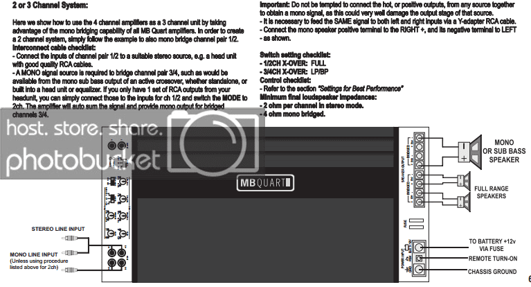

My subwoofer is wired in like this (right picture):
And my amp is set up like this:

amp settings: 3rd and 4th channel X-over should be set at Low pass (LP/BP) turn the low pass knob to halfway. Then start setting the gain knob via DMM method.

You have a 4 ohm dual voice coil sub that gives you the option to wire it in series (positive to negative jumper) that gives you an 8 ohm load which is horrible for getting any type of power going to it. Other option is to wire in parallel (pos to pos, neg to neg) This gives you a 2 ohm load which is fine for monoblock subwoofer amps. However in your case, your trying to bridge 2 channels of a 4 channel amp. When you bridge them, they are only 4 ohm stable. If you've wired it parallel, your amps will overheat and not make the power it should through loss of heat and efficiency. If you wired it in series, your barely getting 100 ish watts to the sub which is not even enough to tickle it.

1: hook that sub wired parallel to only 1 rear channel of the amp so that channel sees a 2 ohm load which its stable at when its not bridged.

he has a single 10" 4 ohm DVC sub and two bridged channels of a 4 channel amp thats only stable at 4 ohms and up. He doesn't have any possible wiring options that would work well(make the sub pound) without blowing up the amp in the long run.

If I'm following this correctly you've got a 10" Alpine Type S with a dual 4 ohm coil configuration. Meaning it can be wired to 8 ohms or 2 ohms. It can handle 500W RMS.
If you purchased the Kenwood KAC-5001PS recommended earlier, that puts out 500W RMS @ 2 ohms, so it should be a perfect match. Wire it as per the diagram on the right in your first post, or like this (same wiring, cleaner example).
The final load should be 2 ohms (testable with a multimeter).

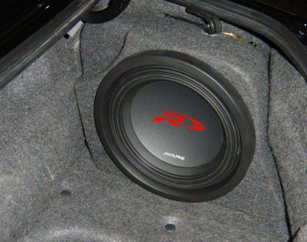

I bought a custom made enclosure made for my Honda S2000. Not ported. Its a small car with little trunk space, this was the best way to use as little room as possible.
Exact one in this picture:

That's not a Type S, though. Is is still dual voice coil; are there four terminals on the back of the sub?
