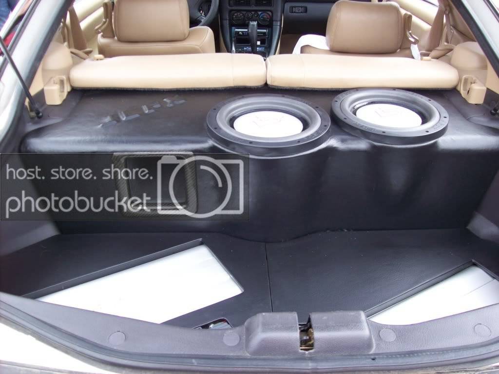

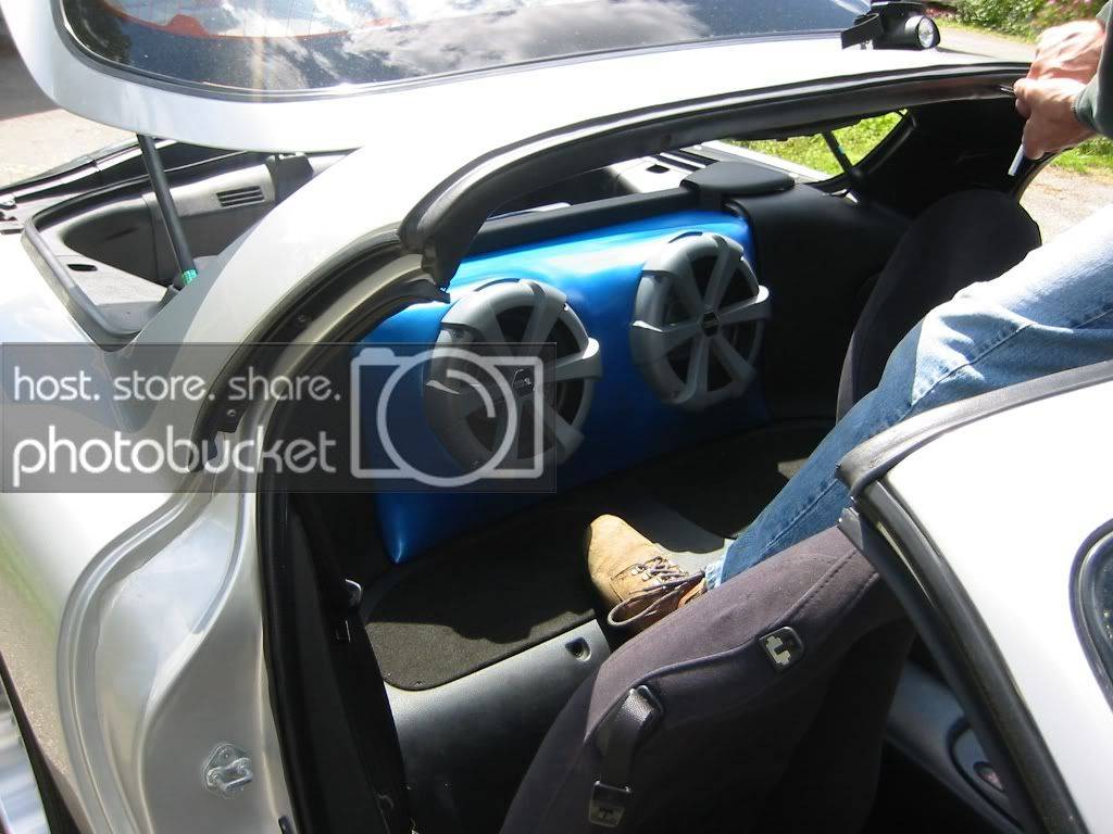

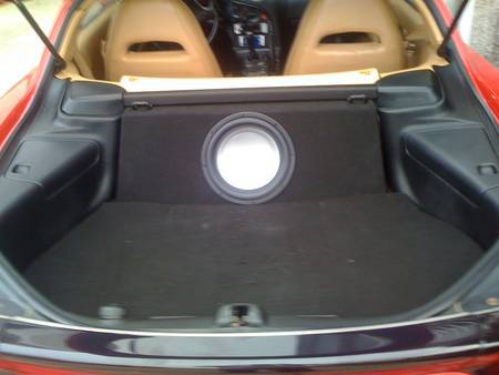

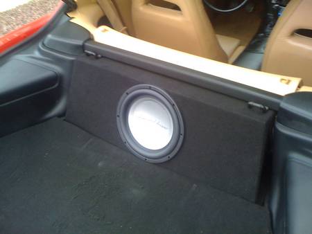

Here are the pics to give you an idea on what the inside of my car looks like:
Sub facing the inside:
Sub facing the trunk:
The guy at the audioshop told me something like if the sub faces the boot the bass will first be hitting away from me and then coming into the cabin whereas if the sub faces the inside of the car I'll get more clean bass etc. but i'm not sure //content.invisioncic.com/y282845/emoticons/confused.gif.e820e0216602db4765798ac39d28caa9.gif
