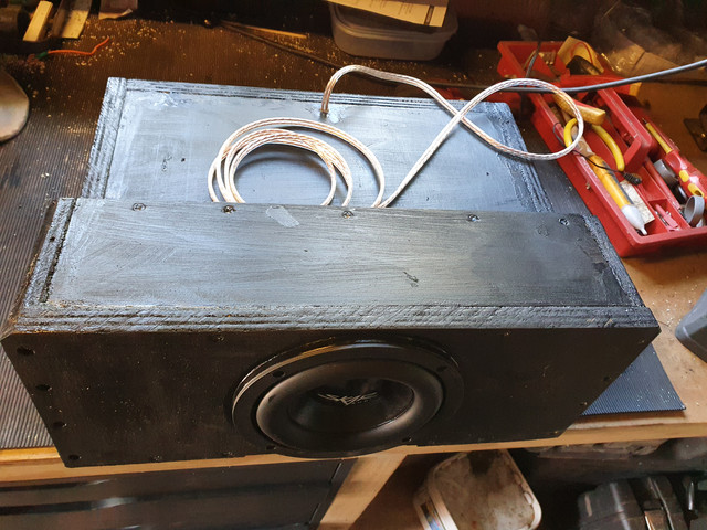

Ok maybe a bit over dramatic, I decided to build my own subwoofer for my Mk1 Audi TT and wanted to fit it in the space where the existing unit was, giving myself a bit more room ripped out the CD changer and navigation unit etc.
Subwoofer spec here https://www.skaraudio.com/products/evl-65-inch-car-subwoofer
Using this speaker i thought for now id just build in one drive unit (i do have 2) as its such a small cabin i thought one would be enough. Ive built subs in the past albeit much bigger, this just sounds sh't the drive unit moves but no bass comes out, well none of importance and i would say most is from the doors, if try and drive it too hard i get the dreaded 'wop wop' and no increased sound.
Its running LPF cut off around 100hz and bridged from my pioneer amp. GM D8604

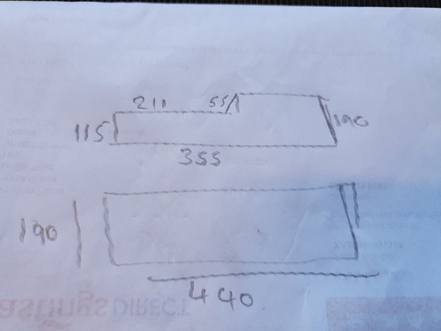

Do i add the second unit to the front? With the same box dimensions will that improve things? Should i scrap it and buy a base tube or box for the boot? The dimensions here were to fit in the space hence the narrow profile at the back. Anyway any comments most appreciated.
dimensions here.

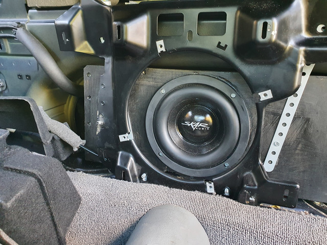

need pics of where its actually at in the car as in is it at the stock location or is it somewhere up front?. along with how you are getting the signal.. aftermarket head unit? loc?
Have you verified that the box is 100% airtight? Assuming it is I'm also leaning towards suspecting that it's just where you have it in the car that's holding you back.
Yes the unit is placed right behind the passenger/driver seats in Audi Mk1 TT roadster (only 2 seats)in fact where the original subwoofer was located. Pic below shows location dead center of car over gearbox tunnel, rear of box is actually in the back of the boot of the car
Config is
Pioneer MVH-X580DAB head unit --->RCA ---> Pioneer Amp GM D8604 LPF gain norm and i think cutoff around 100hz

OK, just throwing it out there because even a small air leak will rob you of a lot of output.
That does look like a terrible mounting location. Typically subwoofers do best in a corner. Of course you may be limited to mounting options. Can you test that box with the sub firing into the back corner of your trunk? That may help. Porting the box should gain 3dB but that may or may not be physically possible given your box dimensions.
you still havent addressed how you are getting your signal, does the car have a factory amp? is it still a factory head unit with an loc?
But that stock location is absolute atrocious. take it out, put it in the back firing towards the rear trunk/hatch lid.
