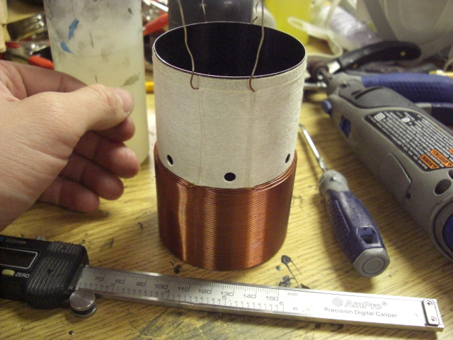

Coil right here :
It's a pretty stout coil //content.invisioncic.com/y282845/emoticons/smile.gif.1ebc41e1811405b213edfc4622c41e27.gif
thanx jake! that is a pretty beefy copper coil with a really tall former. by the looks of it the coil will handle 1k as long as cooling is good. i am assuming the sub runs out of excursion before the coil overheats?
It would be pretty difficult to burn the coil -- unless the box was tiny and/or you played right @ tuning on sine waves you would reach x-mech before thermal.
Cooling is quite good thanks to the vented former and highly flared pole vent (giant flare on top).
^ oh i am sure but there is ALWAYS a limiting factory when over driven. people like to know if it is thermal or mechy limiting.
me personally pefer thermal limiting but i am a bass head and dont count, hate mechy failure when 3-10x rate power...

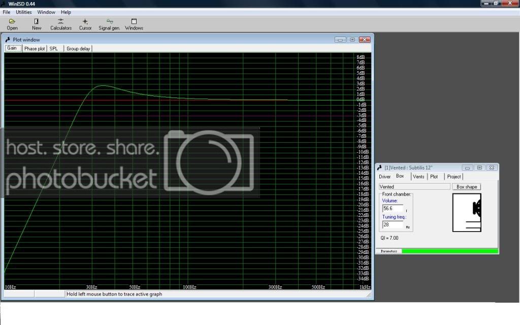

I think when I get the money, even if i got a simple build going for AQ's at the moment, Ill be the first to do a wall of these VVX subs hopefully in a scion xb or my Chevy suburban. Give em about 900 watts each, tuned low to 28hz.
