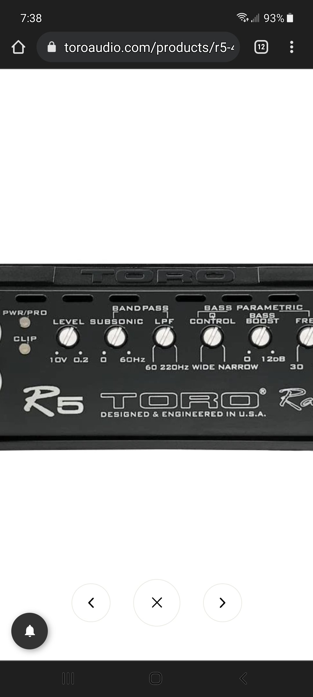

I've been racking my brain over the last long couple of days over this situation. I have 2 12 subs and a toro r5 amp, and I'm getting words through the subs with muffled sounding bass. I have bought a new head unit, tried different rca's and other subs I had laying around. Still getting this funny sounding bass. It is almost like playing a big midrange. I also have tried my kicker key47 l.o.c straight from the radio, as well as the sub outs on the back of the radio. It just sounds weird no matter what I do. I have been in car audio for a while but this one got me stumped. Does anyone have any suggestions, or insight where to start?
The amp is lpf only.

Okay looking at the settings set the subsonic 2-3hz below the box tuning. Turn the bass boost off on the amplifier no one uses that they use the head unit for that or a DSP. That unit has a nice 13 eq built in and time alignment. Set the LPF at 80 hz on the amplifier and head unit. That head unit allows you to turn up the gain on the subwoofer and adjust slope and what not.
As I said you have an eq built in so you need to adjust that and stop using bass boost on the amplifier. Also what brand RCA's? If they are cheap with not a lot of shielding that may cause an issue as well. You say you have tried others but good quality ones do make a big difference.

I will give it this a shot. I never messed with bass boost in any system. Yes, it's a pre-built sub box, but not with horns. It is just a temporary setup until I get the time. I will definitely build a box after this troublesome install. In my other vehicle, I made the box and don't have this problem. I will check crossover slope as well as rca's. Any suggestions on rca's?
