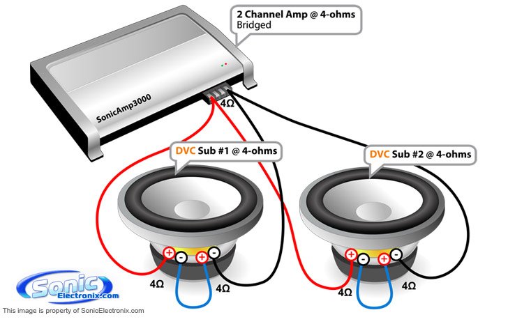

The pyramid amp is close to enough watts for the subs. Probably a bit short. You’d need to bridge it at 4 ohms, so your subs would need to be wired right also. The holes in the box kills it though. It won’t work with holes in the box.

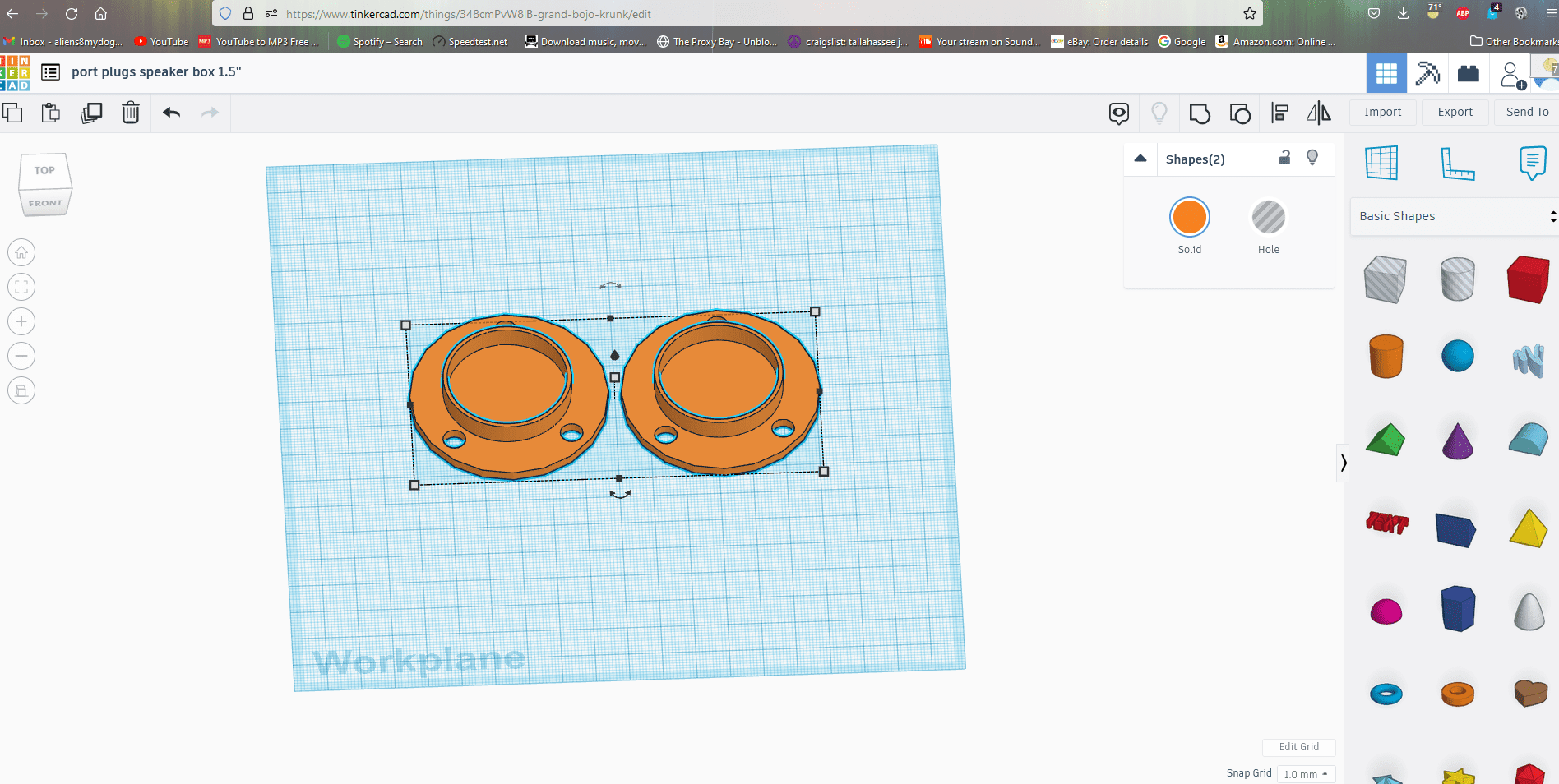

crap ok.... i can fix the box prolly. ill 3d print some plugs and fill the holes with polyfill. hope it works. make a plastic sandwich.

That’s right. Usually I wire the subs in parallel and just run one speaker wire to the amp, but that should work the same way. Also make sure your subs are screwed tight to the box. Any type of air leak will ruin the sound.
awesome! TY much. i just printed the plugs for the holes i drilled. they turned out great and i feel they should seal the box well enough. i will rewire the subs after the second set gets done printing. let ya know how it turns out.
ok. its sounding alot better now. got my rear-view dancing. still a bit under powered if you ask me but now if i turn it up i cant hear the factory speakers. mission accomplished. thank you very much slugbutter !
