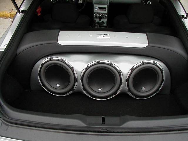

Eh, the way the cars "trunk" is designed. I dont really see a point or difference in building a box into the car vs sliding one in. I guess id have to look at your designs to understand what you mean. 2 12s sealed would be cool. Fiberglassed one on the bottom left and one on the bottom right. That'd leave you PLENTY of cargo room.
This. Unfortunately it's not a car that goes well with car audio. Just gotta work with what you have. I'd lean toward something like the 3 sealed pic above except with 4 8s in 2 cubes.
