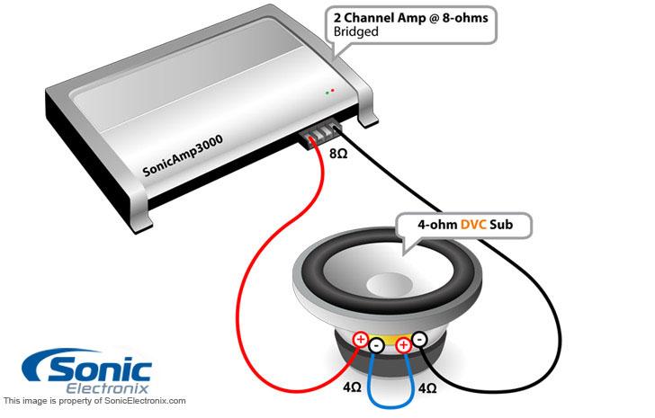

ok just saw this diagram. should i wire it like this?
You can do that but like I said then you're still only getting around 200 or so watts. Why are you deadset on the Boss. If I had the choice of the 2 you're running I'd run the Kenwood. Neither are real good subs but that Boss is real garbage!
