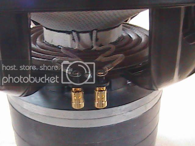

So I'm getting my recone in tomorrow and I've learned 04/05 XXXs are notorious for tinsel slap. I want to sew or attach them to the spider partially to prevent this. I don't want to totally draw them down, but I figured if I did it pretty close to the soder point of the terminal, I'd be o.k.
Any suggestions?
Attach them like this if you have enough tinsel lead length. The tinsels are sewn down in two places with many passes back and forth.
No you don't really go gluing the thread to the spider.You glue the bundle of thread together and if a little of the glue gets on the spider by the thread it is ok because it stays flexible but no you don't want a bunch of glue on the spider. //content.invisioncic.com/y282845/emoticons/smile.gif.1ebc41e1811405b213edfc4622c41e27.gif
This keeps the thread from unraveling under heavy use.
