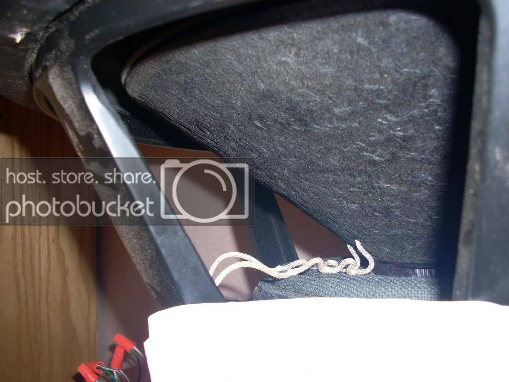

Basically it's the wire that connects the terminals (where your speaker wire plugs to on the sub) to the voice coil. It's generally a silverish, thick, braided looking wire. Let me see if I can find a picture..
Those two leads you see going towards the center of the spider would be the tinsels.
once I started thinking about it I figured thats what it would be, how does one go about replacing those?
