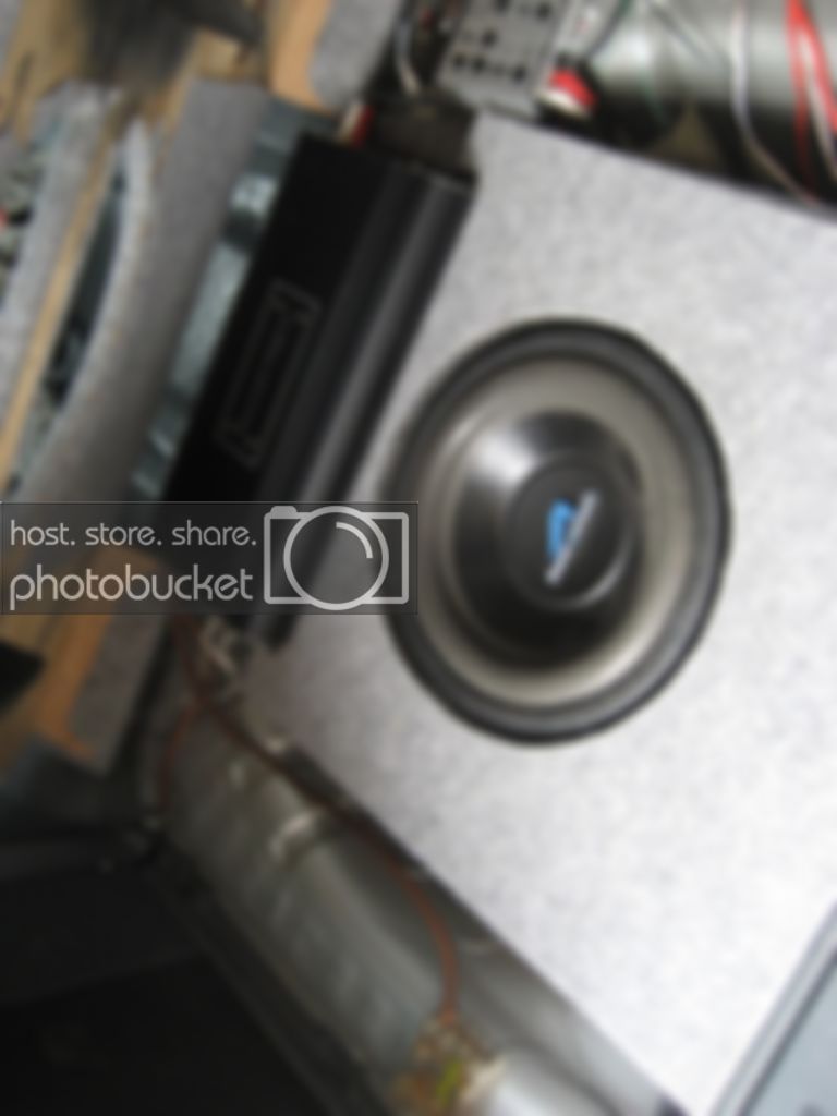

I'm currently using a power accoustik fubr 12 in a 1.70ish cu/ft sealed box. I just wont hit low enough, the res freq is only like 33hz on this sub. Plus, it's old and I think it's getting a little loose. I'm looking into getting an elemental designs e5.12.

my box is oddly shaped and totally sealed up so I can't take it apart. Can I put something inside to decrease the volume? Do I have enough volume to port it? I'm leaning towards sealed due to the odd shape of the box I wouldn't be able to have mush port length.
here's the box
