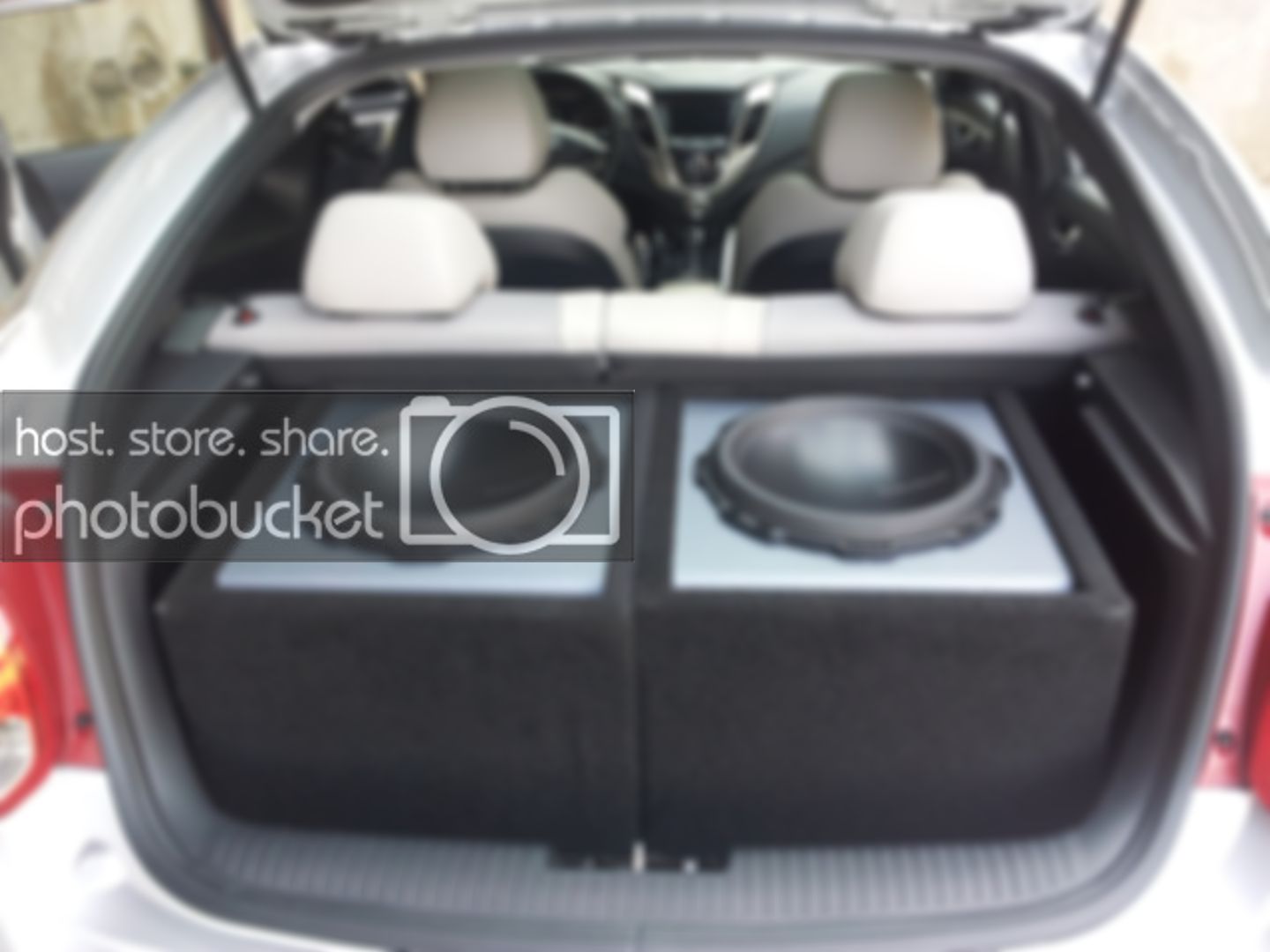

Thanks for your response. I will try lowering the xover point and see. Here is a picture of my car and setup for those interested. Pease don't flame me for using prefabs. I do not have access to tools to build my own box so this is the best I could do right now. Personally, I think these boxes are well made and they look super clean. I thought these specs would be ok for this sub though. What do you think?
http://www.atrendusa.com/atrend/karbon-kolors?page=shop.product_details&flypage=flypage.tpl&product_id=262&category_id=19
I have two of these firing up.
