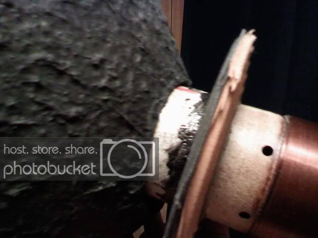

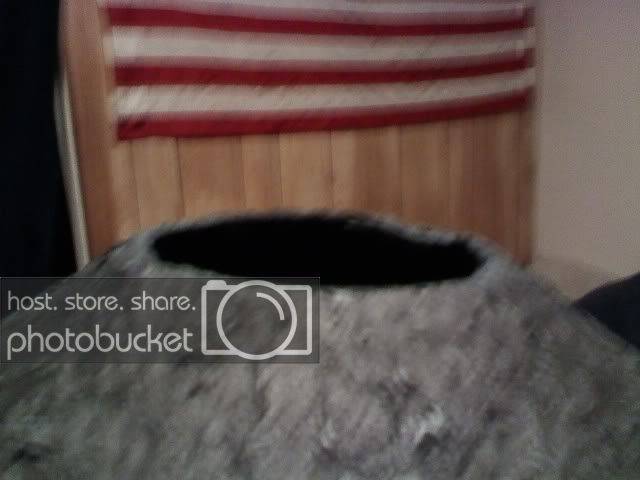

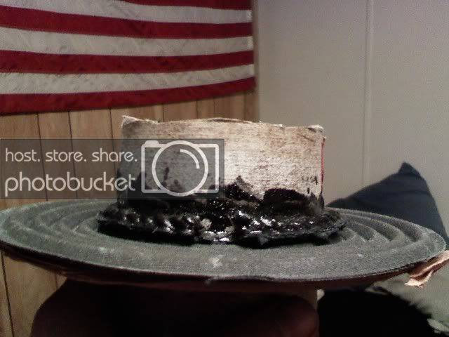

a little late but oh well my sub wasn't bottoming out it was the voice coil was hitting the dust cap:( pics below good thing thorshammer reconed mine =)
how come when my sub bottom out it has happened about 3 to 5 times i only here it bottom out like 1 time? one other time it bottomed out like 3 times very littly because it wasnt loud. what can i look at to make sure nothing is breaking? i have tuned everything now so it doesnt
You see all them white spots on the black spider??? Thats where the cone was hitting them. So if it didnt sound like it was "bottoming" out it was moving pretty good.I have first hand experience with the cone hitting the spider on my DDs but they have never broke like that.Just letting you know.
