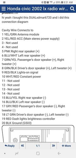

Have you checked to see if there is actually power at the fuse? Maybe go to the local dealer and see if they can print you a copy of the radio pinouts and see if your getting power to the radio. I have a power probe3 the can supply power and ground as well as check continuity. Best $60 I spent.
Edit: This is for a 2002 Civic, not sure if it's the same.
