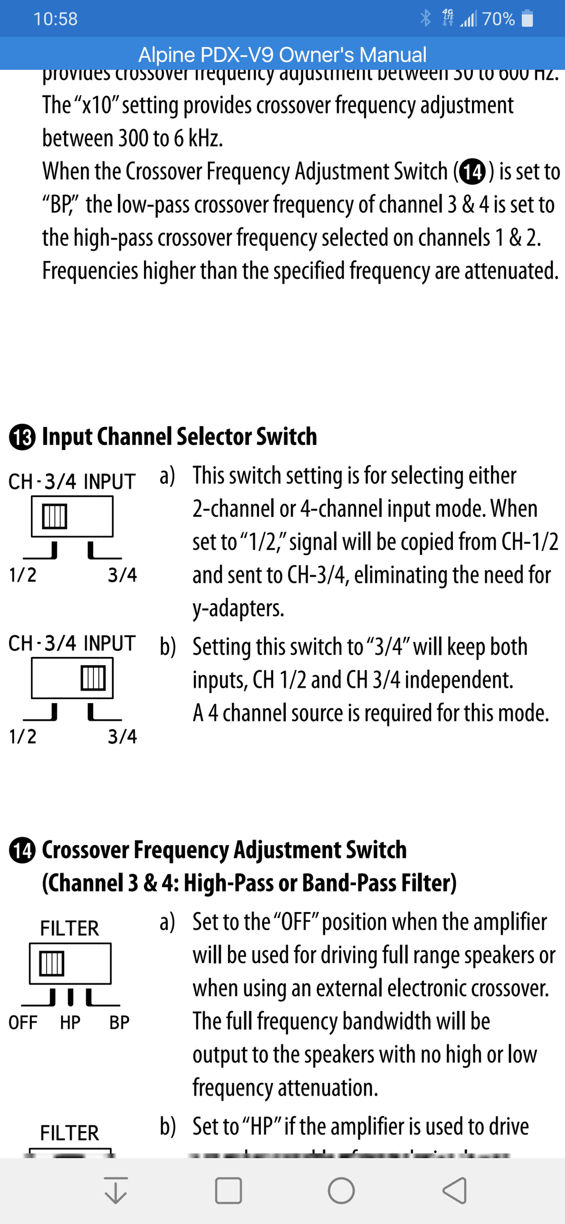

Do not remove it, do as Kickstand suggested. Just use the rear RCA outputs since they play clean. I have not used fader control since I started multi-amping. Your amp may have a 2 channel input switch. If it does, connect the RCAs into the front inputs and the amp will share the signal to the other inputs.
