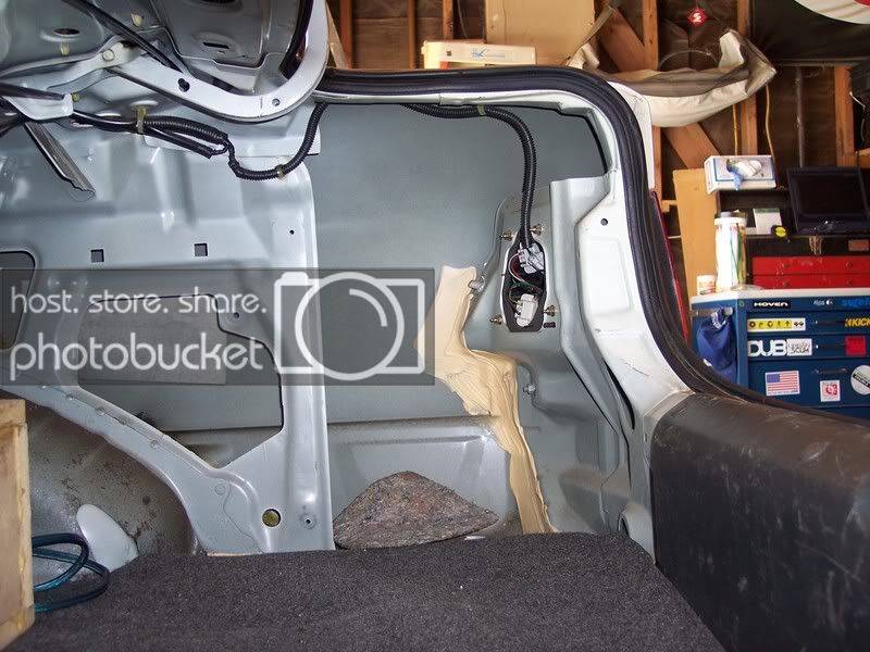

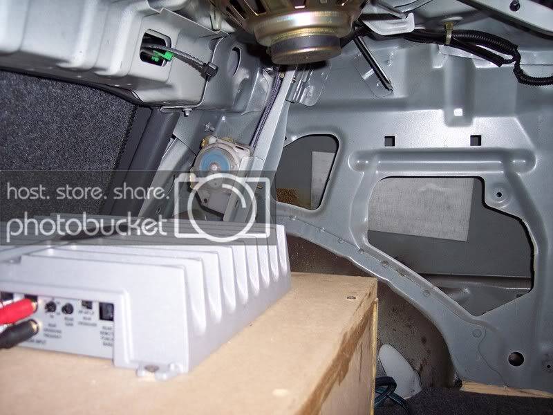

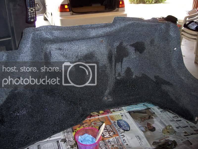

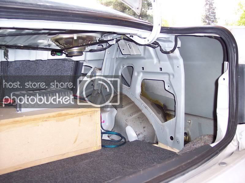

in an effort to get my trunk back i am going to glass an enclosure in passenger side of the trunk of my 97 civic coupe...i read an article on CA&E about how to use the factory trunk liner as the back of your box...just pull it out and glass it...then sand and reinforce it (basically)...
http://www.caraudiomag.com/technical/caep_0802_project_toyota_avalon_sub_enclosure/index.html
i am going to use their game plan...seeing as how i have the same kind of trunk liner in my car...this isnt my first fiberglass project...i have done tweeter pods...two boxes and a center console...but this is my own car and is going to be a permanent install...

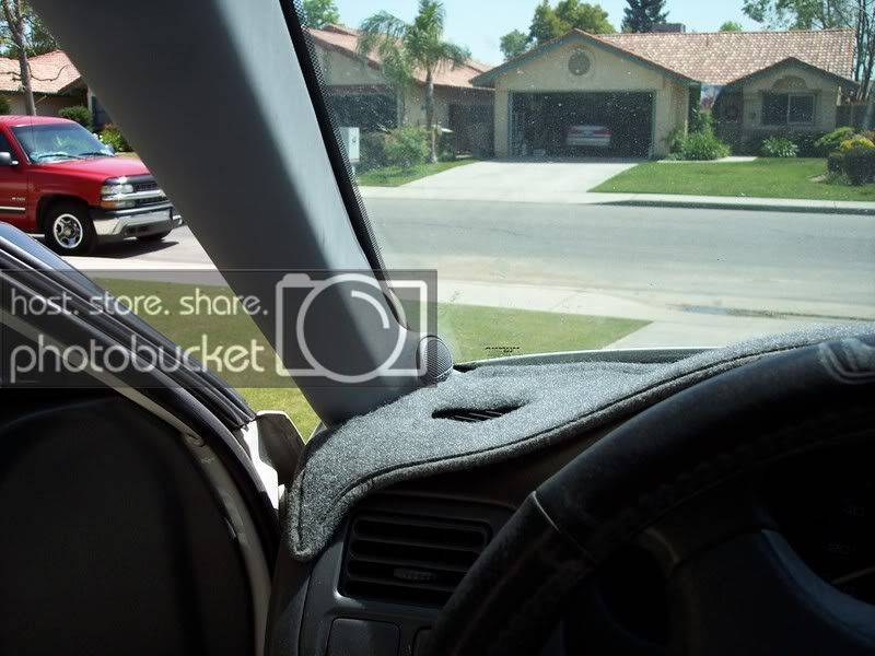

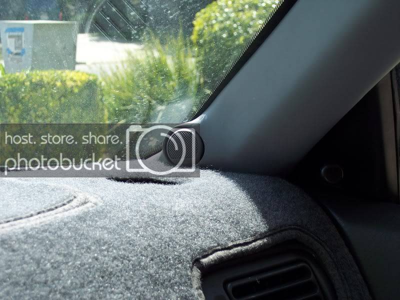

my tweeters...
i just have it....got it for free...i had a ***** of a time with it in the heat here during summers...i couldnt get the glue off the dash and had to put it back on...i tried goo gone and a few other cleaners and couldnt get the tape reside off the dash...so my dash looks likes shiz with out it on...
but...i am sure it eats some reflections...
good enough reason for me....was just wondering
also...can i fill the area behind the box with something...i know dynamat is going to happen on the flat surfaces...but there is alot of open space...polyfill? expanding foam?...yes? no? doesnt matter?...
