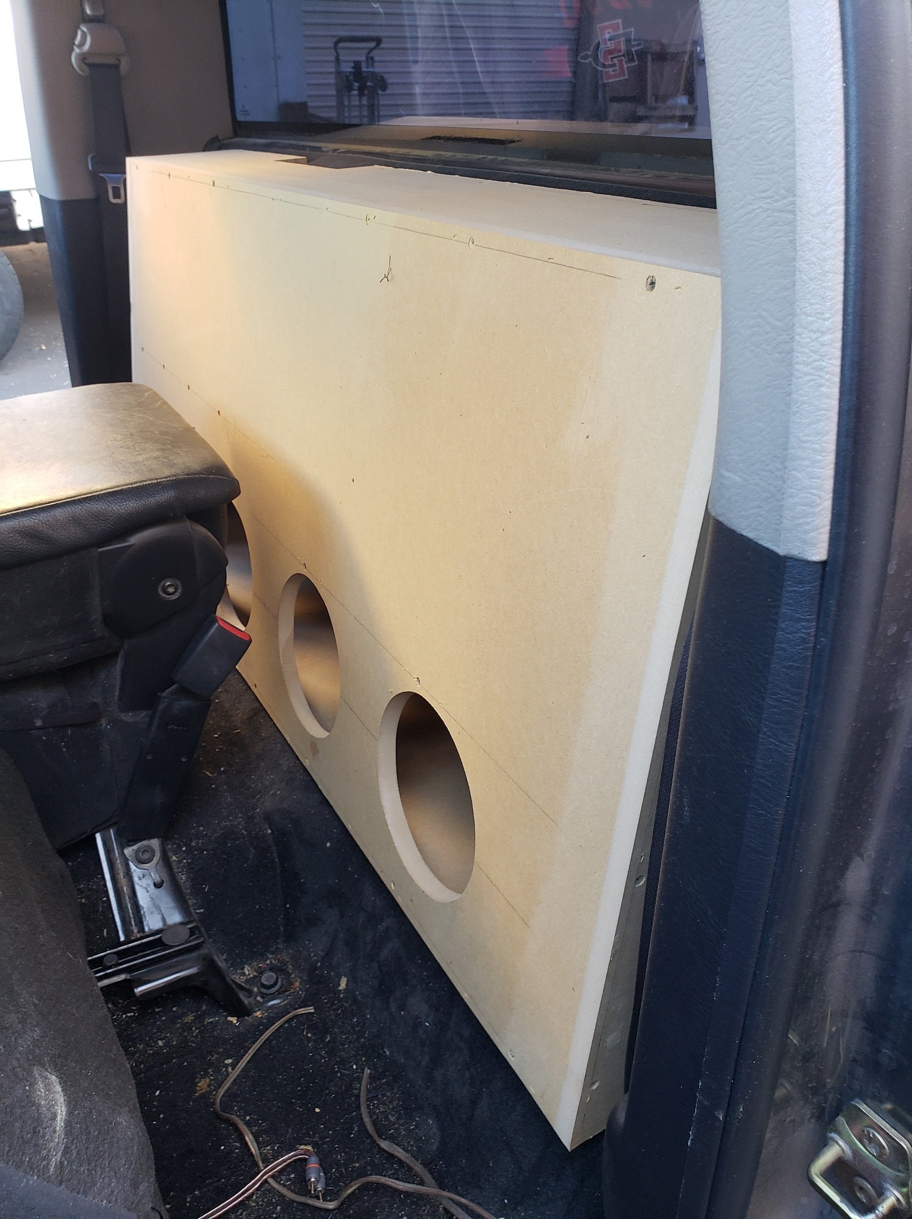

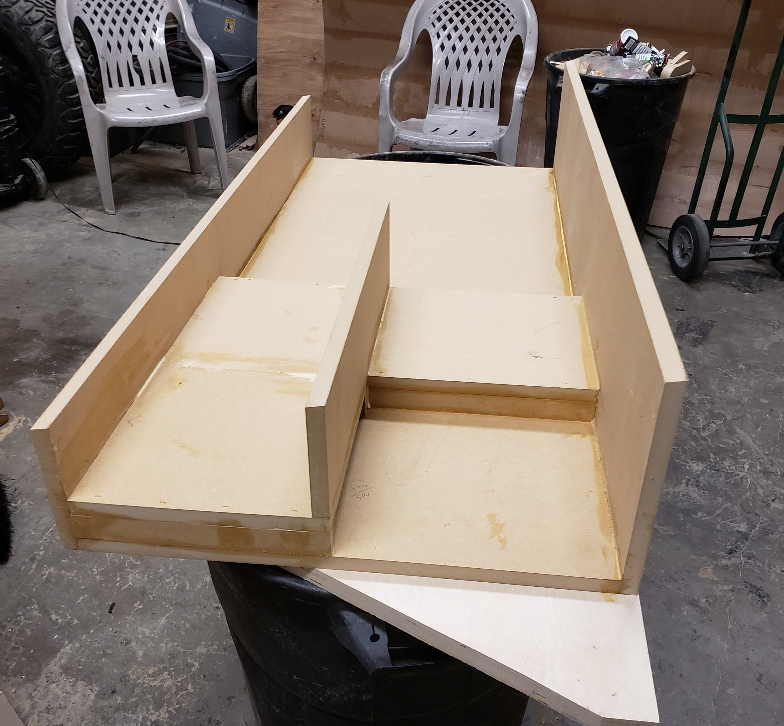

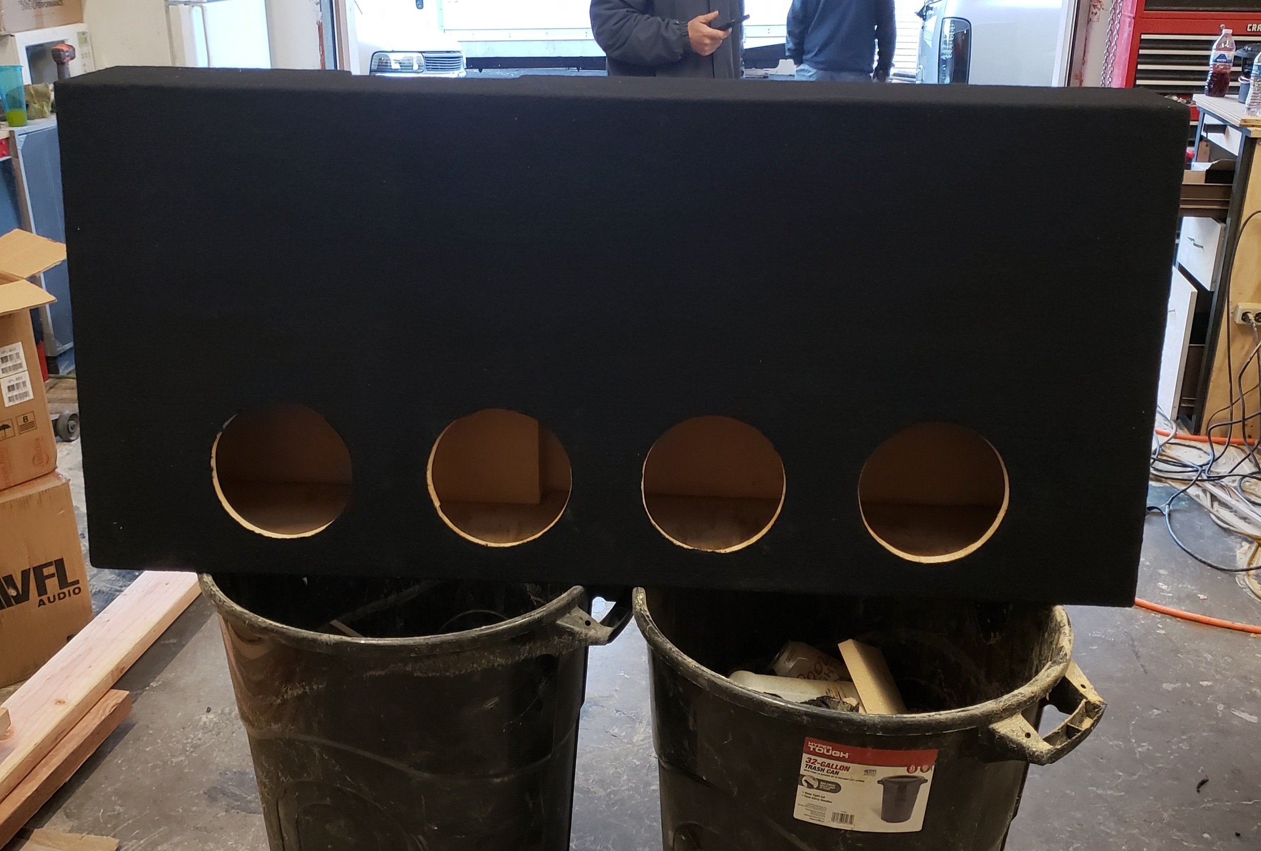

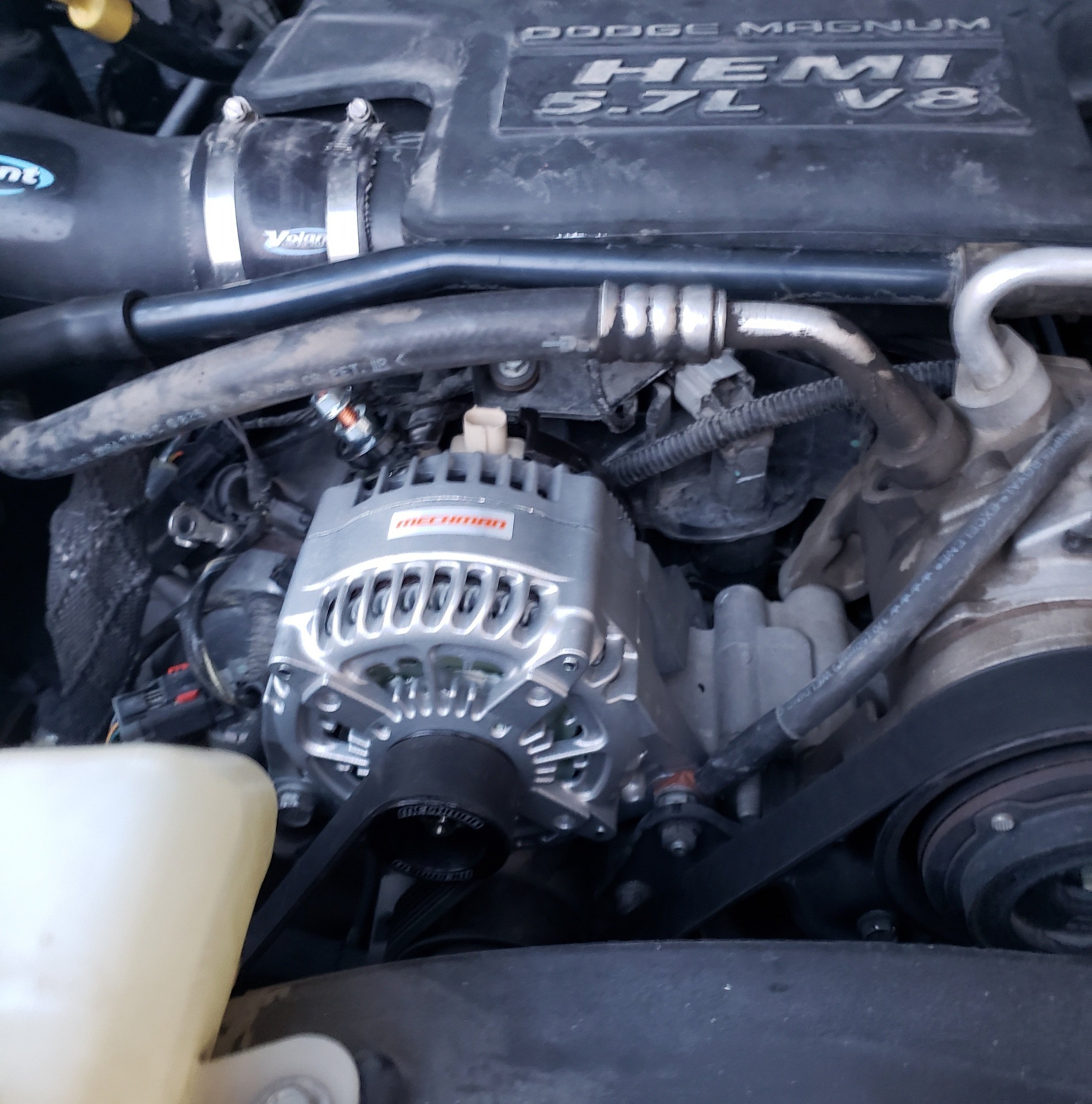

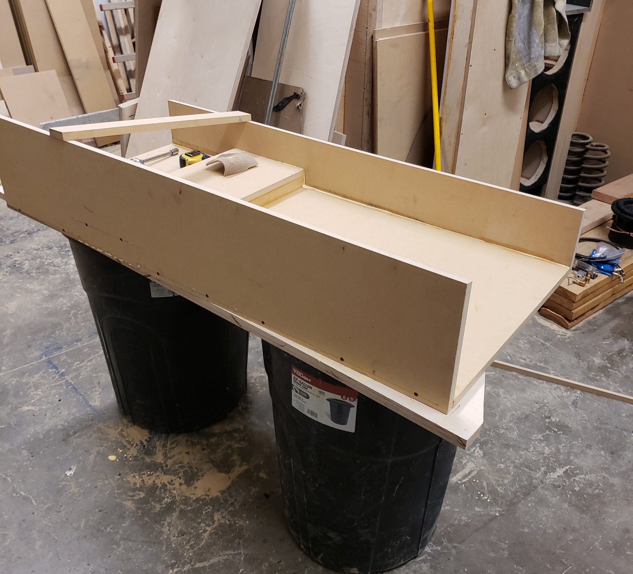

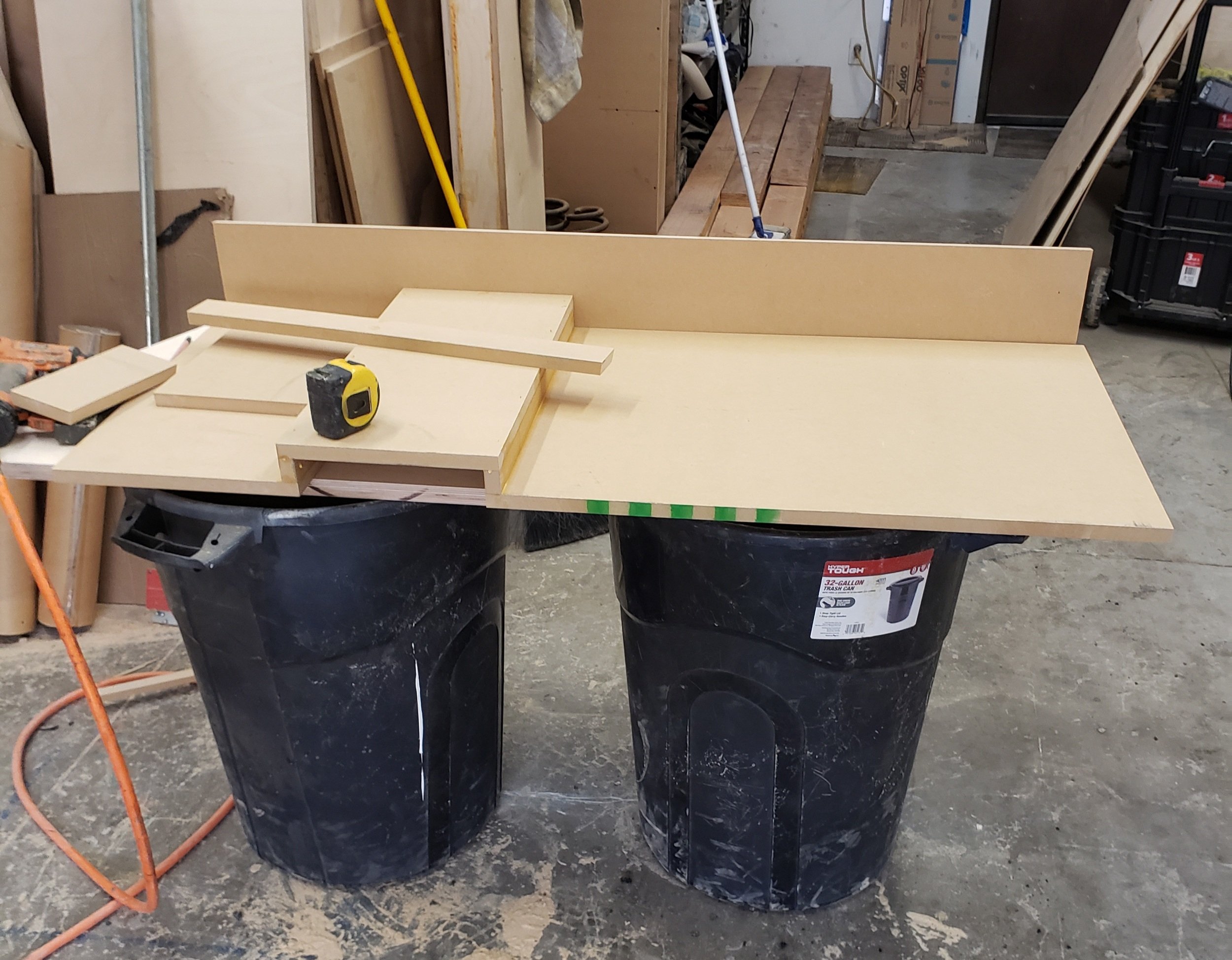

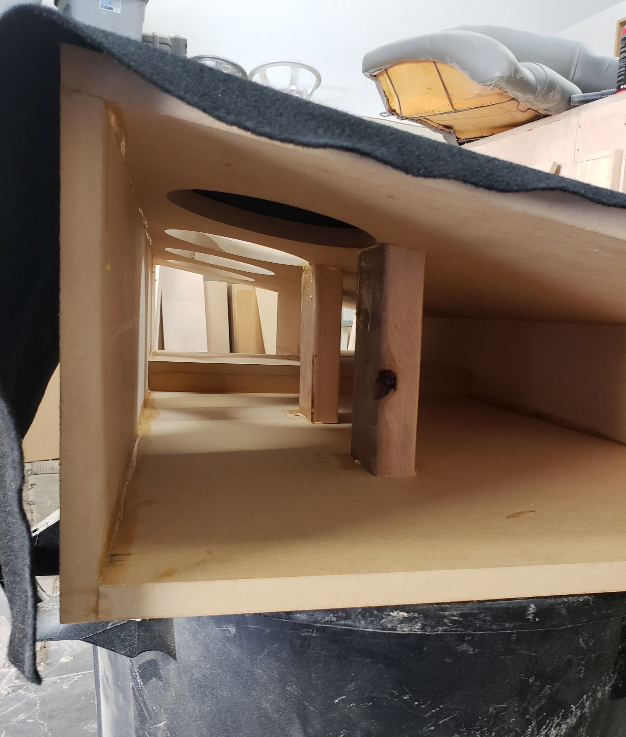

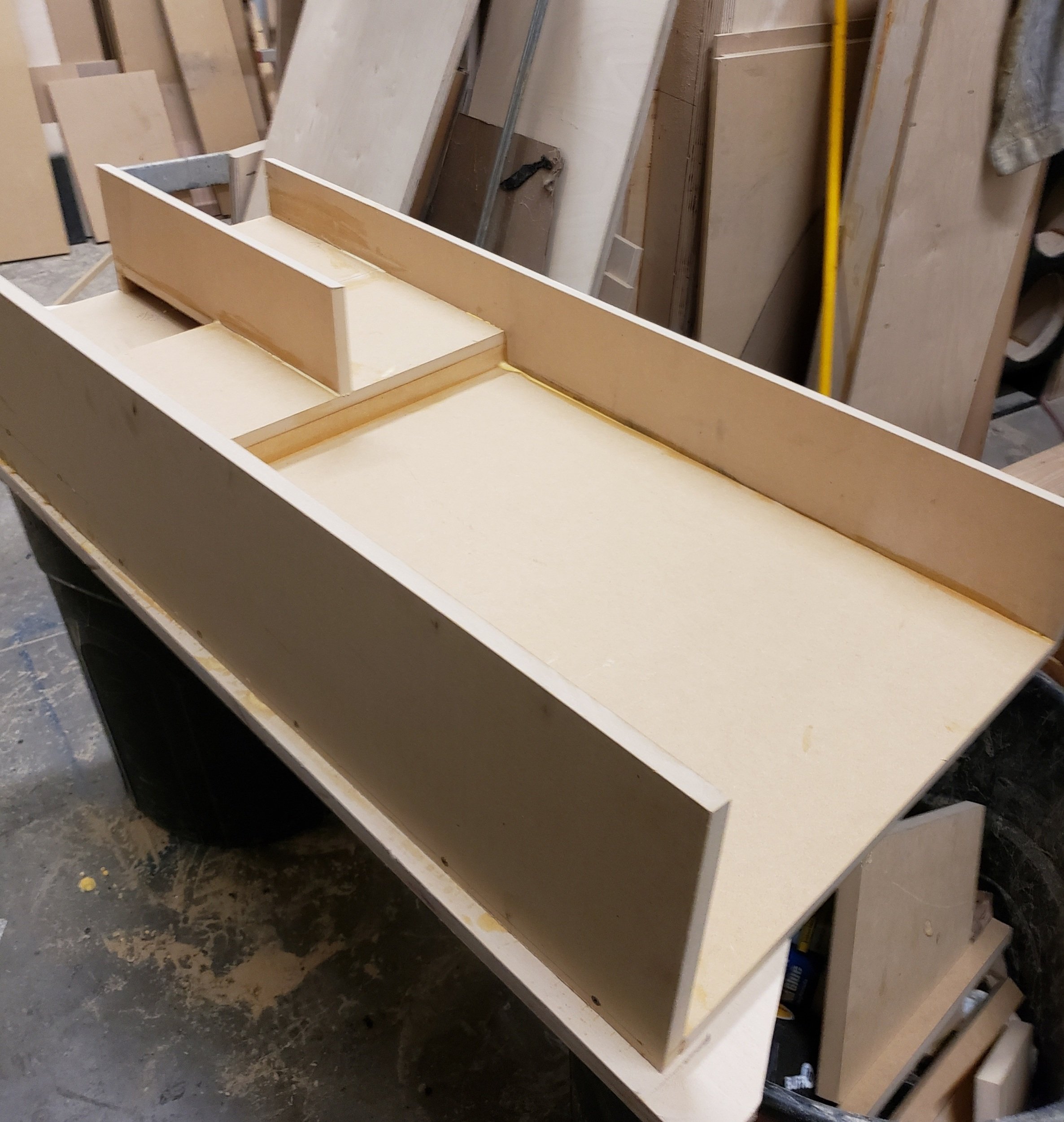

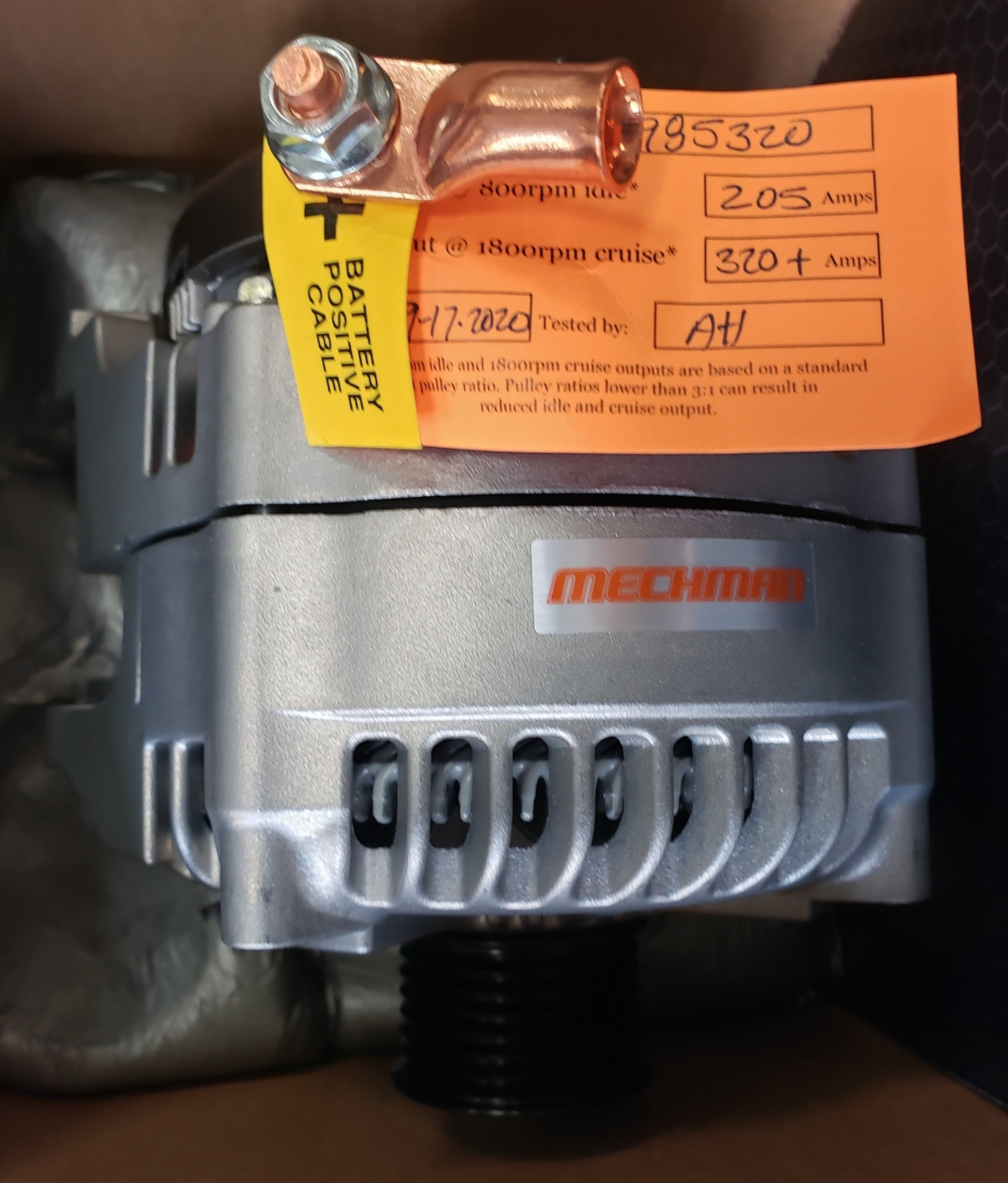

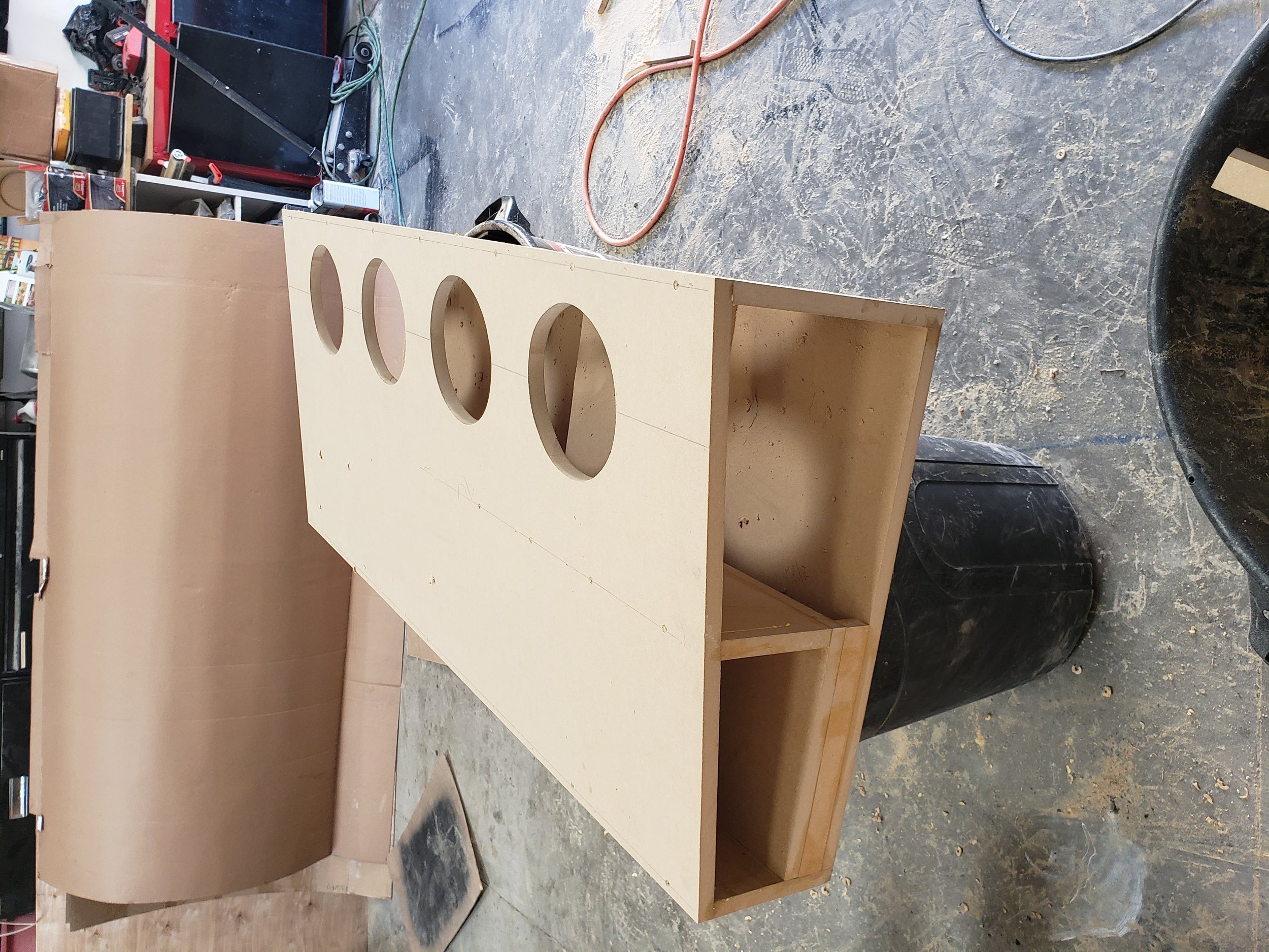

Got the alternator installed and the box started today. The box will be 4.1 cubes net after port and speaker displacement for four VFL8's tuned to 33 hz. The box is only ¾" MDF. It should work though.

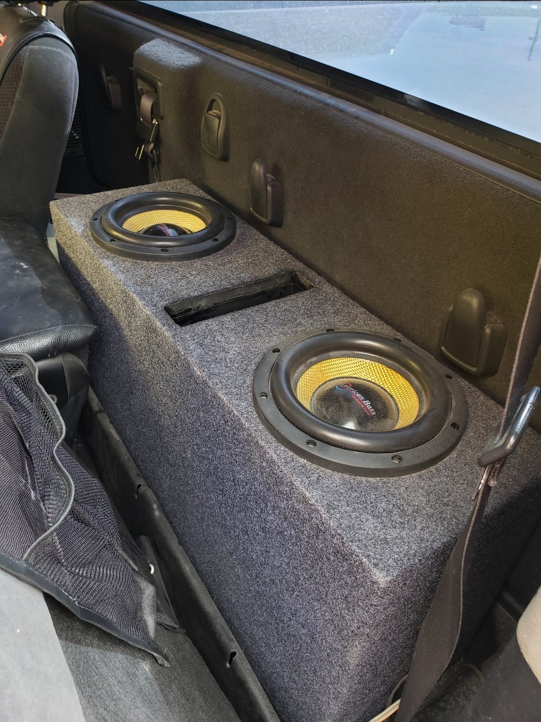

My installer took my two VFL8's, box, and a DD M.80 (900 watts @ 1 ohm) in trade. He installed them in his Audi A7. So, that paid for my new box. They sound great in his A7.

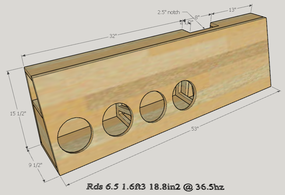

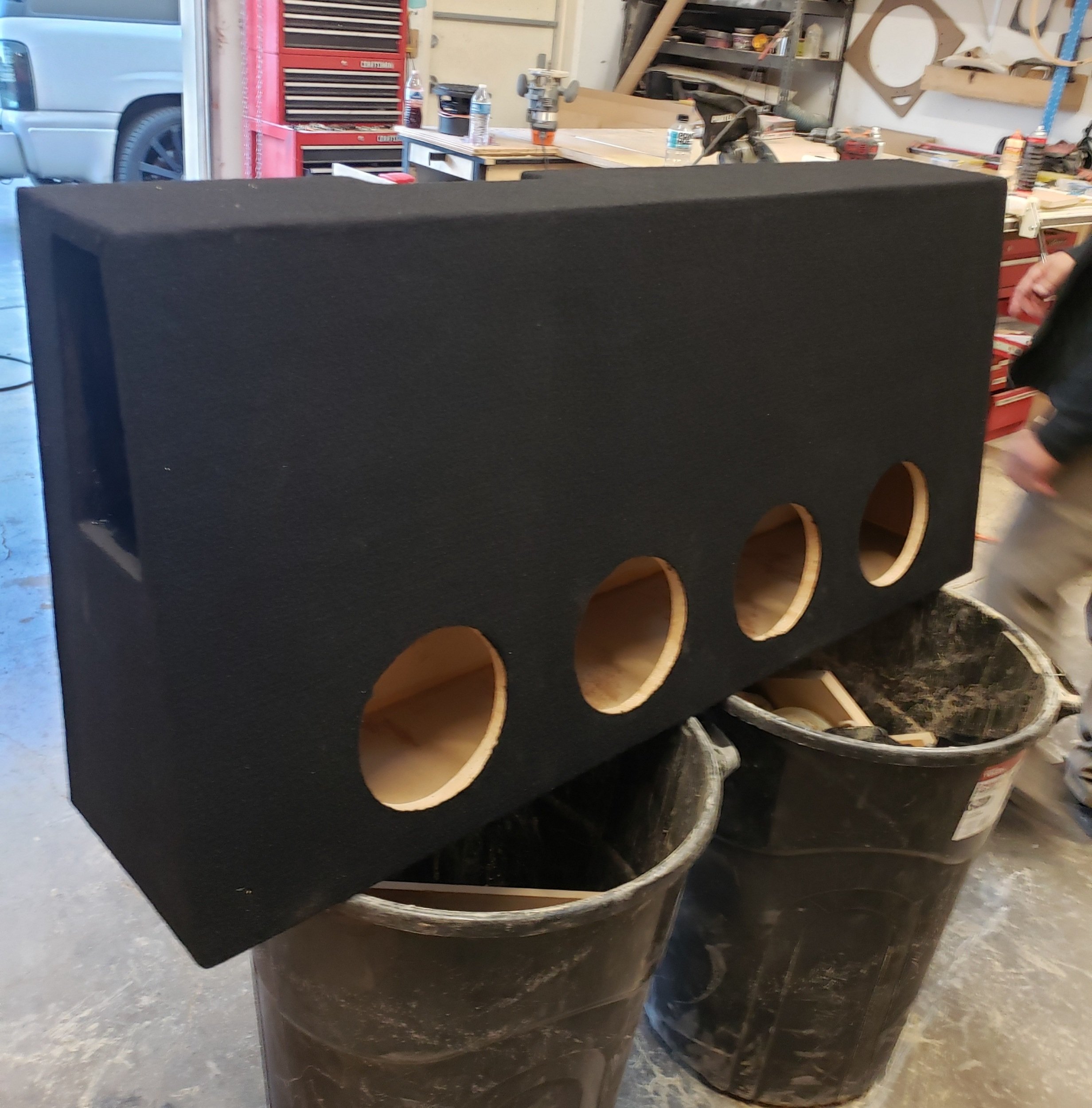

Looks good, similar to this 4 6.5" enclosure for a single cab Silverado. Even 4 6.5" get down in a small cabin if done right so I bet your 4 8's do great.
