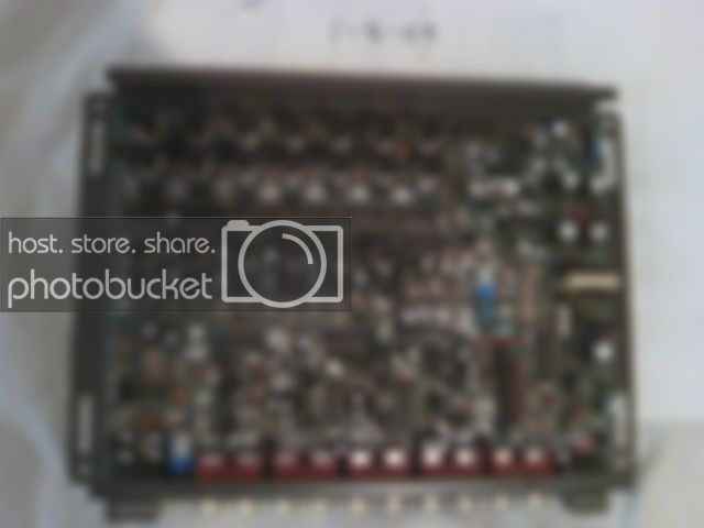

where is that located on the unit? there's a gut pic of it in my sale/trade thread
edit: here
I would have to have it in my hand, but according to the manual, the PFM module, the PFM bypass, the ground selector, and the crossover module are all right together.
My Four1 had all its labeled under there you could just see each and what they were for. Like I said, going by the manual, I would have to have it in my had to point it out.
basically the PFM sets the floor for the lowest freq that will pass thru to the amp? ya?
i'm gonna call audiocontrol anywaiz
Exactly, it acts as an SSF for the unit. Instead of being able to turn a knob to adjust it to what frequency you want, you use modules that are preset to a specific frequency that Audiocontrol sells.
