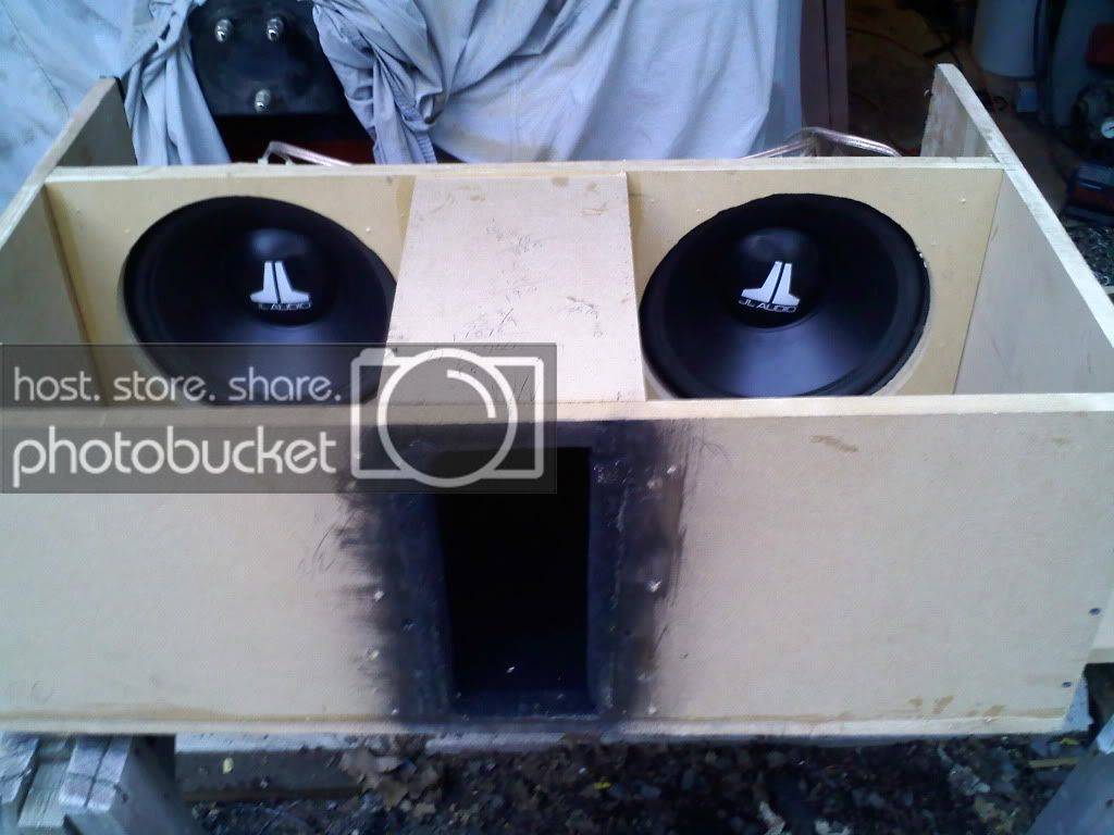

this is mine I built and designed, I will have to find my build notes, the 3:1 sounds close. the out side dim of mine is 36x30x14 the port is tuned to around 38 hz. right now I have 300 watts going to it and it pounds, I have a jbl 1400.1 (1200 @ 4 ohm )that should be in there this week so it should be quite louder LOL
Holy low tuning for a 4th.//content.invisioncic.com/y282845/emoticons/eek.gif.771b7a90cf45cabdc554ff1121c21c4a.gif I bet it anialates the lows.//content.invisioncic.com/y282845/emoticons/biggrin.gif.d71a5d36fcbab170f2364c9f2e3946cb.gif
