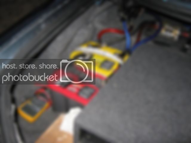

Okay here we go: see in the first pic where my meter is I had the ground going just behind the
grey carpet down on the frame (about 2ft of ground/1 run)
So what are my options: Run 2 grounds of 0ga from each battery to the frame
Run more grounds to the sheet metal
Run a ground from front batt to the back batts
"akheathen you're suggesting what"

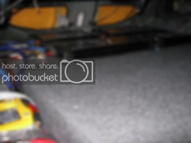

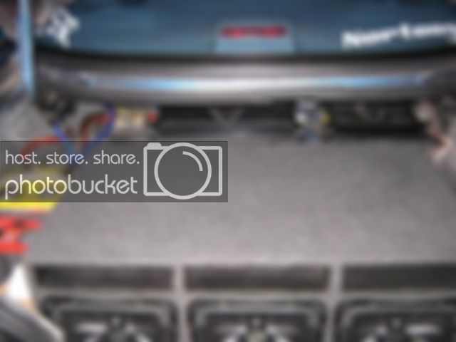

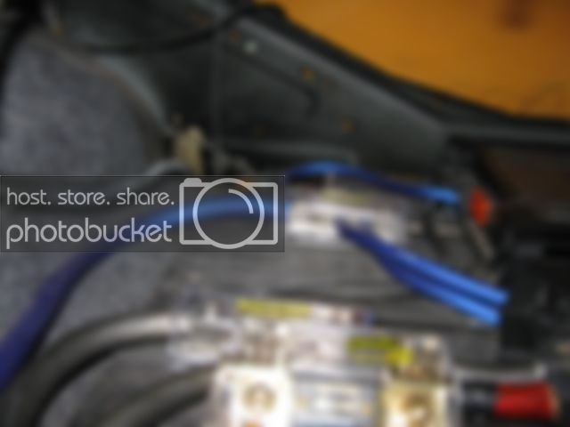

Couple pics of the system
My ground that i have now that i want to change

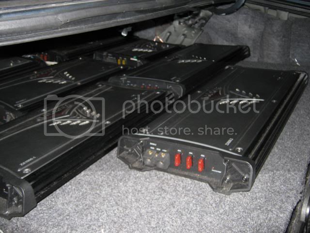

Some kicker amps thats going to replace some of the other amps. just want my grounds to be stronger first tho

Just talk with my audio guy couple days back. He told me that my big 3 wasnt right. Eventhough my back batts were grounded to the frame the front batt wasnt.....so it was like a open circuit. Thats why i had a low voltage reading of 13.52 because my front batt was still ground to the body. So when i touch the power wire to the rear batts it couldnt hold the load of the amps. Now that i understand a lil better....when i ground my front batt back to the frame along with the rear batts its gone be like 1 big ground loop. Kinda feel better bout the matter now cant wait to see if that works....but any input you guys have would be greatly apprecciated thx
yes, that is what i was trying to say. you need to have it even on both ends. the alternator and all 3 batteries need to carry power(ground) between each-other... so, if you have the rear batteries grouded to the frame, the front battery and alternator needs to get the same amount of ground to the frame....factory grounds to the frame and body just don't cut it...
