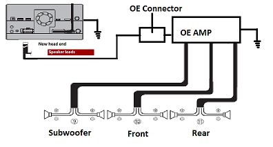

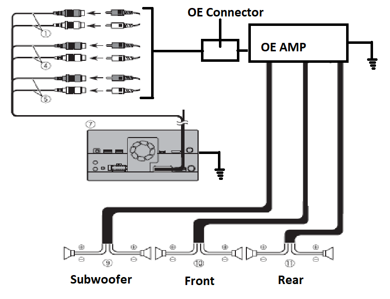

Folks I need your collective genius brains to give me some guidance.
I have a ’06 Lincoln Navigator with a bad navigation/THX audio system - sounds good when it works.
I’m replacing it with a Pioneer AVIC-W8500NEX. No one makes a harness for the Navigator’s system, but I’ve figured out the wires EXCEPT into the OE amp.
I figure I have 3 choices:
1. Run my speaker wire outputs directly into the OE amp, but maybe not so good?
21673

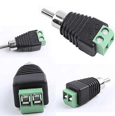

2. Use some tricky little parts from Amazon to convert the Pioneer RCA pre-amp outputs
to single wires to feed the OE amp connector.
21667
21669
3. Scrap the OE Amp and install a new 5-channel amp. This sound quick and dirty, but none of the
other audio systems will work. It's like a taking a hatchet to audio system.
I like No. 1 best cus it’s easy and cheap and everything else works in the car the way it's suppose to work. I’m afraid I may be forcing too many positively charged electrons into the factory amp. And, I'm guess impedance issues?
The other thing is the OE subwoofer has it’s own amp.
I don’t want to rewire the whole car.

Option 1 or 3 aren't bad. Stock amplifiers in car packages take a high level signal, not RCA signal. Obviously option 3 is going to be better and you'll have more control over what quality you're getting out of it, but option 1 might end up being good enough for free. Option 2 would most likely fail.
1aespinoza and Lasher2 - thanks for the suggestions/info.
1aespinoza - I'll check it out.
Lasher2 - I think that was my big question about if it required a high or low level signal to the OE amp.
BTW. on No. 2, I re-thought those hinky little connectors and bought RCA interconnect/patch cables. I cut them down to about 4 inches long and stripped back an inch to expose the 2 wires and the shields. I confirmed the + & -.
But as you mentioned about high level output to the OE amp is really important. Thanks.
