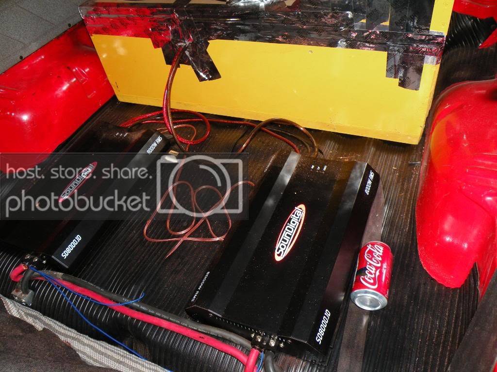

I got a pic on my street B car of some simple connections...
