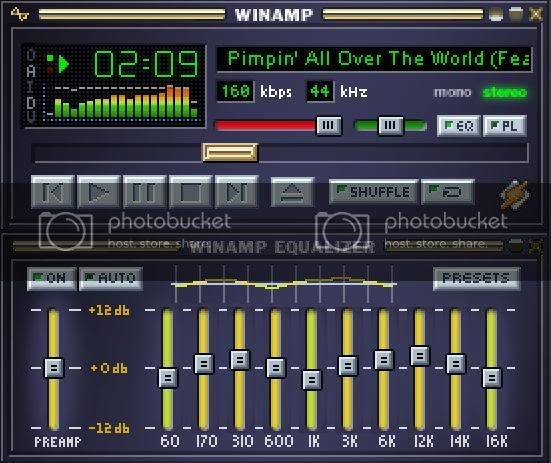

crap. did i forget to mention i dont have an RTA? the reason i made the original post was basically assuming that my car had an already-flat RTA frequency response.. but how often does that happen? well anyway, i guess i found what i was loking for kinda.. the seagull looking EQ? basically its like drawing a stick figure of a bird right? and its beak (or the middle dip) would be 1 khz? are you planning to show me a picture of your in-home equallizer REQ? i ask this because shouldnt an in-home equalizer with flat settings yield a flat RTA response? (assuming this is an empty room?)
is this an example of the seagull 37?
