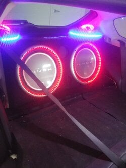

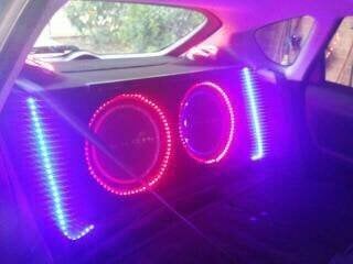

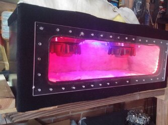

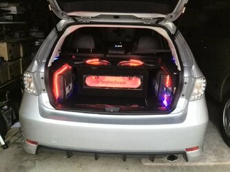

I done mine wired to the subwoofers then I put a switch in between so I can only use the lights for demo purpose off road.  Its illegal to drive with red/ blue (emergency light colours) which shows to the oncoming traffic and the cops will fine you in Australia for having them on or worst case scenario, they can defect your vehicle so you cannot drive it.  if you do intend to install them, just use a switch in between to switch them when required.
